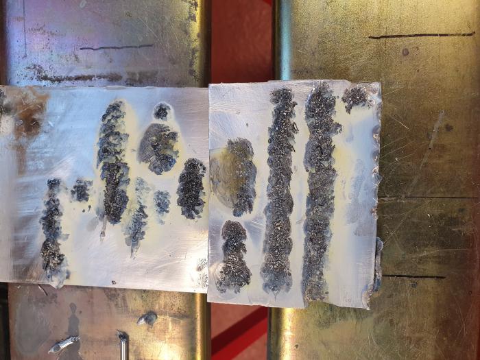

I am a beginner at welding. I have managed some ok welds in steel but cannot even get started with aluminium.
I have a basic AC/DC 200ST IGBT made by Stahlwerk
I cannot manage to strike a stable arc and get a weld pool.
I have a 2.4mm 2% Ceriated Tungsten (grey)
I have tried current ranging from 34A to 100A
I have tried balance set to zero = 70 - 30 and also at the extremes +5 & -5.
Filler is 2.4mm 4036
Argon gas at 8 l/m
Size 7 cup
Results look like this. What am I doing wrong?
Electrode starts like this
Finishes like this

How thick is the base metal, and how large are the coupons. IE surface area. Aluminum is notorious for absorbing heat. 100 amps may not have been enough.
Edit
From the pictures it looks like you may have a gas issue.

I agree... with the gas issue... that looks like a #6 cup... I would double your gas see if that helps.

Edit... you said it was #7. But I use the rule of 2 x cup size for a base.

Mac's Crew wrote:Edit... you said it was #7. But I use the rule of 2 x cup size for a base.
Sent from my SM-G960U using Tapatalk
That's when you are looking at CFH. For L/min it's roughly the same as the cup size.
OP:
Crank the machine all the way up.
You did not disclose the thickness of the base metal.
You did not disclose if it is anodized and/or the alloy.
Your tungsten is sharpened too sharp. Try a blunt 60°included angle, with a flat on the tip.
You need to find out which "way" your AC balance is calibrated. Is more on the dial more EN, or is it more EP? Once you do do find this out, you need to set it to about 65-75% EN, or equivalently 25-35% EP.
Make sure you have an actual AC arc. Do you know what that looks/sounds like?
Show us how you assembled the TIG torch. Take out all the parts and lay them out and snap a pic.
Address these issues and/or answer these questions and we'll be that much closer to help you out. :D

In a similar vein to Oscar's point about AC balance, make sure your torch is connected to the negative plug. I point this out, because, well, I've done it the other way :oops:
Your welds and tungsten looked much like mine did when I goofed my polarity with the standard 30% balance on my machine.

Bernard wrote: Argon gas at 8 l/m
Size 7 cup
not enough gas flow. try about 15l/min.
use a blunt grind on tungsten, think crayon.
reduce stick out a bit.

Thank you for the advice. There is no foot pedal with the device. The material is 2 mm thick. I am melting the material right through. I have tried 15 l/m and a 6 cup. The result is better but still not like any of the videos I have seen.
I definitely have the torch and earth cable the correct way round. The machine manual says that with the balance set to zero I should have 70% negative and 30% positive. If I turn plus I should get more positive and obviously if I go minus I get more negative but the manual does not specify by how much.

i just hope you don't keep practicing the same (wrong) way. You need to diagnose before you continue practicing. You still haven't told us if that aluminum is anodized, scrap, etc, etc. 70% DCEN sounds good, but we didn't know that at first (your equation looked 'off', lol). Lots of little things that all add up. :)

Hi, guessing you have the problem sorted by now but just thought I’d put my 5 cents in. Looking at the photo, is the torch connected to the correct port? I just wondered if where you have it connected is for mma stick welding and that maybe the torch should be connected to the - port next to it? I do most of my aluminium welding with a 5 cup and the argon set at about 12l/m and seems to work fine for me. Advice I remember from Jodys videos, clean, clean, clean wipe your rods and the aluminium edges you’re going to weld with acetone or similar as this makes quite a difference to your weld pool.
