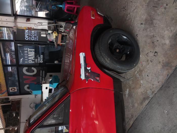

I'll mostly be repairing rusted sheetmetal on my 1978 Datsun pickup.

cwby
    Wed Nov 13, 2019 7:07 pm
OH! NO! A man with a gun on his truck! Drive by!
Gunhappy
    Sat Mar 07, 2020 9:36 am
cwby wrote:OH! NO! A man with a gun on his truck! Drive by!
Go read my intro in the Introduction area and you'll understand. :mrgreen:
