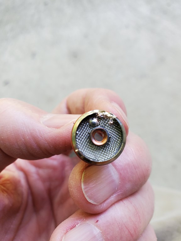

Seven years ago I purchased a new Miller Diversion 180 TIG welder. I got it set up; but, I never even plugged it in. This year I made learning (or attempting to learn) TIG a priority. This weekend I got everything together with the intention of baby steps.
Saturday I applied power to the machine. No issues and no real concerns. I tested the torch setup and everything looked good.

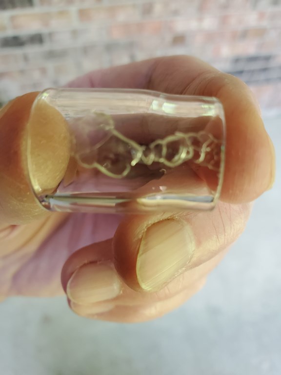

I had received a CK Worldwide 17 series torch as a gift soon after I bought the welder. Because the original Miller torch and cable assembly is so bulky compared to the CK I decided to change out the torch before moving forward. I did that yesterday. I used the CK cable extender with insulator after removing the Miller/Weldcraft torch. I had previously bought Jody's gas saver lens kit with the #8 Pyrex cup for the 17 series torch. I installed it on the CK torch this morning. I am using a StrongHands table to try to get comfortable practicing on. (Hopefully I haven't left out any steps that are important.)
The six pictures in this message show what happened next. (Sorry that they are out of order a little.) I was using the torch on a coupon. I wasn't using any filler metal. I just wanted to get comfortable with holding the torch, watching the arc at the tungsten point, and running some beads without adding filler metal. The first bead I ran wasn't really heating the coupon well. I thought it was perhaps that I wasn't using the pedal correctly. On the second pass, when I got to the edge of the coupon, it got very hot and then the arc jumped from the coupon to the table top. As I let off the pedal something happened that I didn't expect.
Two of the pictures show the trail of steel that ran from cup edge to the lower part of the gas saver collet body. Two other pictures show the body after a majority of the track was removed from the body and outer-most screen. One picture shows the inside of the Pyrex cup after cleaning. And, the last shows the coupon with the blowout at the end.
I could use any advice you guys could offer. I am wounder if the main problem was that I wasn't getting sufficient ground between the table top and the coupon. If the coupon wasn't ground sufficiently and the puddle was still molten when I turned off the torch, would it track back to ground through the torch handle in that fashion?
A few specific questions:
1. Considering there is a small divot on the side of the gas lens collet body, is that piece trashed? (Will the few small droplets on the screen affect its use? (I know that I probably should have stuck with standard consumables until I got past this stage.)
2. Is the Pyrex cup safe to use, or should it be disposed of? (I'm not sure how they fail.)
3. I thought the Pyrex cup would be good for learning. Maybe that wasn't good thinking. Any thoughts?

- Pyrex Cup After Metal Tracking
- 20200525_121220 1024x768.jpg (47.21 KiB) Viewed 1231510 times
- Side View After Tail Removed from Collet Body
- 20200525_115925 1024x768.jpg (53.69 KiB) Viewed 1231510 times

- Screen After Tail Removed from Housing
- 20200525_115912 1024x768.jpg (54.32 KiB) Viewed 1231510 times

It would appear that way, but what matters is that it functions, allows gas to flow through the lens, holds the tungsten properly and allows a cup to attach to the threads. The cup should seal around the spacer or on the o-ring for a pyrex, I would ditch the pyrex until you learn more.Jeff2016 wrote:1. Considering there is a small divot on the side of the gas lens collet body, is that piece trashed?
That one looks like toast. From the best I can tell you have ruined a designer class torch cup.Jeff2016 wrote:2. Is the Pyrex cup safe to use, or should it be disposed of? (I'm not sure how they fail.)
No, they are fragile and expensive.Jeff2016 wrote:3. I thought the Pyrex cup would be good for learning.

Looking again, that gas lens is toast, toss it out and use a new one. Hopefully you have another gas lens. Use a standard pink alumina cup. No reason to get fancy. I use a 3rd hand to place the ground on the work, but also use a steel welding table. It's not an expensive one, but you need a way to conduct the ground to the work. If you can attach your ground to the table and have the work in contact with the table, that works well, but connecting your ground to the work itself is always safest and best.

I was looking over the pictures of the gas lens and will admit, I never had one do that, but have had the pyrex break,,,at my age, I can drop things ( I do have several years on you ) but enjoying the heck out of tig welding. I used to be nervous and jerky, no longer nervous.

That's strange, indeed! Never seen it before.
Arc welding creates magnetic currents in and around the work (often very noticeable when stick welding, but less noticeable in TIG unless the right circumstances are present). Perhaps you had some sort of one-in-a-million, freaky, super-strong magnetic current that formed right in that area and sucked all the molten weld metal up into the cup like that at just the right moment. Just guessing, but can't think of what else might have caused it.

Yup it's trashed. Toss it, start over with a standard 7 or 8 alumina cup. Short stick out 1/8", short arc length 1/8", very little torch angle as was mentioned.

By the looks of his coupon the metal could have come from the end where he blew it apart. But thinking about this makes me wonder about the gas connections and/or if some type of venturi is being causes that is sucking that blown apart metal back into the lens? I would definitely go over all the gas connections on the hoses which are connected to the torch, making sure the gas lens is installed and seating properly, the collet and back cap, even on the machine where the gas hose connects to the dinse connector. If anything is sucking air it will likely prevent the gas from getting to the work.
Even stranger is how the side of the gas lens would get molten metal on it? If the cup was in place properly how would anything get on the side of the gas lens?

Regarding the Pyrex cup, the deformities on the inside of the cup were were the molten metal trailed its way inside the lens to the collet body.

If that's the case the cup might be ok to use. As long as it's not broken it should be fine.Jeff2016 wrote:Regarding the Pyrex cup, the deformities on the inside of the cup were were the molten metal trailed its way inside the lens to the collet body.
Check all your gas connections and fittings to be safe though, it was odd how the molten metal was sucked up to the side of the gas lens, it's possible the gas lens was not seated properly. Just make sure everything is seated and snugged properly, just finger tight things not gorilla tight. Standard slotted collets will twist and smash easily. DAMHIKT

You can't use that tungsten again until it is cleaned and sharpened. Do not even try.Jeff2016 wrote:This is the condition it was in immediately following the splattering.
I will suggest you check out gas connections and fittings again to figure out why the molten metal was being sucked into the side of the gas lens like it was.

I wouldn't spend too much time trying to figure out what happened. My guess is you had a large puddle, dipped the electrode and it stuck, then you jerked as a reflex action. Some of the puddle was still molten and splashed up on the cup. It all happened so fast that you didn't think about it. I don't think there was any mysterious force sucking it up. Also it would take a lot of vacuuming force to lift molten metal into a cup.
As for the longer stickout for beginners..... experienced welders can tell what is going on in the puddle just by seeing the edge of it. Newbies don't have that skill, so they need to see more of the puddle to understand what is happening. That makes them want to lift the cup and/or tilt it more. That guarantees a long arc, unless they have enough stickout. The short arc is mandatory for good puddle control, minimum tilt is required for good penetration. The slightly higher cup to work distance, will reduce the gas coverage, but should still be enough for mild steel or aluminum practice.
The main point is this...... A short stickout, and newbie eyes, will result in a long arc. Give them the longer stickout in the beginning. It is less likely to cause the bad habit of long arcing. Reducing the stickout as they gain experience about the puddle, should come naturally as they try to improve bead appearance.
