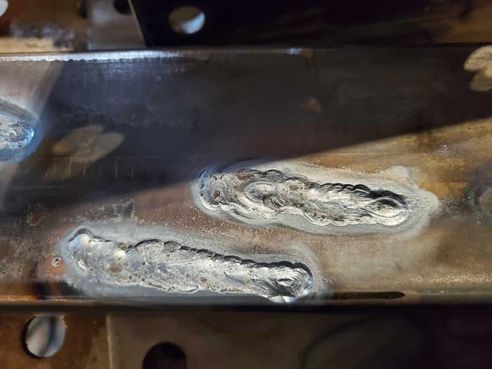

using 1/16th filler on a piece of 1/8th. What am I doing wrong?

Likely too long arc length and/or excessive torch angle. What is your actual arc length from the tip of the tungsten to the work? What angle are you using? How far is the stickout of the tungsten from the edge of the cup? Remember, no guessing! Actual factual numbers tell the truth.

first thing is to follow the 3 c's of tig welding, clean clean clean !
you have to get all the mill scale off and be down to bright shiny metal.

Run a couple of beads without any filler. Let us see what that looks like.

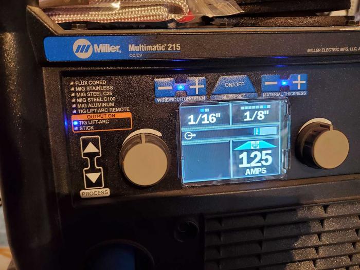

Just to confirm..... you have the torch in the - port, and the ground clamp is in the + port?
It might be from a long arc, but that isn't the first thing that comes to mind when looking at your first picture. What is the material?

12 is probably not enough flow for the furick cup but I'm not sure it would make the weld look quite as bad as yours without a good bit of contamination on the base part. Which it does appear you've got a fair amount of dirt on there yet.
Aluminum is very unforgiving when the part is dirty. It's always hard to tell in a photo but your part does appear to have a tremendous amount of Gunk on it. I mean it shows up brown in the picture.

As per his picture, that is a MM 215 which is limited to DC for Tig welding. It won't work for doing Aluminum in TIG mode. It can do Aluminum in MIG mode if set up correctly.
After looking again at his first picture, I can see what looks like etching around the weld. I would say it looks more like attempted Tig on Aluminum using DCEP.
So OP, what is that material?

If that material is 1/4” you have the machine set for 1/8”. Remove auto set and crank the amps to 160 and try again.
If the glass cup you are using is a #8, bump the CFH to 20. If it’s the large #12 Fupa cup, bump it to 25 CFH.
I know this machine well and have its predecessor. Works a treat.

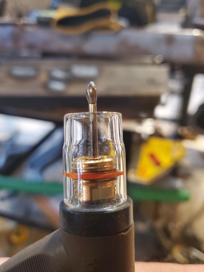

You can reduce your gas a fair bit. Gauge shows 25CFH which is way too high for a #8 cup. A picture please of the tungsten installed in the cup? Focused on the stick out length and taper of the tip

2nd try, sharpened the tungsten, CFH at 20 1/2" stickout

That looks like too much stickout.
cj737
    Thu Sep 29, 2016 8:59 am
VA-Sawyer wrote:That looks like too much stickout.
1/2"on a #8 cup is within tolerance.
The grind of the tungsten looks dodgy.
Coot - Are you using a pedal or fixed amperage?

I'm using a pedal. using a bench grinder on the tungsten. I read or saw a video on sharpening tungsten and that was one of the better ways suggested iirc.
