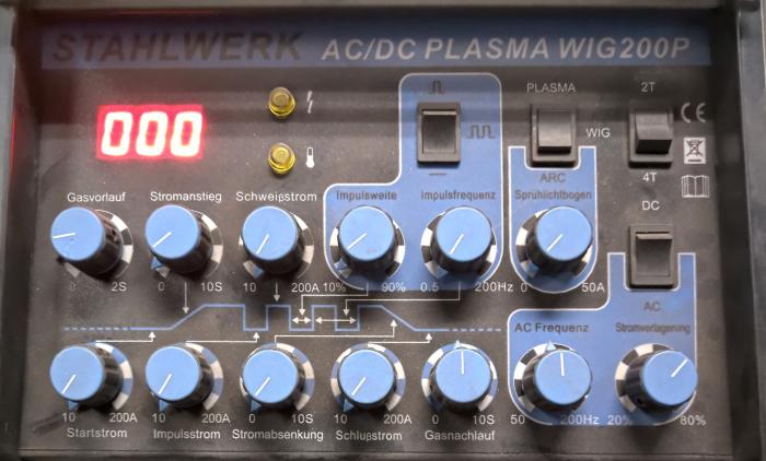

This is the machine setup, upper row first knob is gas pre flow(set to approximately 0,5s), lower row fifth knob is gas post flow(set to approximately 5s), lower row sixth and seventh knobs are AC frequency and cleaning effect. Gas flow from the regulator is set to 17cfh.

I might be wrong, but the weld looks to me like the A/C Balance is out of wack.... aka backwards.
Bottom right knob (in pic)..... currently set to ~70% suggesting about 70% cleaning action or DCEP=70% DCEN=30%.
I'd suggest flip / flop the knob to 30% or DCEP=30% DCEN=70% and continue troubleshooting from there.

sportster wrote:I might be wrong, but the weld looks to me like the A/C Balance is out of wack.... aka backwards.
You are correct, usually i have AC balance around 30% , i took that picture when i was troubleshooting that issue
