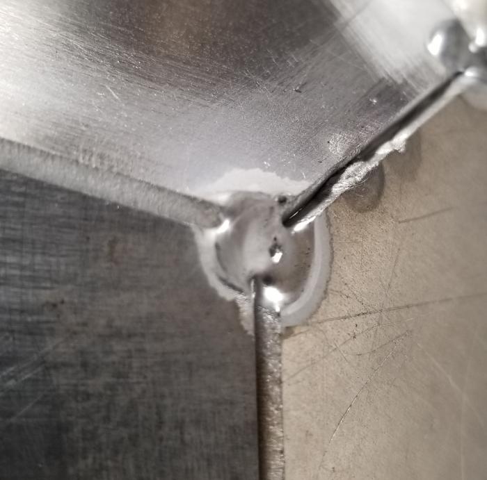

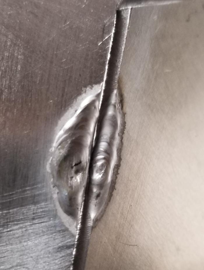

Hobbyist welder here. Been doing stainless/carbon steel for a while, moving into aluminum.
Having some trouble on outside and inside corner welds, getting the puddles from the two parts to come together as one. Especially when trying to do an autogenous tack, but also when using filler.
Like this mess here, for example. I could not for the life of me get the two sides of that weld to come together.
But sometimes I have no problem at all and can make nice tacks on outside corners like this:
Which is almost as frustrating, because I'm not sure what I did differently to make it work so easily.
Once I get things started, I can run a reasonably nice weld (I mean, ignoring the tip dip and getting too hot at the end--at least I know how to fix those things :oops: )
TIA for any suggestions. I've tried searching here and on YouTube, but I haven't come up with the right combination of search terms.
Setup:
1/8" Al, wire brushed and acetone.
2018 AHP AlphaTIG 200
#5 standard cup. 3/32 2% lanthanated tungsten. 125amps. 120hz. 35% balance. Foot pedal. 12-13 CFH argon.

I would crank your amps up a bit more (130-140), hit the pedal hard to start your puddle, and then back off the amps with the foot pedal as needed. What your describing is pretty common issue with aluminum. The way I was taught was hit it with a lot of amps to start, make sure a puddle forms on both sides. If not redirect the heat and actually make two puddles if you have to, then stab the filler in from the side to bridge the two puddles. I am sure this is one of many ways to skin the cat, but it was the I learned. They guys over at Weldingweb used to run an in person TIG clinic, and I was invited to attend some number of years (decades?) ago. Met some awesome welders who do amazing stuff with really old, refrigerator sized, antique welders.

For a fillet weld like that, you're probably right on the edge as Louie suggested. No two machines are the same, and they will vary with input power slightly as well...so even comparing settings isn't exact. Just dropping the balance to 30% cleaning might be enough to help get the puddle started, but higher amps is just as easy of a fix.

More amps. The corner in the 2nd pic takes less amps than the outside corner edges in the 2nd pic which is why you probably had more success with it. More amps, don't baby the pedal. React fast and dip the filler in as soon as the puddle is ready to accept it. Not easy, takes practice. That's how I taught myself after way too many curled edges.

tho if you have a large gap then it pays to dab and build up the bottom side first. then melt, dab and flow the top down to the bottom. once its bridges then hit it with big amps to sink it in and push the puddle along. back it off and weld as normal.

A lot of good advice in these replies. I do mostly aluminum and love it. The first thing I would do in your place is lower the frequency to 100. I find that helps on outside corners.

I agree with the responses above suggesting more amps. The only thing that hasn’t been addressed is your fusion tacks. Your going to need a bunch more amps for those. Like double what you would weld with. Or in your case turn the machine all the way up and get on the pedal full and right back off of it. I had all the same problems as you when beginning to TIG weld. You’re really close to getting everything just right from the looks of things. Just up your amps on everything a little and practice practice practice. Don’t be afraid to try different things, sure some of it isn’t going to work but you’ll learn from it. Another thing that took me a minute to figure out is why when I welded on a coupon for a while things changed. Well, yeah the temperature of the metal makes a difference. Hope this helps someone

I mostly agree with everything above...
I like your 35%, but I might even try 40. Might also try 60hz.
I'd also sharpen the tungsten a little more and get it in tighter. Maybe touch off the part, back off EVER so slightly, and then hit the pedal and start the arc. In close is gonna work way better than trying to long arc, which might not be the correct term for what you're doing, but I'd say your arc is too long. Getting in so close does take some practice.
You might also set the tungsten up with the cup touching the part, get the distance perfect with the cup touching, then leave it there and strike the arc. Now keep in mind, in the real world of aluminum welding, there's applications where the cup touching the part is a serious no-no. Like, failed inspection no-no. That's not going to apply to you here, but after you get the hang of this better, get away from touching the part. try using it as a crutch for now, then slowly eliminate it.
Might also take a good look at your ground clamp. Is it a good quality clamp, and are you getting a good ground? If it's a chintsy clamp, maybe lock it down with a welding clamp or vise grips so it makes better contact. Same goes for your parts. They need good conductivity to the work lead. Otherwise, the arc will tend to wander. Makes inside corners especially difficult.

I had been having a lot of trouble with blowing through the parts at higher amps when trying to tack, so I assumed I was applying too much heat, which is how I ended up back at 125.
I'm guessing that I'm just not experienced enough to keep up with how fast things are happening. Just knowing what to practice is super helpful.
BugHunter wrote:I'd also sharpen the tungsten a little more and get it in tighter. Maybe touch off the part, back off EVER so slightly, and then hit the pedal and start the arc.
Now that you mention it, the successful autogenous tack I showed was when I got the tungsten down as deep in the valley of the two pieces that I could. I'll keep it in mind, as well as the ground for the parts.

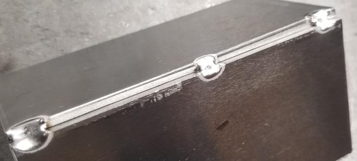

Thank you so much for the advice. I cranked the amps to 200, concentrated on a tight arc, and the results were absolutely night-and-day. These are without filler:
Tacks
Tacks
At 140A, I was able to run a pretty nice bead. Still have to work on my lead in/out, but this is huge progress.
