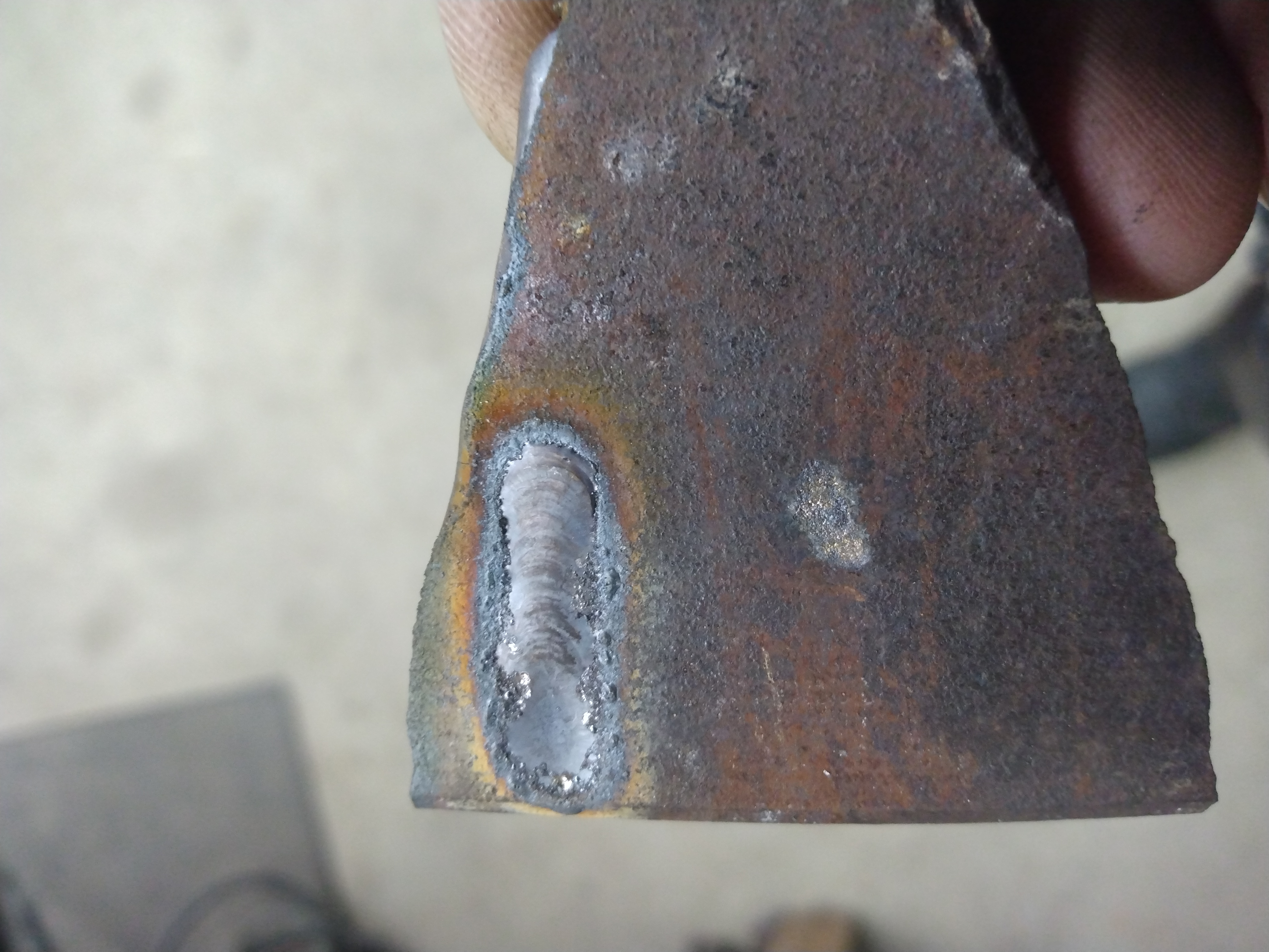

I've had decent luck stick welding cast with nickel and even stainless rod. Probable the flux helped with any "garbage". Actually welded another part of this same machine with stainless and it has held for several years.sbaker56 wrote: ↑Mon Nov 15, 2021 6:34 pm Yeah, brazing without melting the cast is the safe bet, that being said, I've welded a little bit of cast successfully myself, and my advice is to clean the HELL out of it, soak it in simple green overnight, then soak it in citric acid and scrub it down to bright shiny metal, then repeat both processes again if needed. Once you've got it as clean as you can, if you're actually going to weld it, you really kind of have to let the garbage boil out by blasting it with heat then adding in clean filler, I've had the best luck with ER312 and ER309l
When I tried the nickel rod on this part it turned into a total mess. Bummer too, that rod was expensive!

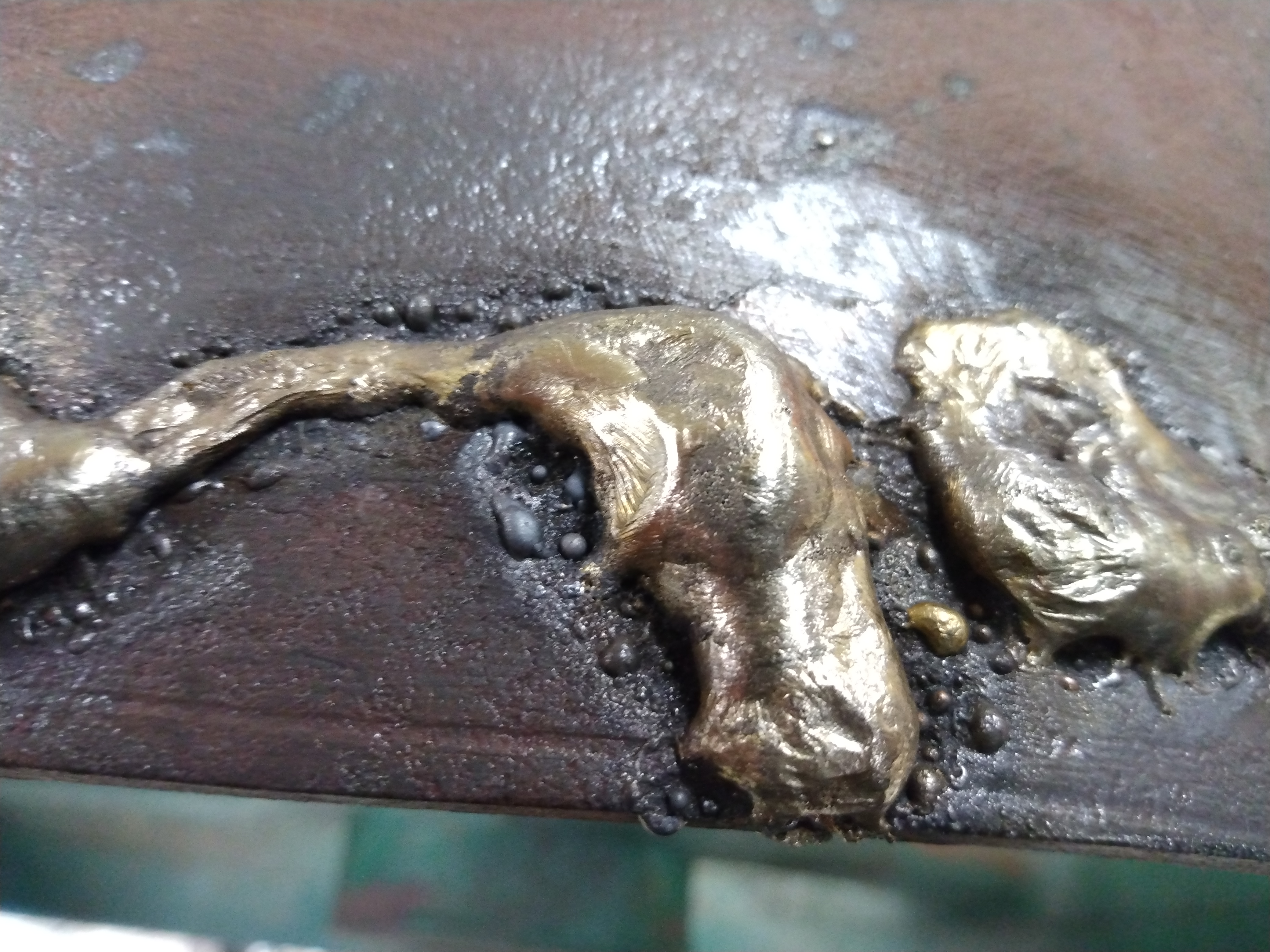

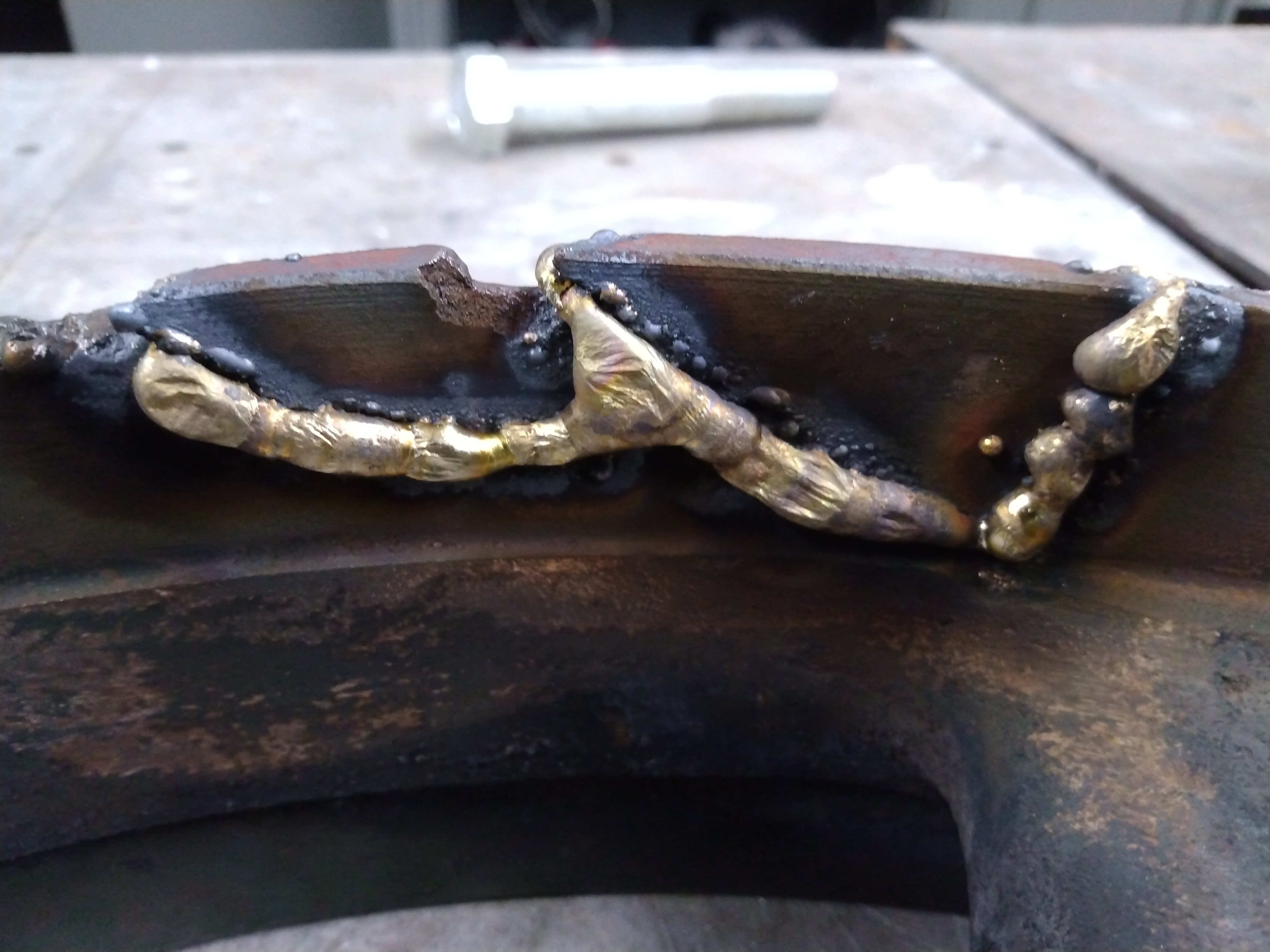

Well today I finally got a chance to try the AlBr filler. Got to admit my tail is between my legs. After grinding it doesn't look quite so bad, but before grinding it was hideous. Couldn't get the filler to wet in. It wanted to bead up something fierce. I was on AC, advanced square wave, with 10% cleaning at first and then bumped up to 20% with no noticeable change. Had the max amperage set to 150 and experimented all over the range with the pedal. Part was preheated to around 400.
I tried to pull the puddle (more like pile) out onto the cast with the arc and by dragging it out with the rod out but the filler just sucked up and made the "pile" taller. Will put some pictures up soon. You'll see where I tried to get the arc out onto the cast and it beaded up too.
VA-Sawyer, how much cleaning did you use?

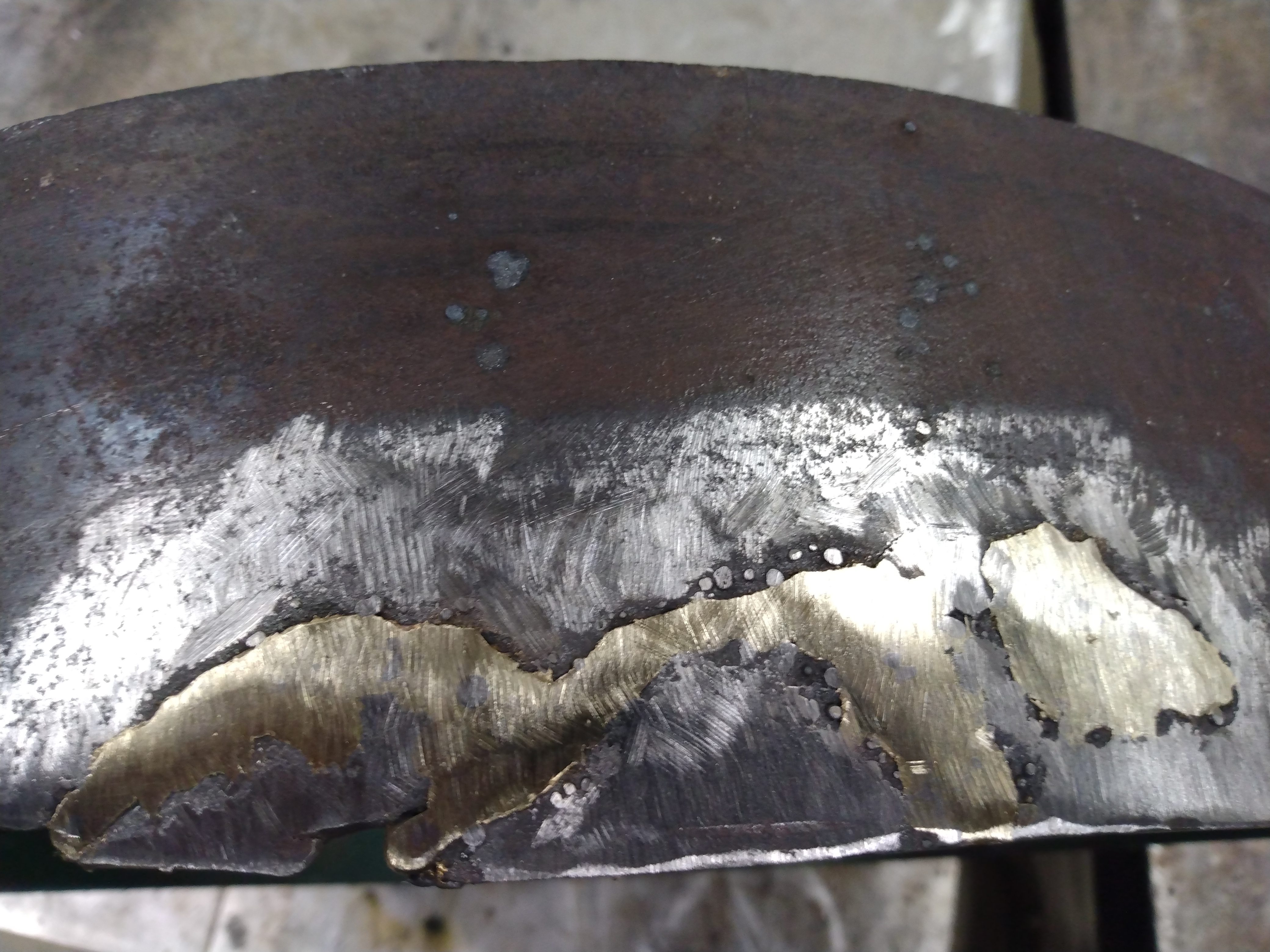

Here are the pictures
- Top side after grinding
- IMG_20211204_074142972.jpg (3.14 MiB) Viewed 24603 times
- Underside before grinding
- IMG_20211204_071950081.jpg (2.07 MiB) Viewed 24603 times
- Top before grinding
- IMG_20211204_071925853.jpg (3.11 MiB) Viewed 24603 times

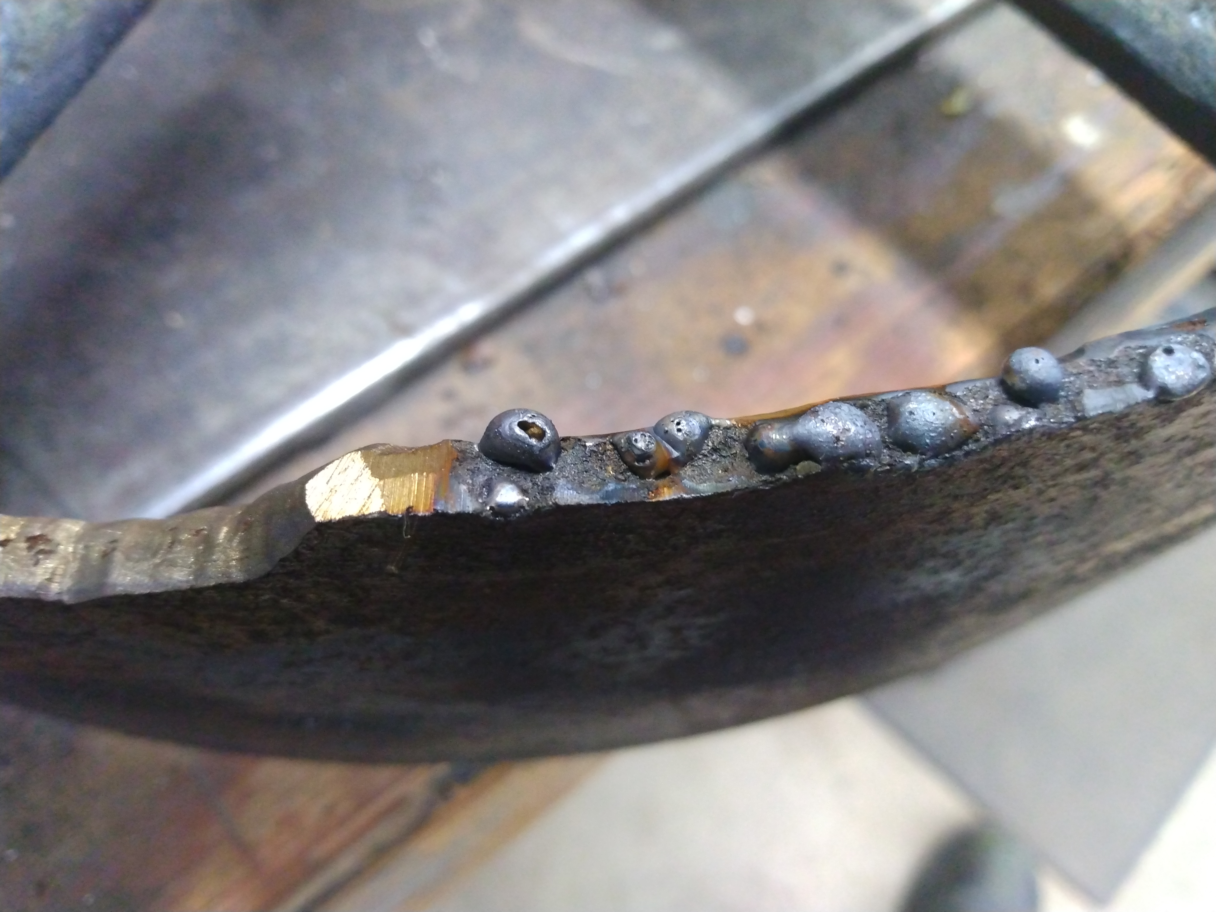

The very first photos showed some of the run off balls. It would be interesting to break a couple of them off and see if they're magnetic. You might have some weird alloy going on than hinders the repair.
Lots of pulleys are a cross between sintered and cast. Often very low grade with lots of impurities. That’s why there cheap to replace there designed to be a disposable wear part.

I was intrigued by this so I knocked off a couple BBs and they are quite magnetic.

I believe that I was up around 30-35% cleaning, on the Balance. That is where I tend to run the Balance when welding on questionable materials.
I also use a Carbide burr to gouge out along the crack lines. This makes a smoother surface that cleans up better after the cooking pass.
Make a cleaning pass along the weld lines with just the torch, to cook out impurities, then brush it again with a stainless wire brush.
There appears to be a surface coating of some kind in the photos. I would have taken it down to shiney metal before welding.
