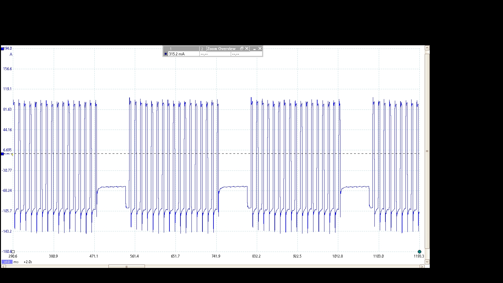

On my machine, the pulse settings start with background current as a percentage of the peak current (1% to 100%), the pulse frequency (0.5 to 10 Hz), and the percentage of the duty cycle during which the AC current is at maximum (20% to 80%). [ I'm sure not all machines are the same in how these parameters are defined, so please don't read across from my data. Until I set up my 'scope today, I thought the duty cycle part of the setting was the opposite way round to how it is. There is nothing in the manual about these settings, which is poor, especially as the display on the machine does not make it obvious.]
Looking now at the Advanced Pulse with sine wave, with 60% background, 4 Hz pulsing and 80% of duty cycle set. Here we see the defining feature of Advanced Pulse: a period of continuous DCEN, punching into the workpiece. In this case, that period is 20% of the duty cycle.
For comparison, this is Standard Pulse with sine wave and also 60% background, 4 Hz pulsing and 80% of duty cycle set:
Finally, just to make it more obvious that there is 70% electrode negative on the AC part of the waveform, here is Advanced pulse with square wave set (as opposed to sine wave above, where the percentage EN is not so obvious):
I hope these pictures help to make obvious the difference between standard pulse and advanced pulse. The first 3 screenshots - sine, square and trapezoidal waveforms - have certainly helped me to appreciate that, with square wave, there is no 'dead time' i.e. the current is always either maximum positive or negative, whereas with the sine and trapezoidal waveforms, noticeably less energy per second is going into the workpiece because of the ramping up and down of the current. (I can now appreciate why terms such as "softer" are used to describe eg triangular waveforms, or, indeed, anything other than square wave.) So, if welding a thick piece of aluminium, and maxing my machine out, I certainly wouldn't want anything other than square wave; that might be obvious to some, but it certainly helps to see why on a screenshot.

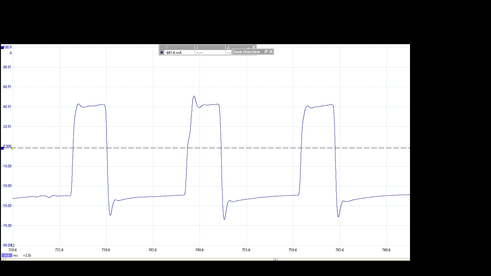

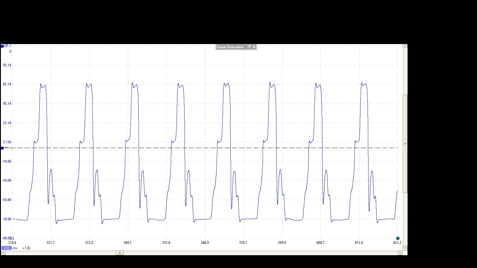

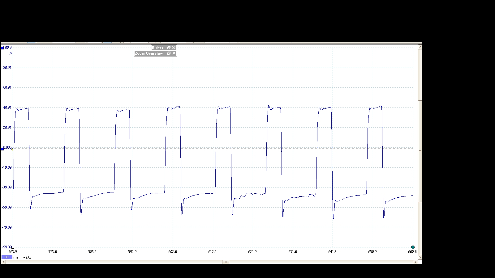

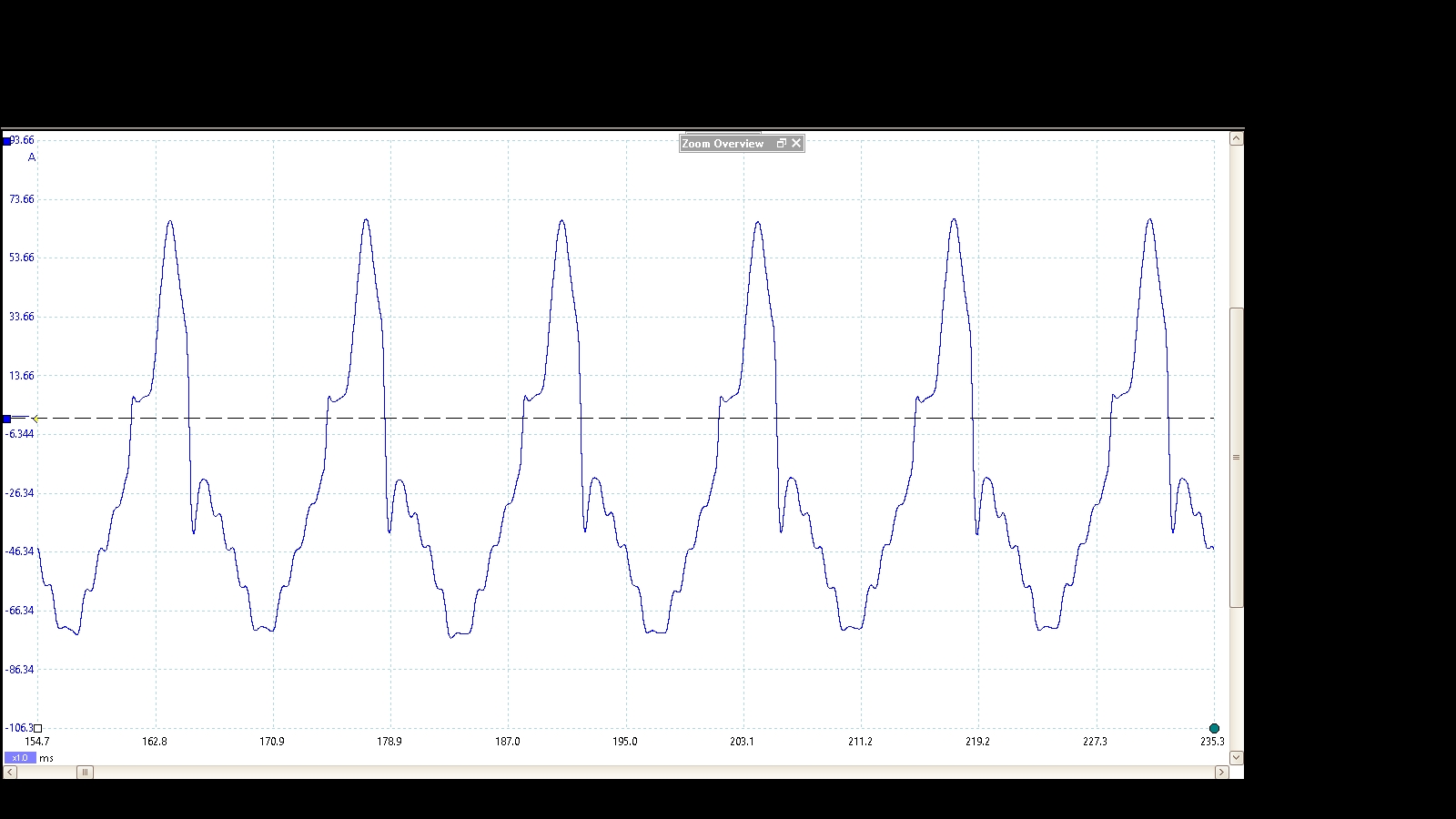

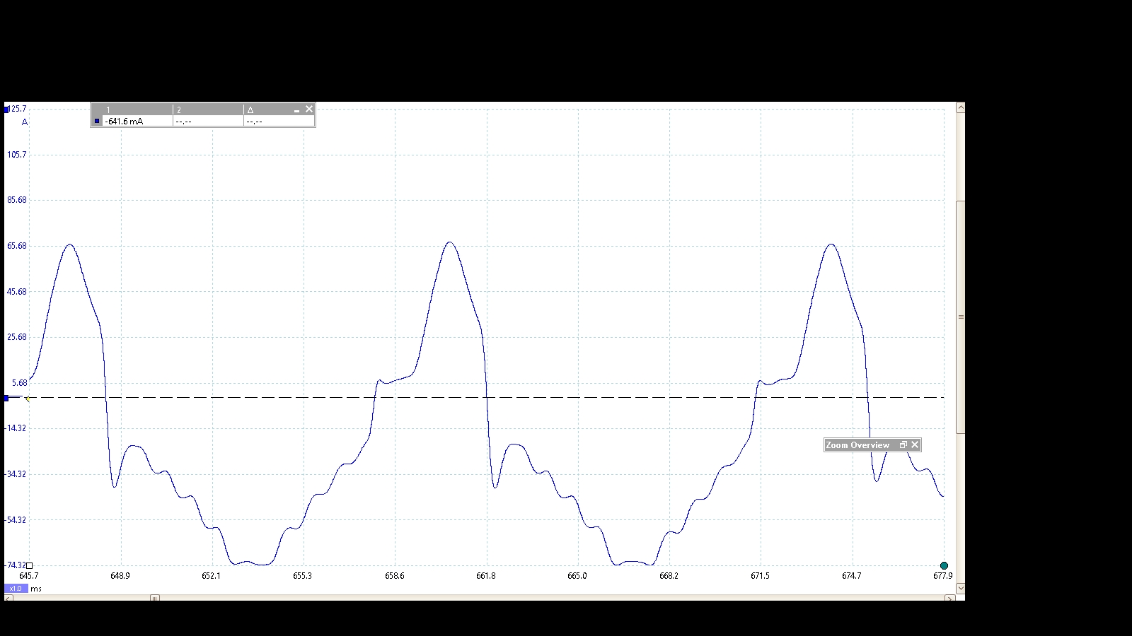

I thought it might be useful to look a little closer at the shape of the sine wave, the trapezoidal wave and the square wave, shown in that order below, just to be more aware of how much more energy is going into the workpiece with square wave per unit time:
- sine wave up close.jpg (289.95 KiB) Viewed 4630 times
- Trapezoidal up close.jpg (294.85 KiB) Viewed 4630 times
- square wave up close.jpg (257.7 KiB) Viewed 4630 times

I think we'd have to assume that the waveforms don't really look like that - they are just likenesses
The sinusoidal waveform doesn't have a 50% balance so obviously it isn't a sinusoid. There is evidence of quantization levels but also of some overshoot. The square wave shows significant overshoot possibly due to capacitance in the measurement/test circuit.
Nevertheless, the images give a very good insight into the operation of the pulse function and of the power supply itself.
Thanks again Martin.
Jack

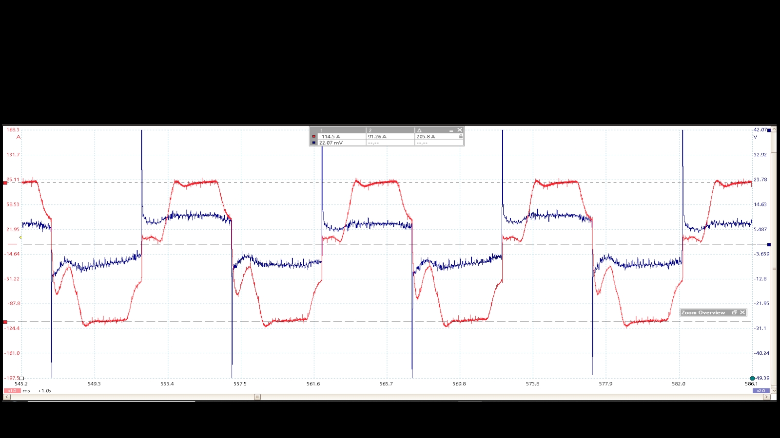

I must thank you: I finally decided to get a Pico TA057 differential probe. Now, it all makes sense: there is no puzzlement when overlaying voltage and current.
On all the tests below, I had the AC Balance set at zero, i.e. 50% electrode negative and 50% electrode positive. However, when I measure the peak currents on the 'scope, it is clear that there is quite a discrepancy. A typical result is shown on the trapezoidal wave: 91A positive and 114A negative. This is a minor point, but just in case anyone notices the difference. ( I could, of course, calibrate and make a correction, if I wanted to at a later date.)
Anyway, here are the waveforms. To clean up the signals a bit, I employed low-pass filtering (10kHz on voltage and 80kHz on current)
VOLTAGE IN BLUE, CURRENT IN RED
You might find it surprising that the welding voltage is only around +/-10V
Tell me if there's anything else you'd like to look at. Thanks again for your encouragement and advice.

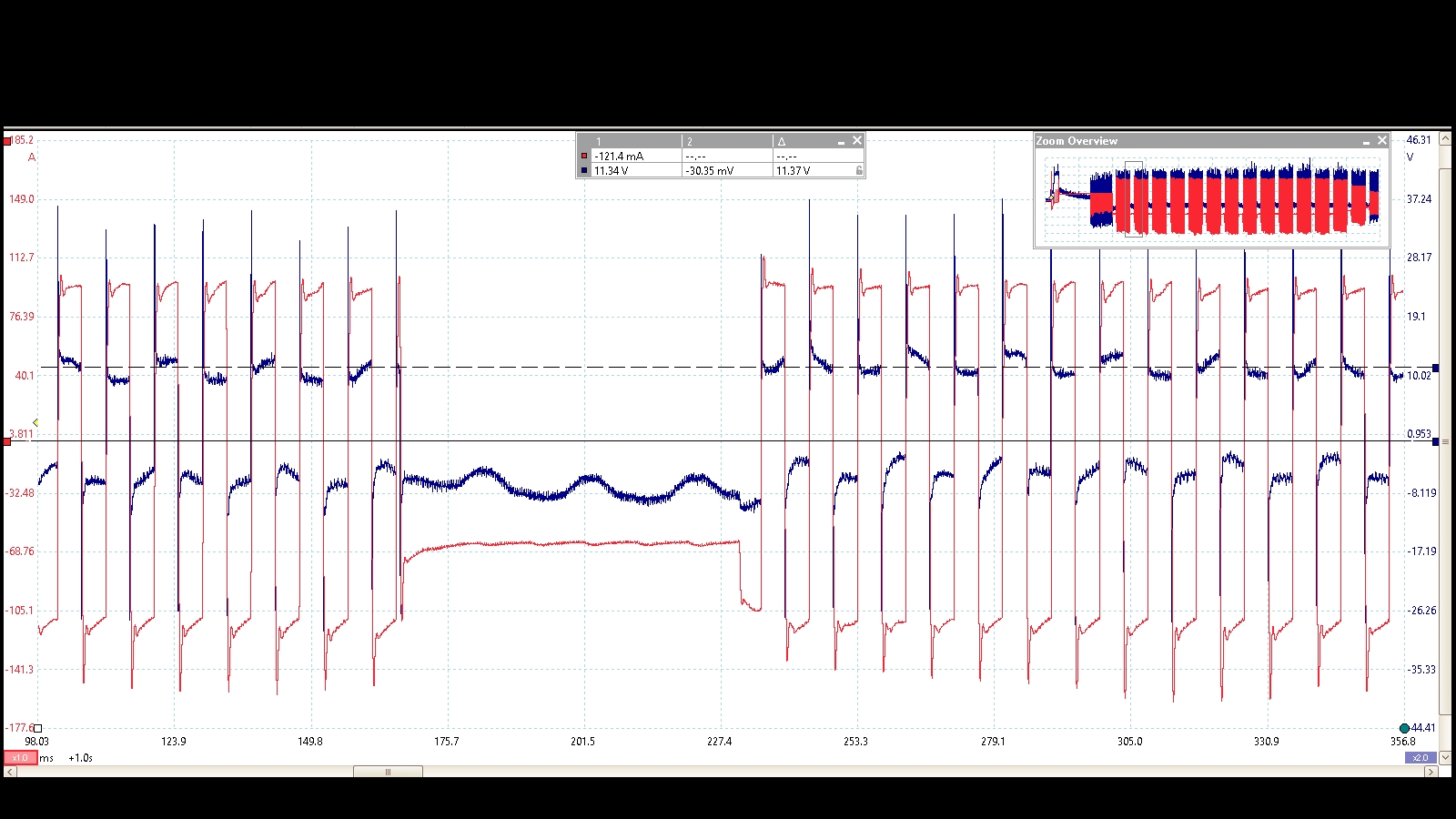

And Advanced Pulse

And Advanced Pulse
- Adv Pulse.jpg (479.38 KiB) Viewed 4540 times

Hi Martin,
There may be an actual imbalance between the EN and EP currents due to partial rectification.
What is the nature of the common mode noise?
Thanks for your efforts - very interesting!
Jack

Very nice to see the V/A graphs
Eg. you can clearly see the spike in voltage right after the crossover point where the arc need to re-establish (higher resistance) even though HF is helping to keep the ionisation. Once the arc path is there the voltage drops to the base welding level as the path now has low resistance and the inverter logic then kicks in to start controlling the actual weld amps.
I expect you have the torch in a clamp and at a fixed distance to a block of alu or similar? Probably nice and short at the moment which should keep the voltage low.
If you do a trace with a longer or shorter arc you'd likely see the welding voltage get higher or lower with the arc lenght and at a certain (too) long distance the inverter may start drooping on the amps as it hits it's max kW rating on the total power it can provide.
And yeah.. As you can stick-weld with just a car battery and an electrode (not advised, but possible..), 10V doesn't seem too odd
Bye, Arno.

Hi Arno
And that voltage spike as shown is a good bit lower than it really is due to the low-pass filtering I set, both to clean up the signal and to reduce the height of the spike relative to the rest of the waveform.
I held the torch by hand and moved it along about one inch, keeping as short an arc as I normally would do. (I set the ‘scope to single trigger.)
That’s a great idea for a DC setup: voltage variation vs current with arc length. I must give that some thought and then give it a try. And with the maths channel, a plot of kW power would be simple to display. Or, I’m sure I can display X-Y, so I could display Volts on the Y axis and Amps on the X axis (and kW as well, perhaps). Leave it with me.

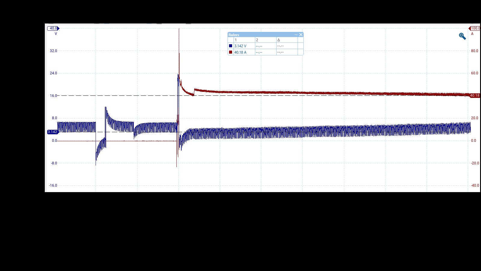

I had a look at how arc voltage might vary with arc length, with a view to gaining insight into the Voltage-Current welding characteristic of the inverter. I set up TIG DCEN. After trying to plot X-Y, Volts vs Amps on the 'scope, I gave up and simply looked at both traces as I increased the arc length from less than the electrode diameter to a massive 2 inch arc length. The results show that the voltage (and current, as you'd expect) stayed remarkably constant as the screenshot shows.
VOLTAGE IS DARK BLUE, CURRENT IS DARK RED
- TIG DC Volts and Amps.jpg (107.73 KiB) Viewed 4457 times
I think I might try a MMA setup instead of TIG: voltage might vary more with arc length, but with TIG there is practically no variation of voltage with arc length.
