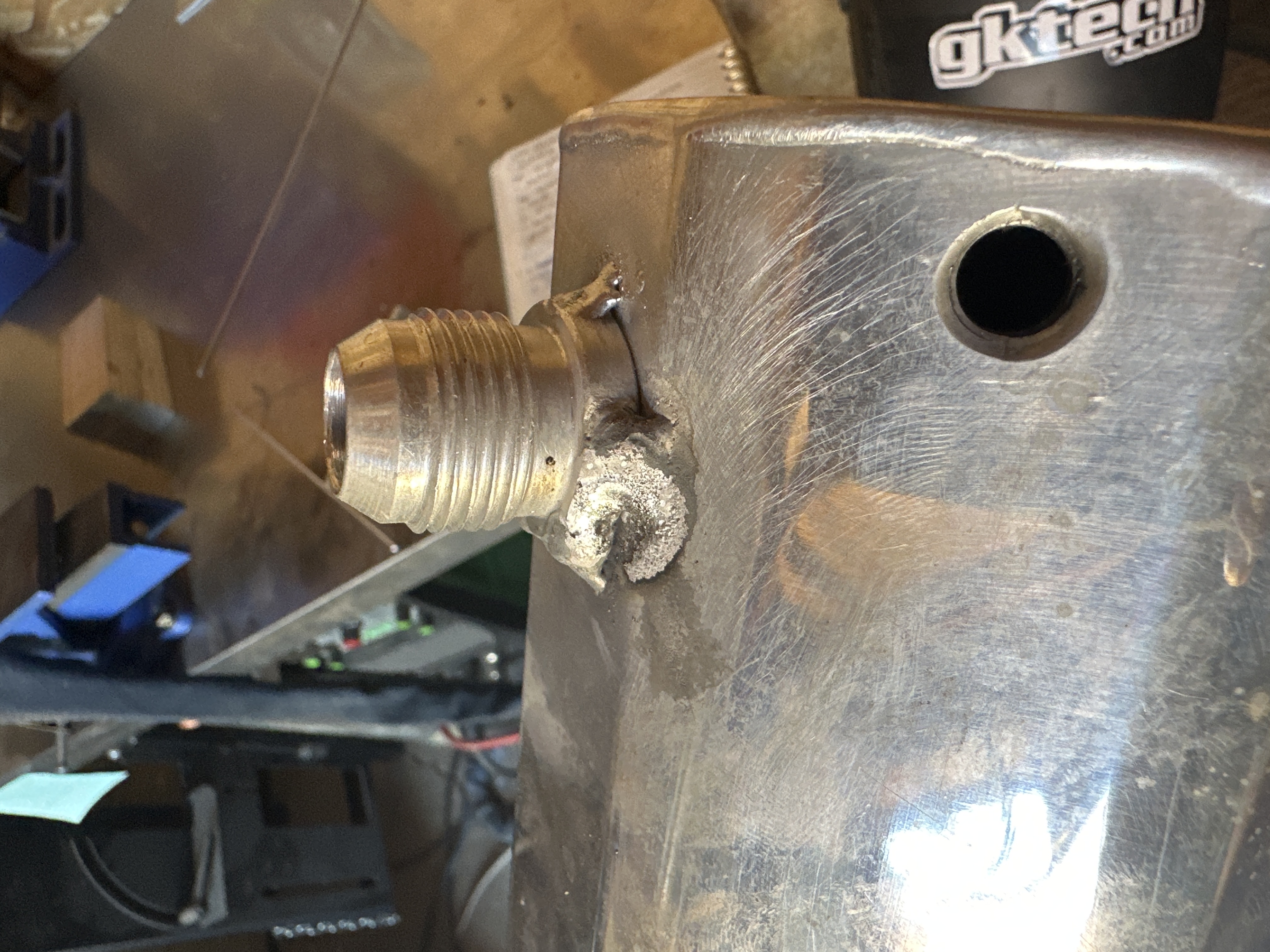

Hello everyone, I have stumbled upon a problem when trying to weld any aluminum piece.
When I go to initiate the arc on my piece it can start ok but then one second after just starts to sputter on and off causing it to get a lot of contamination. Now I do clean and wipe down the piece with a brush and acetone , I have the the negative clamped onto my table and everything seems in order but for some reason it’s been doing this on some passes and I am deeply confused on why. I’ll post a link to show what I mean by the sputtering I am experiencing. Thank you for reading

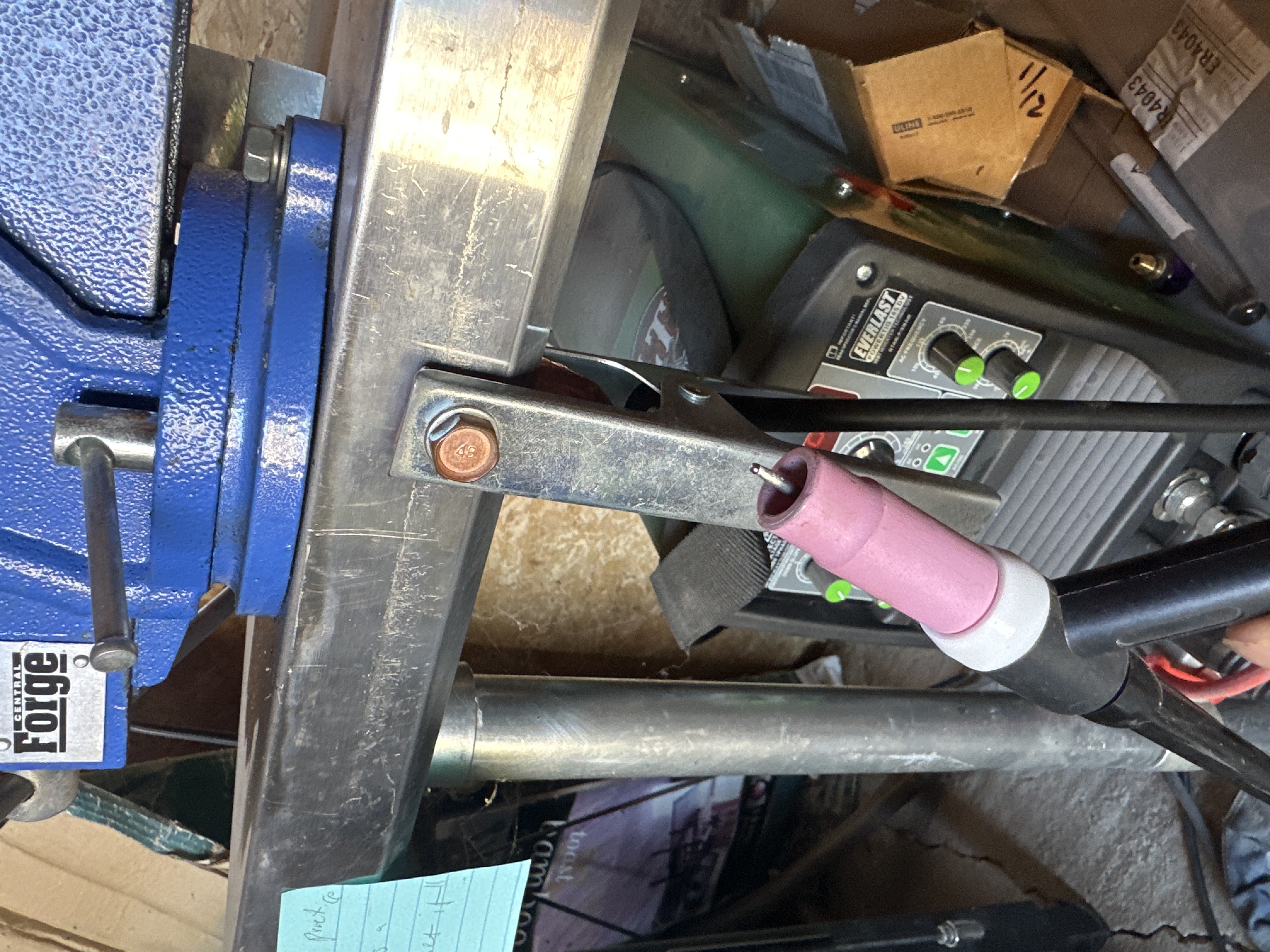

240sxbandit wrote: ↑Thu Jul 30, 2026 8:54 pm I have the the negative clamped onto my table
Can you verify what you mean here please?
Jack

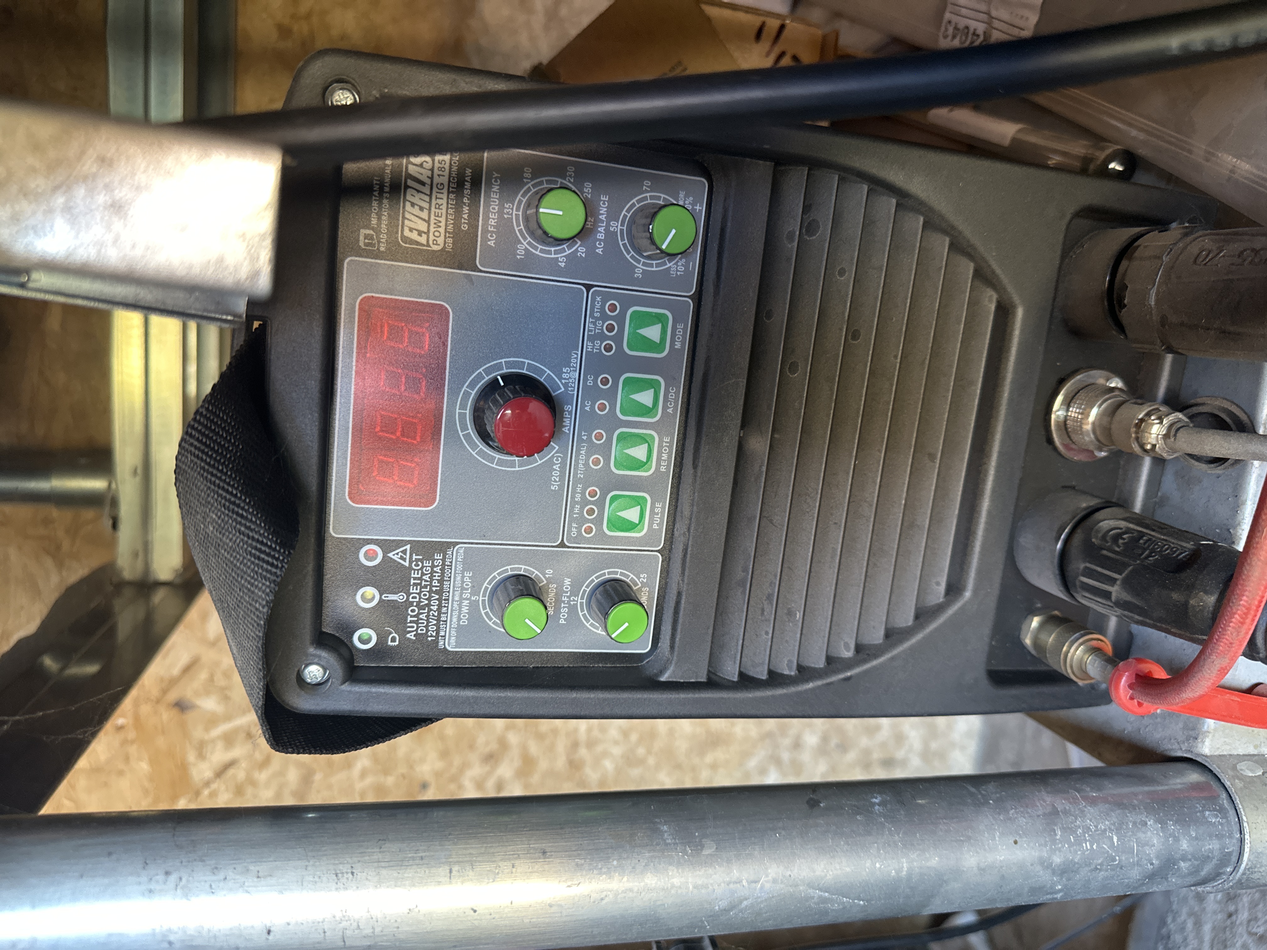

Hello and yes of course!
So machine is an everlast powertig 185dv
Using a #7 cup @12cfh
100 amps
3/32 ck green tungsten
Frequency @135
And balance @30
Yes I tried to pre heat but still had a bad ark. And I’ll try to earth straight to the work piece. As you mentioned the third arm idea is good cause it’s an oval shaped catch can so it’ll move around here and there . But thank you for the reply
Can I say again, please clarify the polarity you are using.
If you are using electrode positive your balance will be inverted. So 30% cleaning will become 70% cleaning.
Jack

as Jack Ryan mentions, positive should be connected to the table. the tig torch is negative.
green tungsten is pure tungsten and is not recommended. however ck does use green packet for their layzr tungsten which is fine. taper make it fairly blunt. a fine taper will melt off and that could put tungsten in the weld and makes things a bit funky. you shouldn't be getting so much of a ball, but pure tungsten will do that, so will getting leads back to front. edit: light green is layzr, dark green is pure.
hard to tell what size that material is, but i would run at least 150 amps. or just set it to max and use the pedal to dial it down. you want a puddle to form in a few seconds.
funny enough if your to cold, you sit there to long and overheat the aluminium and 4043 goes to crap when overheated.
also i would drop cup size down to 5. have a bit more downslope and have a lot more post flow. you need the gas flow to keep the tungsten clean as it cools down.
hopefully that helps at least get the basics reasonable and then see if the problem is still happening.

Yeah I apologize totally missed that. Just checked have earth on positive and negative on my electrode.

He already confirmed DCEN. The problem is simply too little amps and in my experience too low of CFM. Tweake encouraged cup size #5, I’d go that route too since your #7 is a collet body style and not a gas lens.
With a #7 crank the gas up to 15-18 CFM, 150 amps. Arc pointed at base until it starts to wet, then up onto bung, then right at the gap before you add filler.
Another issue is the edge of the tube. It creates a split in gas coverage so you get interrupted shielding. Keep the arc really pointed directly at the gap. Too much “vertical” angle and you’ll have no shielding as you come around the side of the bung where the tube overlap is the most narrow.
Bump up to 75%-78% for better results on your penetration.
