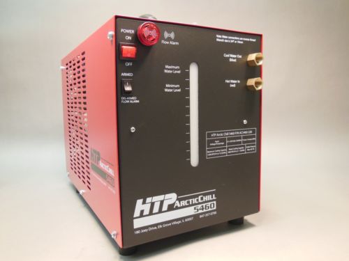

What water coolers do you guys run???
HTP Arctic chill 5460 $439
Miller CoolMate 3 $769

I have the HTP cooler. I have only had it since October, but it works well and I am pleased so far.

I've been looking at the HTP cooler and it looks like a solid performer....
Anybody out there had any complaints on it???

Any comments on the HTP unit
$439 right to my door is kinda hard to beat....

Looks like HTP gets the cooler from these from Nu-Tec....according to this they are the replacement for Bernard coolers...
http://weldingdirect.com/ntwaco2ga.html
It is nice having the flow alarm...and it works! iIf I step on the hoses and cut the flow it alarms right away LOUD!
I did have to call HTP tech because the flow alarm would alarm constantly with my 25' torch setup... he had me plug off the water presure reducer line...now it works fine with no alarm...
My only complaint is the fan is LOUD...I am thinking about converting to a electric fan instead of the mechanical to reduce nosie

So I have the HTP cooler and 25 foot torch. I am also having intermittent alarms for no reason.
I am curious if HTP told you to block that little blue line to raise the flow through the sensor?

Yes sir that is exactly what they told me to do just pull the small blue hose out of the tank ...fold it over and zip tie it and your problems will be overSmartDave wrote:So I have the HTP cooler and 25 foot torch. I am also having intermittent alarms for no reason.

Never had any issues with mine. The distilled water turns orange-ish, have absolutely no idea why, thought perhaps it is a by-product of the algae eliminator. Everything flows freely and works properly.
I personally don't think it' all that loud. At least that way you know it's running if it's heard in the background.

I too have the Htp cooler. I only have two complaints. First is how loud it is, second is that while it works great with my 25' ck torch, if I hook up my weldcraft it immediately trips the alarm, which really sucks as I really like the feel of the weld craft. Using the weld craft on the miller cooler, or the Lincoln equivalent, or a Bernard the toe h is fine.
