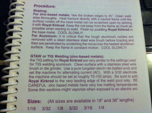

I am looking for the best weld procedures for welding some of these die cast aluminum automobile parts.
I think the parts have a mixture of tin, aluminum and magnesium. Any help or ideas will be very much appreciated.

Gary,
Welcome to the forum!
I have repaired a carburetor once with Crown Royal Kirkrod. Carburetors have a high zinc content and it worked for them. You have mentioned there is a mixture of tin, so I am not sure this will work, but you could give it a try. To give a better answer, what parts exactly are you wanting to weld? If it is a intake or something like that, this may not be the correct filler.
The major drawback is Kirkrod it VERY expensive for only one pound! I was also provided a junk carb to practice on before lighting up on the real thing. When it says it has a low melting point- it means it. It took some practice until I was ready for the real thing. Clean the material really good and don't breath this stuff.
Here are the specs provided by Crown.

- Crown Kirkrod.JPG (98.04 KiB) Viewed 1957 times
- Crown Kirkrod applications.JPG (147.99 KiB) Viewed 1957 times
- Crown Kirkrod procedure.JPG (153.03 KiB) Viewed 1957 times
Superiorwelding wrote:Gary, Hi Guy's
I am very familiar with the aluminum rod, I use a boat load of it for repairing aluminum propellers. Works great as I have finally mastered the procedure after 30 years doing it for my business.
I did use this stuff for the repair of this automobile part. It was with 1/16"
Thanks for the replies.
Gary

This part is a steering wheel column part made of ZAMAK. It's off an old 1958 Cadillac. Was sent in from Sweden to be reworked by some old car buff restoration place. That's how I ended up with it
