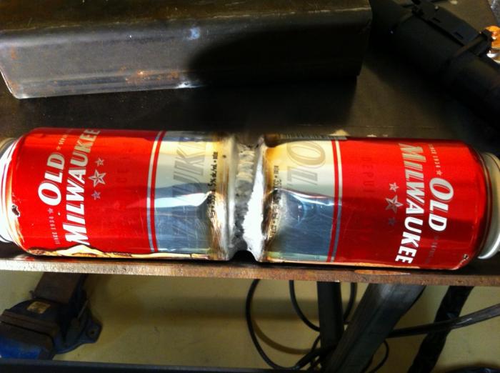

First try at aluminum cans...next time I'll use 1/16 filler if I can get it?
- IMG_1527 (1024x765).jpg (38.88 KiB) Viewed 2003 times
- IMG_1526 (1024x765).jpg (47.43 KiB) Viewed 2003 times
Old Milwaukee???
Seriously???
It "does" get better than this...
Nice work, despite your poor choice in "beer"...
Seriously???
