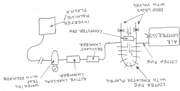

I drew a sketch of what I had in minde regarding the compressed air preparation. Its a crude sketch but I hope is clear enough for understanding the basic idea.
Instead of the U shaped inverted column and radiator plates I could also just make a coil out of the copper pipe to increase the surfice area and the travel path... Would this be better?
Also I read that active charcoal is quite effective at not only removing odors but also oil from air, so I guess an active charcoal filter in the system couldnt hurt.

You must be from Australia, your picture is upside down, sure sign.
Trebor wrote:Now what I dont know is if the air supply has to be initiated simultaneously with the arc in the plasma torch, or is it OK if the air is allready flowing prior to igniting the torch? Then I think this would work.
The air can flow constantly through the plasma torch, without issue. As I stated in my last post, you may need to plug the machine's gas outlet and turn on your argon just to supply pressure (no argon flow, just pressure at the solenoid) to fool the machine into thinking everything is hooked up "normal". The machine should have a safety to prevent currrent at the plasma torch if it doesn't sense "air pressure" to protect the torch.
Also, your sketch looks like a great system. Maybe even overkill if you bypass the machine entirely with the air supply, but as Jody has said, "There's no kill like overkill," so why not build it? If you paint your projects using air guns, you'll thank yourself.

And I see the sketch is upside down, sorry about that. Ill try to repost it the right way up.

Yeah, Im not from down under, and real slow at typing, Ill post the sketch again, cheers!
No... Not bleeding down argon... Not flowing. Just plug it where it comes out of the machine, so it can't flow, and turn the bottle on so the machine senses the pressure. The only argon wasted this way is the tiny bit between the solenoid and the plug, when you remove the plug to hook the TIG torch back up.

The only thing I see wrong with your dryer is the order of the components. You would want to have the Carbon filter in the line ahead of the chiller since Carbon aBsorbs the oil and it will work better at an elevated temperature. You want to have the silica gel at the end of the process since it aDsorbs (caps added for affect) the moisture and it works better at the lower temps. Also if you start out with a large size piping and reduce it every time it goes through a step in the process it will reduce the temp of the air in what's known as the Joules-Thomson effect.
I personally would start out with my compressor going into at least a 2" pipe for the U-shaped condenser and work my way down to 3/8 or even 1/4" tubing by the time I reached the machine.

Here is the upright sektch with additional one with copper coils, would that be better?
