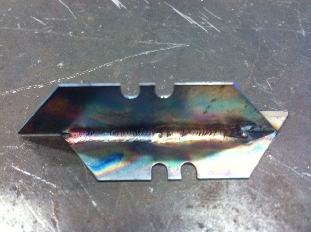

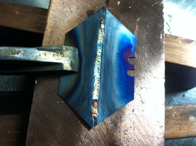

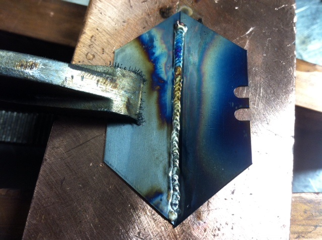

Per Jonathan's request here's some pics. Did these this morning not the greatest but was in a hurry. These are the .009" ones, the ones in razor knives are .024. Used my htp invertig 221 set at 12 amps but never used whole peddle. 1/16 tungsten to a point an polished with scotch brite, .023 308 mig wire. The ones that form a "V" are just fused. Never tried a "T" joint might have to give that a shot next time. Pics kind of suck took them with my phone.

Actually without my glasses/contacts it's pretty horrible lol. I did set my helmet to 8

Are those the same thickness .009 as like the old school double sided blades for them old razors? Cuz I know those are thin plus i got some of those i can try on. Id like to see if i could do it

Ive got no idea if heir the same thickness, give it a shot, post some pics of the results.

I was thinking some .040" would be ideal, or at least make it a little easier.

what kind and brand of tungsten are you using?
cb
Wes917
    Fri Oct 25, 2013 11:45 pm
2% ceriated, brand I have no idea I don't keep the manufacturers seperate could be diamond ground, radnor, htp ...

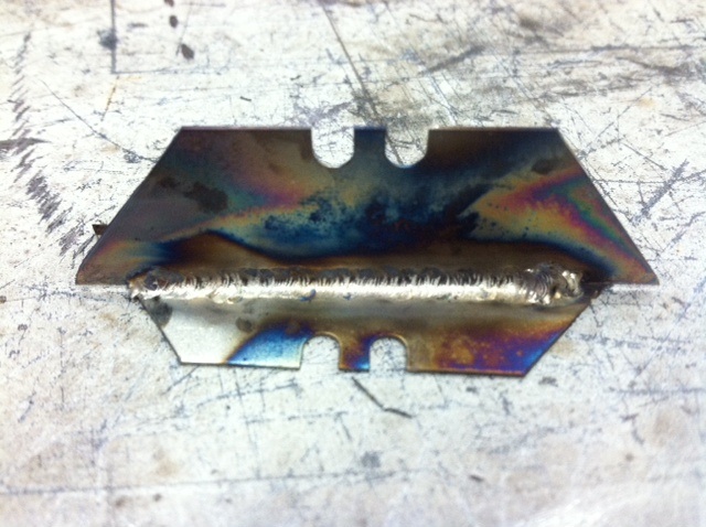

Done with 1/8 tri mix tungsten, finger slide control, going to try some with my SA200 this weekend.
-Sean
Wes917
Nice work. Are those Stanley's? If so these are the .024's. how long of a taper did you have on that 1/8" tungsten?
forrestderp
    Tue Nov 26, 2013 2:51 am
    Saint Cloud/Duluth MN
Wes917 wrote:Nice work. Are those Stanley's? If so these are the .024's. how long of a taper did you have on that 1/8" tungsten?
They are the "were on sale for $.99 blades", I think they are pretty close to the stanleys I have done. The taper actually isn't that excessively long, I have a fine grit grinding wheel on my bench grinder that only gets used for tungsten prep, and I use that plus a power drill to set the point. 500 pps and I will have to check what I run for background current and whatnot when I am home next. The arc comes off really smooth and doesn't wander with the high speed pulse, usually set amperage to 35 or so and use a .035 308 tig rod. Machine is a thermal arc 400GTSW, kinda amazing what these machines can do if you watch them, I typically use an aluminum heat sink, but I have also done them suspended as well just to be sure of what I was witnessing.

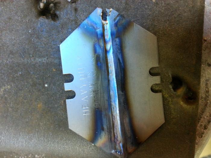

I actually did these Thursday night and am just getting around to posting them. I had a SS tig job to do an when I was done I re-sharpened the 3/32" E3 tungsten and went to town. Set the machine on 30 amps. Was quite fun, will have to do it again later. Got talking to others, I really don't think welding razor blades is all that hard compaired to other things. Pop cans are harder, but even they are not that bad. I suppose if one wanted to lay down a very nice bead this would be harder.

So the guys challenged me to weld razor blades in a fillet configuration, I obliged and it was quite fun. I used .035 mig wire for filler. Can you tell we are a little bored?
