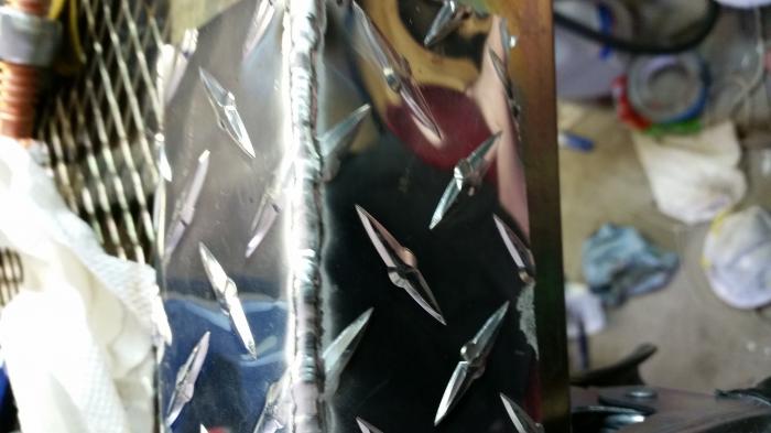

Hey guys.....I'm a beginner welder and I'm having some issues with an aluminum box I'm trying to make.
I've got some diamond plate polished aluminum sheet 18 gauge thick....used my brake to form a box and I'm trying to tig weld the open seams and corners.
I have a Miller Syncrowave 200 and Weldcraft WP17 torch with 7 cup, 1/16 2% thoriated tungsten electrode, 4043 filler rod 1/16" thick. Had my max current at 75-80, 100%Argon flow at 15cfh....my balance was at 7
When I practiced on scrap diamond plate I was getting excellent puddle control and laying down some sweet stacks of dimes. Got a nice cleaning zone around the edges and had no issues. However, when I try to weld the edges of the box together I totally suck. I end up melting each edge but can't get one puddle to coalesce. When I try to add filler rod it balls up and doesn't integrate easily into the joint. I tried going way ass down on my current but still can't get a puddle to form in the joint. It occurred to me last night that maybe I should put some backing under the seam since this metal is so thin and melts through easily. Any advice would be greatly appreciated....thank you....I forgot to mention that I cleaned the shit out of the aluminum with acetone

When your filler does not melt into the puddle and balls up, it's a good indicator that you are not using enough amps to form a defined puddle to wick the filler in.
Or tried to put the rod in too early.
I've "speed tacked" 1/16" aluminum corner joints at 230 amps in 3/4 of a second - it's an extreme example but faster tacks are easier.
The thinner the aluminum (or steel) the tighter the joint must be to make it work.
At 18 gauge, it definitely should be touching with no gaps to make your life easier.

- Make the edges touch.
- set the machine to ~130A.
- Use the equivalent of 65-75% EN (not sure what the settings on your machine mean, but do cross reference to make sure you are using the correct amount of percentage of EN). (The cleaner the aluminum, the more EN you can use which makes better use of the current setting for producing the tack weld we're looking for)
- Sharp 1/16" tungsten with a 3x-diameter taper. 2%La works best.
- Make sure the tungsten is pointed right at the middle of the joint 1-2mm away <---super important!!!, not towards one plate nor the other, otherwise you'll just end up with exactly where you were at before. You need to be congnizant of these kinds of things all the time since you're beginning with aluminum.
- Floor the Pedal. Not slowly. As fast as you can move your foot, literally.
- As soon as the arc starts, as in immediately, let off the foot pedal. The goal is: the fastest arc strike you can manage, but NOT ramping up slowly, an instant ON/OFF blast.
- You should see a nice clean circular tack about 3/32"-1/8" across (diameter) [2.4-3.2mm]

Amazing replies....Thank you sooo much for the awesome advice! Couldn't have done it without you. Took this pic of the 1st time I got it. Rough as hell but was 1st corner bead I got on this stuff. I found the most important factor to be quick arc start and amp up with pedal ease off quickly. Cleaning didn't seem to be as big a factor as that. I was able to lay some great welds on stuff I never cleaned...of course its a diamond plate polished so pretty clean already. 1/16" was the way to go and got 1-2 mm from joint....2% lanthanated very stable....I kept burning holes after a few cm. and at joint ends b/c of heat build-up....just gotta ease off pedal and get feel of it....you all got me going though....thanks a lot and have a great thanksgiving!!!! Will be back here often....just ordered some tig fingers

The biggest thing is not to be scared of power! Many pros I know just set their machine to kill (full power) and control the weld with the puddle. I tend to do the same. The benefit, like Dave illustrated is the ability to have an instant weldable puddle then go... Also diamond plate is not really 18 gauge because each diamond adds thickness so each time you weld across a diamond tread your are in essence doubling the thickness of the aluminum.
