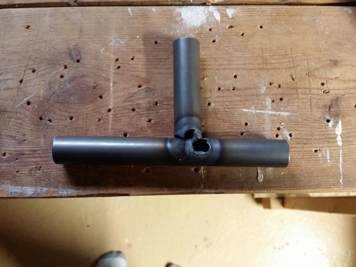

Hi Guys,
Totally new to tube welding and gave it a shot a week ago.. and it didn't turn out too good, lol.
I am using 35 amps and a 3/32 tip and I am totally lost.. so any advise would be welcome.

You are probably holding too long an arc length, and going way too slow.
Reduce your amperage slightly, hold a much tighter arc and see if that heads you in a better direction.
I would find time to practice on something a little less challenging than thin-wall tube. Try some 16 or 20 gauge sheet and practice some fillet or butt joints on that first, Try some different settings on the machine until you are comfortable with that, then take the next steps.

what else have you practiced on? (tubing is the #1 worst thing to start tig welding on, even for practice!) My advice is hidden in my question, BTW. ;)
Please list what machine you are using, and the settings you have tried with it. From here on out, you will get bombarded with questions, so just disclose EVERYTHING up front and save everyone sometime if you would like to get good, concise advise.

Yes, lower your amps and shorten the arc length.
I learned to weld by filling in holes on sheet metal.
If you have some scrap tube, try adding weld to the ends.
See if you can build up the end of the tube and close it off.
If you mess up, just cut the end of the tube off and try again.
It's all about learning heat control.
That looks like 4130 tube,
say, 1/2" X .035 wall, or maybe .049.
The heat-affected zone makes me agree with Trev, you're putting in too much heat. The blow-outs confirm this.
What filler are you using? Do you have a foot pedal or other remote control? Thin tube is much easier to TIG weld when you have complete control over the welding current.

Oh crap.. sorry guys.. lol
I am practising on 4130 tube that is 1" OD / 0.035 wall thickness
Everlast PowerARC 160 STH (I took the 2T switch off and am learning to use the pedal).

That's a big plank with big-arse nail holes, then, if that's 1"... That's why I thought it 1/2".
I'm tickled I got the thickness from the picture.

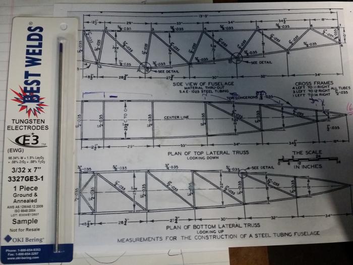

Oh and ditch the 3/32" tungsten until you really get good. Pro's can work with it much easier, but I'd bet you will be able to do much better with a 0.040" or 1/16" tungsten sharpened to a point with a long taper.
Something like this would work much better (after you practice on normal flat plate that is----you can forget doing aircraft/airframe welding anytime soon :)) That is a 1/16" tungsten, and a 0.5mm "arc length", for reference.
rkirk77
    Sun Dec 21, 2014 11:21 am
    Sarnia, Ontario Canada
Ok.. thanks oscar!
What type of tungsten are you using and how long is that taper?
PS, i am using electrode negative..

Here is the tungsten I have been using..

I use 1.5%La/2%La/Quad-Mix interchangeably for everything (not that I do much other than plain ol' steel, but all of those work great for the few times I decide to make something out of aluminum). Yes, you are supposed to use DC Electrode Negative for all steel tig welding, lol.
For the taper, glance at the un-sharpened portion of the tungsten itself. It is 1/16" in diameter (1.6mm). Then glance over at the tapered point. Then glance back at the rod. Then back. You'll get it. ;)
The E3 would work just fine, it's just operator-error at this point. TIG welding small round tubing for aircraft frames is not something that you pick up over a couple weekends. More like 5-10 years of day-in/day-out tig welding. You must crawl before you can walk. Start practicing on 1/16" - 1/8" flat steel, just running beads without using filler or anything. Then you move on to adding filler. Then you move on to doing butt-joints. Etc, Etc, Etc. If you can' do basic joints in flat-steel practice parts, you won't get anywhere fast doing thin-wall small-diameter tubing.

What kind of airplane are you building? I ask because I saw the fuselage drawings.
rkirk77
It's a Pietenpol Air Camper.. very easy and fun to build!
