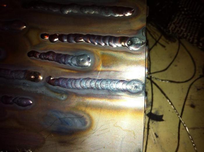

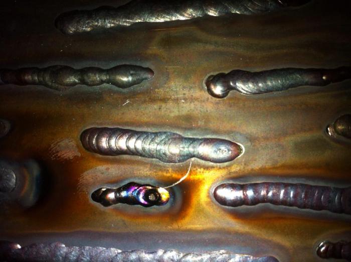

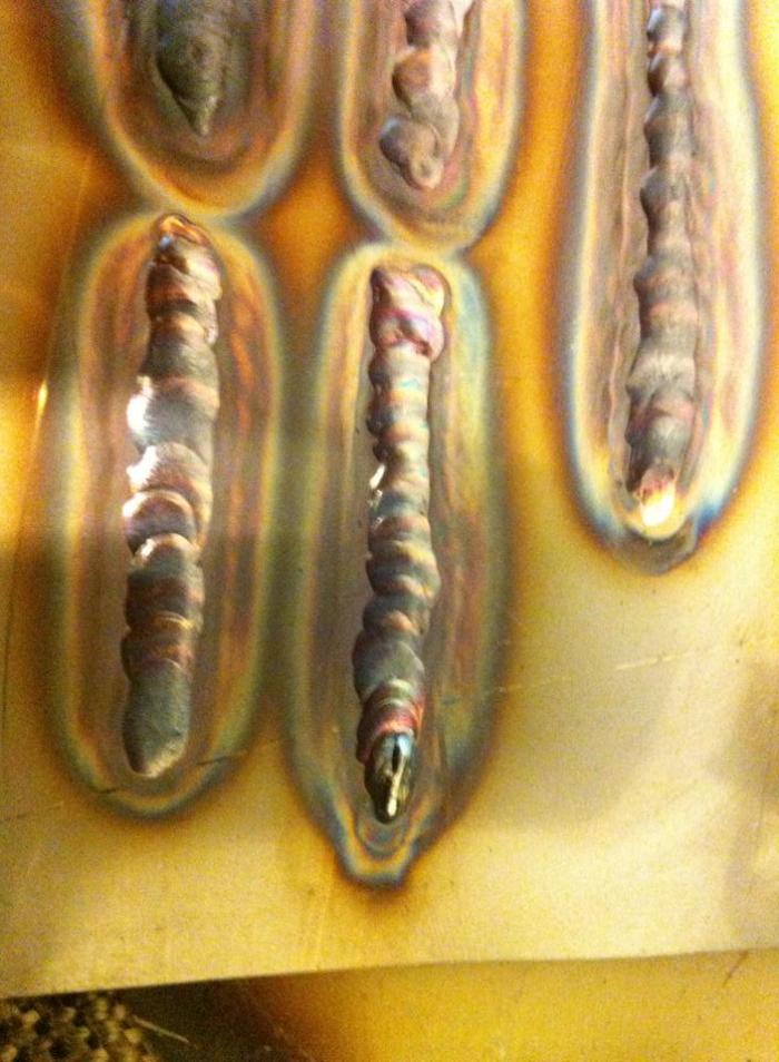

ok after some practice on 3mm ss304 this is the result, 2.4mm thun and 1.6 filler.
any advices will be apriciated

You are welding too slow and holding an inconsistent arc length because you are new to tig welding. Keep running bead after bead, but not on the same tiny plate. You will heat-soak it which introduces yet another variable you are not able to yet control. Have multiple pieces on hand so you can keep alternating.
DItch the #6 cup and use a #8 for now. Make sure you have at least 8s of post-flow to help the bead not to oxidize. Run only 1" long beads at maximum until you are able to better manipulate the many variables that must be controlled with tig welding.

1.Arc Length
2. Torch Angel
I think a lot of times you think the weld puddle should be bigger so what's first thing you do give it more arc length. yes the puddle gets bigger but you increase heat input and makes it harder to control puddle. Also in your welds where all of a sudden there is a change in your bead width I would bet that was when you had to move whole hand and increased arc length when you moved hand. plus because you had to move hand and reset fingers to natural position the piece soaks heat in that area. Try to slide whole hand when moving torch so your not welding with finger tip movement. if you learn to weld that way you can only do an inch at a time before you get out of position.
Arc length should be 1 to 1.5 times of your diameter so in your case at least 1.6 no more than 2.4 I do not like going to the upper limit keep it around 1.6 to 2.0 things will improve and you will be like
When I had trouble on tubing not looking like I wanted it was because of not rotating torch as I went around it. So torch angle would be off as I moved torch forward. I noticed on a Mr.TIG video he also was coming around tubing but not rolling torch to correct torch angle. Which equals crappy looking welds. I brought my torch in house with a tubing joint and practiced keeping angle and arc length the same. Since I was in house with no helmet I could see errors in my movement and could correct it and learn muscle memory. next time I tried it with hood and real arc there was a huge improvement. I know you are doing flat plate right now but don't be afraid to take your stuff in house and do dry runs practicing moving torch in a smooth manner watching closely your arc length and angle. Also practice moving your whole hand not just your fingers. Practice with a purpose like you are really welding. If you just drag fast it's not gonna help. Get a rhythm going move dab move dab move dab. trust me this will work to help you improve

It looks to me like you are running too cold. The beads have too much crown. Turn up your amps so the bead will flatten out. Don't worry about the color for now-just concentrate on getting a good bead. When you can lay a nice looking bead=then worry about the color!sshh wrote:thanks mike,

Hope this helps! The trick to stainless is go in hot and get it done. Don't let the heat build up!!!

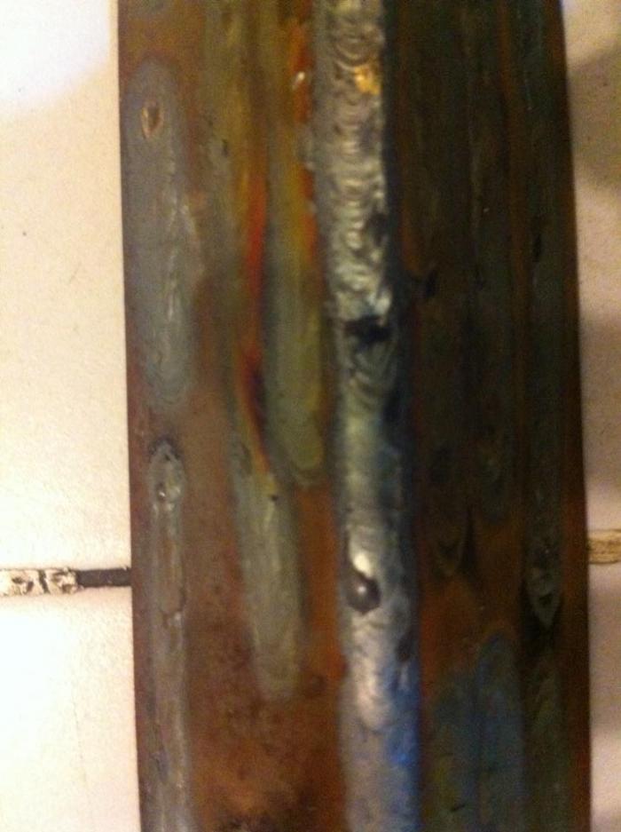

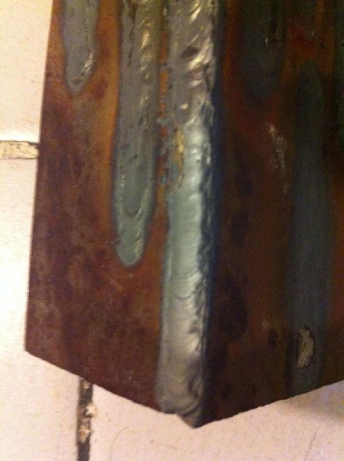

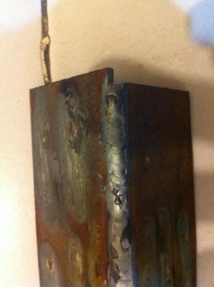

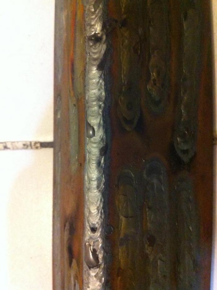

made some practice on steel, then welded two parts this is the result

Like motox said you have to weld with argon. If you don't have gas the tungsten will just burn back up into torch and make a huge mess. Learning uses a lot of gas, filler, and metal. Not sure of your tank size but I suggest you get the biggest tank available. these are normally a 300 size and you will have to get a lease or rent. your refills are considerably cheaper When you figure out how much gas you get compared to filling small tanks.

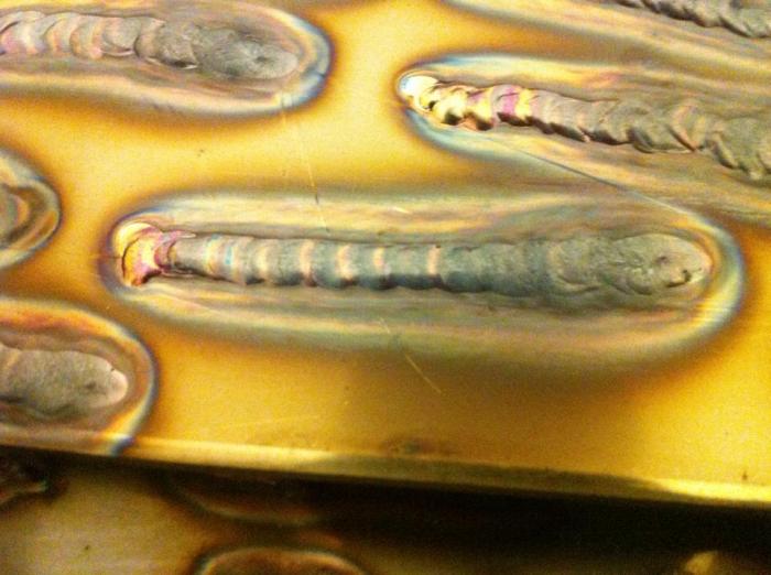

some ss from today

some ss from today

I was about to say you shouldn't be using 308 on steel, you should be using 309 if thats what you have and you should definitely be using the 309 when welding the tank like Greintime said and get in some good practice first.
You will never have good results if you dont start with nice shiny steel... all the steel in your pictures has not been cleaned!sshh wrote:made some practice on steel, then welded two parts this is the result![]()
