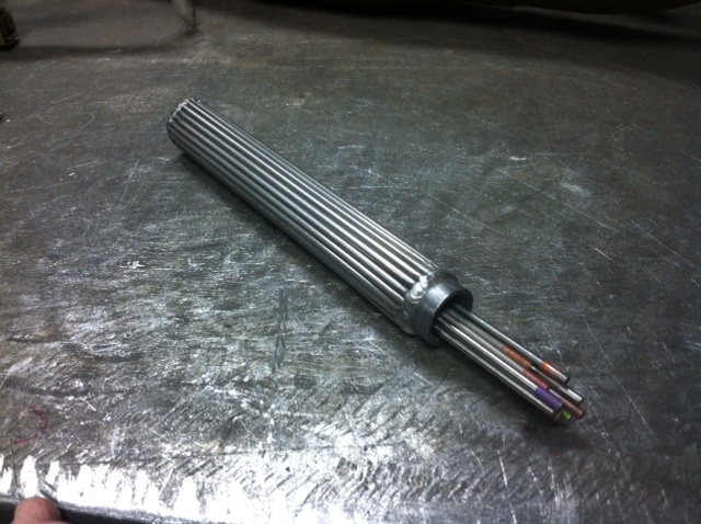

Looking around Instagram and the Internet I have found some sweet tungsten holders. It is like many projects in the welding field where they are customised in many ways and unique to the builder. Here are two that I have build, mainly for fun. The first is just 1" copper pipe and caps that I bushed in the end. The other is a copy of some I saw on the internet. I used 1/8" 308 SS filler cut in 7" lengths and a 1986 (birth year) quarter on the bottom. To make the "tube" out of the filler I rubber banded them around a pipe and fused the ends. I intend to brush finish this one as well. The next one I want is a billet alum one made by a good friends machine shop.

Superiorwelding wrote:The next one I want is a billet alum one made by a good friends machine shop.
Do I sense a Jedi light saber inspired design here ? 8-)
The stainless one looks great. Wouldnt some brass look really good on it too? ;)

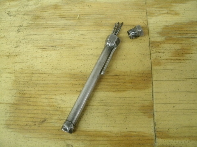

I thought I'd add mine. This was an early TIG project for me, and I still use it. Built from 1/2" .049 SS tube and swagelock fittings, and the pocket clip is a bit of 1/8" TIG rod with the end balled.
