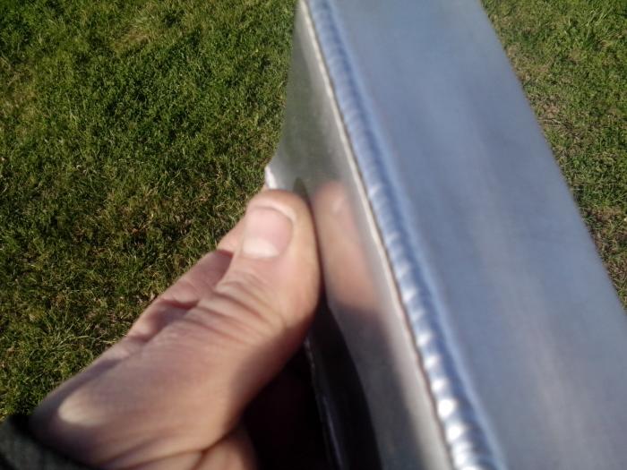

When welding aluminum I always get a balled end. Is this normal? 30% cleaning, 120 freq. 2% lanthinated sharpened to a point. Welds look great! Machine set at 75 amps. thanks for any help john.

Is it objectionable? Are you using a machine you can't tweak the settings such as a Diversion? I grind a very blunt point. It produces a narrow arc. bump up one size tungsten if it's a problem.

thermal arc 186 lots of settings. Miller welding video shows a guy sharpening to a point and keeping it like that throughoput the weld.
Hollywood...I have a new Miller Syncrowave 210...inverter... I use 1.5 lanthanated it always balls. It is still relatively sharp but always gets a small ball at the tip. I dont know if its possible to keep a sharp tungsten on AC

I appreciate the info from everyone. I see people purposely balling the tip on dc but it just happens on ac for me.
Looks like you got it nailed. I have heard Jody say that he starts with a shap tungsten and let it ball as it may so that what I do and it works great. Jody explains how to ball tungsten on one of his vids but I don't bother. You should see pure ball up on a transformer. Your welds look great!

I have an HTP Invertig 221 and I sharpen to a sharp point also on A/C, usually 3/32 2% Lanthanated and it will form a small ball at the end after a while. As long as the ball stays small and the bead narrow, I just leave it. The arc stays very stable even with slightly balled electrode.

Nothing wrong. Don't let the ball get bigger than the diameter of the tungsten. Set post flow to keep tungsten clean. Consider larger tungsten, and blunt grind. Consider a water cooler & torch, nice anyway, they are smaller. On very clean aluminum you'll do very well as high as 80% EN,

I just looked at the tungsten and the ball is the same size as the tungsten and there is no more taper. Should I have blunted the tip more.
