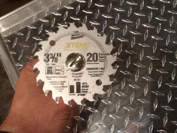

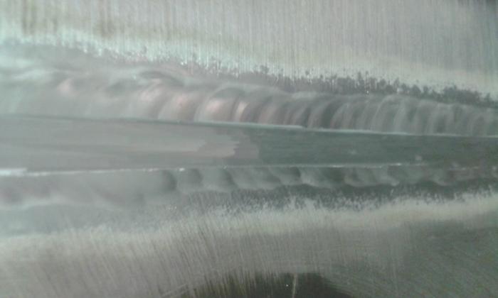

I wanted to share this thoos who weld Aluminum and having porosity on previous welds or a grinding dust on flapwheels is cousing gray hears on X-ray test. I dont know is thees blades used any where else???

suicide saw (probably not real name) used for back gouging Al. I actually did some work for a place where one of the employees had removed the blade guard. that makes removal of guard on grinder with a grinding disc seem minor.
tested once, 3G/4G and each booth had one in it.
I use a 7 1/4 inch circular saw to remove aluminum all the time. standard 10 dollar blade.

I had never seen one before. My curent job is welding new and repairing old oil/chemical containers. And often time old craks are full of all kind of contamination. And there this blade is useful because it leaves that AL surface so shiny so i can spot every litle hole/porosity. But you are right about its dangerous tool if its not used right. Allways helmet on and prefure to use air grinder when i can adjust my rpm.

I've used the smaller wheel on an electric die grinder to do similar work. It was on a vaporizer coil for liquid Nitrogen and I couldn't get any other kind of grinder into where it was cracked, worked very well. Yes it was nice to have a speed control on the grinder because it gets a little unwieldy to say the least. No blade guard, but it was 8" from my hand while I was using it. That job ended with the nicest mirror weld I've ever done.
Just FYI, a cutoff wheel goes through bone without even slowing down. Ask me how I know. Blade guards are a wonderful thing.

I use a similar set up on my air die grinder.Aleksi86 wrote:I wanted to share this thoos who weld Aluminum and having porosity on previous welds or a grinding dust on flapwheels is cousing gray hears on X-ray test. I dont know is thees blades used any where else???
I bought a toe-kick saw blade (smallest I could find), the hole was too big so I drilled it a little bigger to accept a reducer bushing.
Works super excellent, but is even more dangerous than any grinding wheel.
The ability to feather the throttle and take very controlled amounts of material off is awesome.

I usually dont use it if the grinding place is abowe my head or uncomfortable, because when it bites too deep you need good grip to your grinder.. I Mig AL bretty often butt joints weld both sides and porosity comes so easily on Mig AL and welds mostly x-rays so gettin layer by layer that root opening clean. Flab disc loads thoos "tiny" porosity holes so i cant see them..
