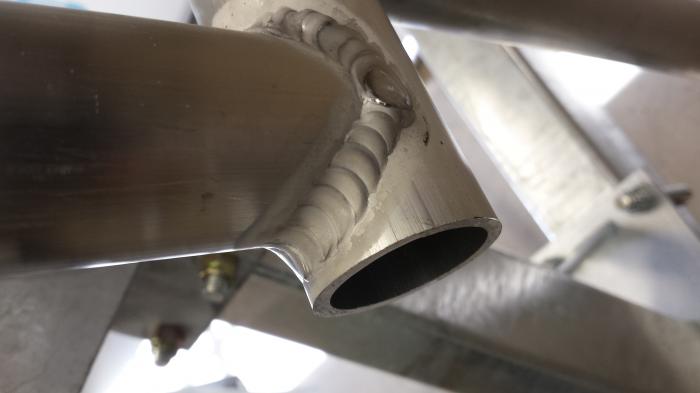

All that I will tell you is that I am using a fairly high pulse setting-I'm sure some people will ask why I am using pulse for aluminum with filler.
- lllll.jpg (54.64 KiB) Viewed 1220 times

Me too, when welding Aluminum I often use pulse on both TIG and MIG. I have to also guess that manufacturers put it there for a reason!
Your welds look pretty good
Trevor
Trevor

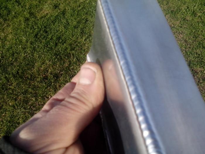

I manually pulse on aluminum with the foot pedal to get welds like these. 6061 aluminum
. Anodized is a whole different animal
- aluminum tig.jpg (21.78 KiB) Viewed 1156 times

Thanks for the replies. It's nice to know others are pulse welding aluminum. I was under the impression you should not do that. John
If you have pulse available, DEFINATELY use it on aluminum. I suppose once you're past 3/16" thickness, it matters little, but if you're welding sch. 5 aluminum pipe, pulse is your friend!Hollywood1 wrote:Thanks for the replies. It's nice to know others are pulse welding aluminum. I was under the impression you should not do that. John
