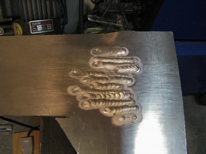

My new Tig welder arrived this week, :D its a Jasic wse200p (made in china). I've never used a tig before, so while waiting for the machine to arrive, I spent my nights watching Jodys fine videos to get me started. Set up the machine today, got the hang of what all the knobs did, so here is a couple of pics of my first go at padding beads....... yes on aluminium.
Yes well, plenty to learn yet ;)

Nice! I had close to the same results. Picked up some of Jody's DVD's and had an idea on how to go about trying to tig weld. Looks like you will only get better.

Big mistake you are making. Don't run multiple beads one after the other on the same piece of aluminum. It pre heats fast and you will constantly have to adjust multiple welding parameters to compensate for the pre heat from previous beads. Make a dozen 2"x 6" coupons. Weld a bead on the first one and set it aside. Repeat on the next coupon until you have done all the coupons and now repeat starting with first coupon that will now be cooled off. Repeat.... This way you don't have to adjust amps, travel speed, filler rate etc. Learn correct, consistent technique first. Also run full length beads and learn to feed the tig rod

soutthpaw wrote:Big mistake you are making. Don't run multiple beads one after the other on the same piece of aluminum. It pre heats fast and you will constantly have to adjust multiple welding parameters to compensate for the pre heat from previous beads. Make a dozen 2"x 6" coupons. Weld a bead on the first one and set it aside. Repeat on the next coupon until you have done all the coupons and now repeat starting with first coupon that will now be cooled off. Repeat.... This way you don't have to adjust amps, travel speed, filler rate etc. Learn correct, consistent technique first. Also run full length beads and learn to feed the tig rod
Good Point Southpaw ;)
Aluminum beads will tend to deteriorate or least look bad when the base metal gets to hot. This has been my experience at least. :) I believe Jody has a video stating this, something about even cooling off with a air compressor after it gets to hot.
Excellent tips, cheers
