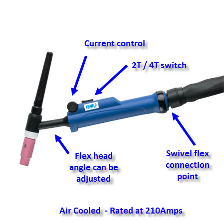

I should have clarified. The torch switch is absolutely fine. The thumb-wheel control compared to foot-pedal control is where the foot pedal is much easier. Again, it depends if you're sitting at a bench or standing. Foot-pedals are quite difficult to use unless you are seated.crouchy wrote:Thanks guys, will punt the hand switch back and practice using that. Thumb wheel control you say? What make of touch do you have trackranger??
I'll try and get a photo of the torch later today
- TRACKRANGER
Location:Melbourne, Australia
Here it is:
- TIG torch.jpg (41.62 KiB) Viewed 2311 times
