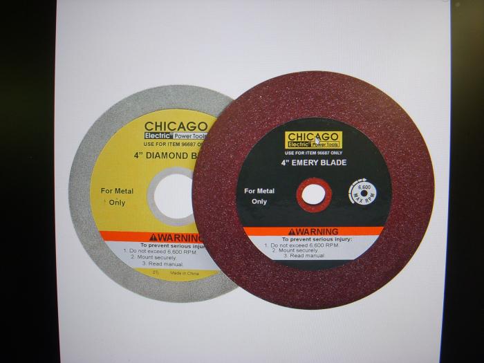

There are also the little 4.5 or 5" diamond edge wheels available at the Chinese toy/tool store for about $10, as I've seen mentioned it one of the threads here.

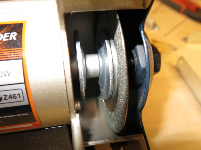

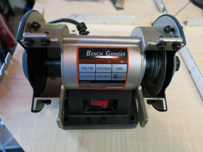

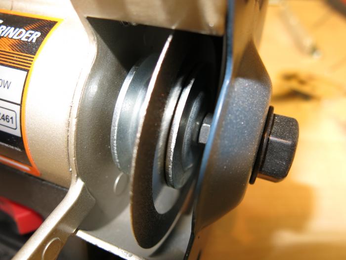

Cheap grinder, juggled the disks and washers, works perfectly, the edge has enough diamonds to cut / notch the tungsten. I grind to shape using the (90 deg to the tungsten) rest, and finish with the tungsten held near vertical.
- Remove the other disk, and juggle the bits.
- IMG_1074.JPG (41.67 KiB) Viewed 2614 times
- Cheap diamond disk, 3 for $20, 10mm bore.
- IMG_1073.JPG (37.41 KiB) Viewed 2614 times
- Remove one disk
- IMG_1072.JPG (34.11 KiB) Viewed 2614 times
- $60 mini grinder
- IMG_1071.JPG (40.24 KiB) Viewed 2614 times
