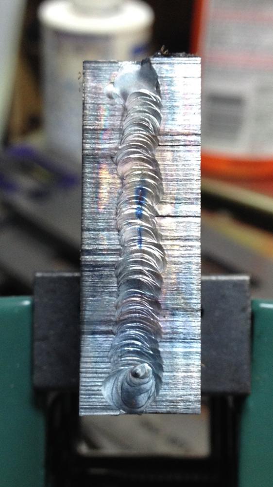

I've been enjoying my stock size 17 torch, able to do what I needed with it. Recently I purchased a stubby gas lens kit for it, and discovered that I need to re-learn how to tig weld. First thing I noticed was that the same regulator setting was causing the arc to be "blown" for a lack of a better term, my Tungsten no longer staying as clean, and the weld puddle to be much wider, along with the arc. The cup size is a #8 on the stubby kit, much wider than the stock cup with the stock 17 style setup.
I turned down the gas regulator, and fixed the arc issue, but now my work piece is covered in brown oxidation. I suppose I need to turn up the post flow to fix that? Also, how much electrode stickout should there be? I am tempted to go back to the stock setup

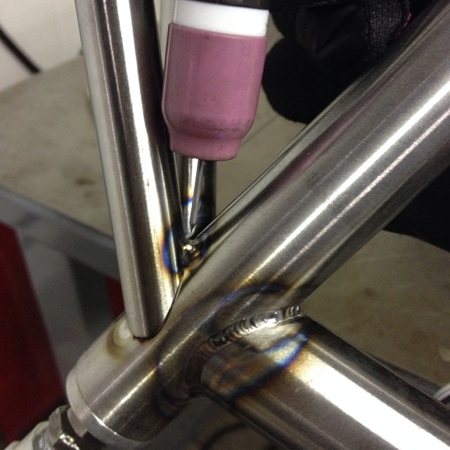

I very seldom use anything but a gas lense unless I'm working on aluminum then I go back to a regular cup. On my my 280DX I normally switch between a number 6 and 7 gas cup depending on what material I'm working with, and my stick out is always just enough to see and get into what ever joint. I usually run my argon around 12 to 15 cfh, if your getting oxidation after you complete your weld I would say turn up your post flow a bit

as a noob (still am) I welded with a conventional collet body for a couple weeks, then switched to a gas lens. Overall, better, smoother arc, and eventually I turned my gas flow down just a tad, too. Is your lens good and clean?

Hope the experience improves with use. My gas lens just improved everything by, oh, 10 percent or so, it seemed to me. I'll admit that I'm so new to this that maybe some of it is psychosomatic, but the one thing I'm sure of is that those odd times when I used to get a brief flare up or pop, even holding great angle and arc length, have gone with the lens. I am confident that the better and more stable gas coverage has helped.

Typical stick-out on a gas lens should not exceed 6X the tungsten diameter (3/4" for a 1/8" tungsten, or 9/16" for a 3/32), though it often has to. Pay attention to your torch angle, as well. The laminar flow from a gas lens can actually increase the air draw behind the weld if you get too steep and aren't moving fast enough.

Make sure you're using the proper neoprene "washer" behind the ceramic cup. Sounds like you're getting atmospheric gases pulled in.
None of my welds with cold rolled 1018 ever have had the pretty colors. Always a dull gray. I am on the road right now, won't be until Tuesday that I get to try to play with it again. My tig cup has no Neoprene washer, just that white plastic heat sheild
Yup thought so too. Check leaks from your torch. With gas lens you should not have any problems at all, specially if you have setted the amount of argon flow right.Welder2008 wrote:Make sure you're using the proper neoprene "washer" behind the ceramic cup. Sounds like you're getting atmospheric gases pulled in.
I recommend to do a little test with clean stainless steel. Steel can be used also.

I suppose you have cleaned the parts before welding. Mill scale and cutting oils will affect to welding a lot.
Your welds really look like there is oxygen or dirt in the puddle. Remember that cutting oils etc contains oxygen and also moisture.
Also did you weld agains the table. From the picture it seems that table's coating (zink or whatever) have been burned off and it went right in the weld!!
- IMG_0329.jpg (31.03 KiB) Viewed 4316 times
-Markus-
I did not clean the pieces before welding. The zinc coating on the table, that was from when I first got the table and welder, and discovered quickly my error. I welded the pieces on top of a 1" thick aluminum block. In the photo, they were placed for a quick photo after the fact.
While this does not make sense to most people at first, a leak in your gas line anywhere between the flow-meter and the torch (actually, anywhere before the arc, like a broken o-ring on the back-cap or the Teflon gasket already mentioned, will draw air in when welding, rather than leak gas out.
You have a very slight positive STATIC pressure in the line, because of drag/resistance to gas movement. However, you have a fairly strong negative DYNAMIC pressure due to the flowing gas. Dynamic pressure is powerful enough to lift a 747 off the ground, and will definitely suck air in to your gas line.
The gas lens will magnify this problem a bit, because it flows gas better than the standard collet, further reducing that slight positive static pressure in the line.
I'd fix the known leak, then check the back-cap o-ring on the torch, and make sure the Teflon gasket(s) are in the right orientation and tight between the cup and torch. Take the tungsten out, put your thumb over the cup, pressure up the line a bit, and soap-bubble test everything from the flow-meter to the head of the torch, and I'm guessing you're going to find something leaking in the circuit. If you have the machine controlling the gas (rather than a valved torch), there can even be a leak inside the machine in the solenoid path.

Hello, I went home after the last trip and did a couple of things. First thing I did was install a higher quality potentiometer in the foot pedal, and tweaked it so the lowest point it turns on, gas is flowing, to protect the tungsten, and I stopped using the stubby cap on my torch. Turns out, the collet couldn't be engaged by the stubby cap because the brass threaded portion was machined too short, keeping the collet from tightening properly. I had the collet in backwards before to make it work, sort of.
I will machine a little spacer that will fix the issue, but the standard length cap has no such problem.
After making these two tweaks, the gas lens works MUCH nicer, keeping the electrode nice and clean, and my welds looking cleaner. Still haven't tracked down any more leaks.

Gentleman, I am happy with my gas lens and welder, thanks for the help. I just did this fusion weld, no real prep has been done other than a fresh bandsaw cut. My electrode is staying shiny, and now I am getting colors!
- fusionWeld.jpg (70.03 KiB) Viewed 4249 times
getting there
