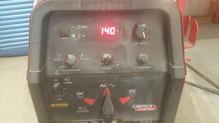

I was trying to get some practice in yesterday on some 1/8" aluminum plate and just could not get a puddle and the arc was going everywhere. I checked my settings and all were correct. (125-140 amps on AC with 15 on the flow). I was using 2% thoriated 3/32, with 1/16 filler and a #8 cup. I noticed after several tries and re-checks that my bottle was a little on the low side. Down to about 20 on the gauge. The flow seemed ok...

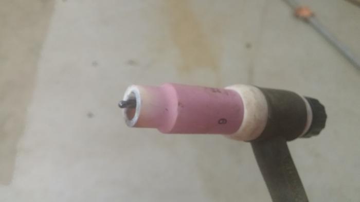

When I took my welding course, we did something with the tungsten to make a sort of round blob on the tip to weld aluminum, but I don't remember exactly what. Can someone remind me what that is? It was like we just ran an arc over the work or some steel and the tungsten melted into a sort of sphere.
Is your tungsten set up that way?

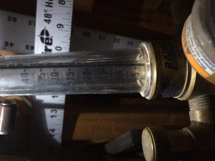

Ok guys, not much change since last night...
I decided to give you all a look at my machine settings and the results. Don't really know where to go from here?

The gauge you have is a Borden tube style. The scale on it may read 15 cfh but ti can only sense pressure. That is why most people switch over to a floating ball gauge it shows flow.

Switch to or add a floating ball and you will see actually what is flowing. You can also find a floating ball gauge that you just hold over the end of your gas cup to read flow that might be a cheap option.

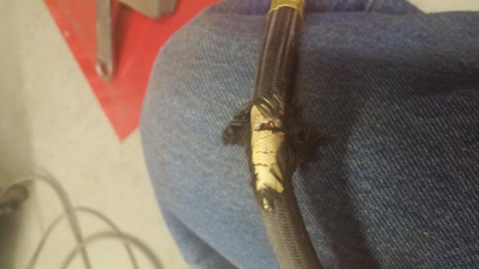

I found the problem! My hose has cracked and it's leaking gas at connection.
Now just have to buy a new hose...

Thanks Josh for keeping me on the right track with the gas flow! I knew something was wrong when I changed the gauge and the problem didn't change. I then went to the solenoid and made sure it was working.Poland308 wrote:It's always a relief when you can pin point a problem. At least hose is cheap.
While I was down there, I could hear gas escaping from the connection. Upon further inspection, well, you see what I found.
A new cable/hose is $90 from Lincoln. Not bad.

I got my new hose, hooked it up, flipped the switch and struck an arc. All is good in TIG land again!
Thanks for all of the comments and advise!
