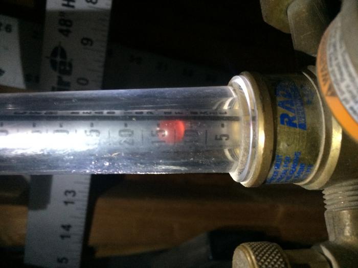

Just a note that I am a noobie at tig
I was trying to get some practice in yesterday on some 1/8" aluminum plate and just could not get a puddle and the arc was going everywhere. I checked my settings and all were correct. (125-140 amps on AC with 15 on the flow). I was using 2% thoriated 3/32, with 1/16 filler and a #8 cup. I noticed after several tries and re-checks that my bottle was a little on the low side. Down to about 20 on the gauge. The flow seemed ok...
Will that cause an unstable arc?

Yes, this can cause issues. If there is any moisture at all in your gas, it will rear it's ugly head when the bottle's nearly done. I assume you've been using the same setup for a bit, in the same way, and the trouble is new? If so, the gas is very likely the culprit.

Ok guys, not much change since last night...
I decided to give you all a look at my machine settings and the results. Don't really know where to go from here?

Was the regulator reading 15 cfh during a purg cycle or is that all the time?

by jonesk0668
During the purge.

The gauge you have is a Borden tube style. The scale on it may read 15 cfh but ti can only sense pressure. That is why most people switch over to a floating ball gauge it shows flow.

Your gauge may indicate 15 cfh but you might not be getting 15 cfh at you rig.

You may have a restricted solenoid or gas passage. Your photos indicate a gas issue no question about that.

I can hear gas coming from the nozzle...
Maybe like you said, not getting the 15 at the rig.

Switch to or add a floating ball and you will see actually what is flowing. You can also find a floating ball gauge that you just hold over the end of your gas cup to read flow that might be a cheap option.

I found the problem! My hose has cracked and it's leaking gas at connection.

Thanks Josh for keeping me on the right track with the gas flow! I knew something was wrong when I changed the gauge and the problem didn't change. I then went to the solenoid and made sure it was working.
While I was down there, I could hear gas escaping from the connection. Upon further inspection, well, you see what I found.
A new cable/hose is $90 from Lincoln. Not bad.
I'll be sure to post an update when I get the new hose.

I got my new hose, hooked it up, flipped the switch and struck an arc. All is good in TIG land again!
