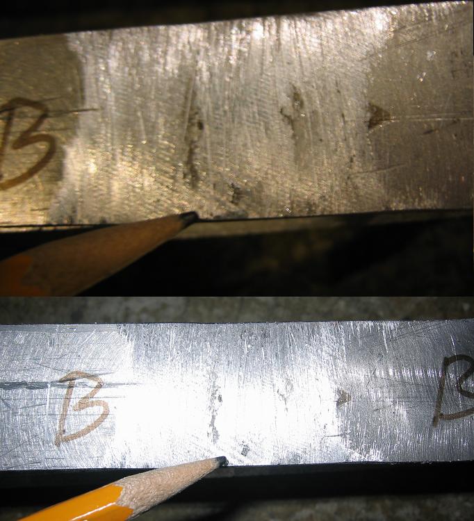

I was welding over the top of a customer's aluminum welds he said he "did at work", and I think he was using this "lay tung" method Steve speaks of.sschefer wrote:LOL,, I thought that was the tung lay method.... Seriously... not...
I was filing down some of the material I added to make the joint "disappear", and it was the first time I've ever hit a spot that hard in the middle of soft aluminum with the file. I am actually concerned that I wrecked my nice files.
I've never seen anything like it. You can see the spot appearing a little darker than the surrounding aluminum in the pic (its just in front of the pencil tip.) I decided to carbide burr it out completely and deposit fresh aluminum in its place.
- IMG_0005.JPG (89.05 KiB) Viewed 2343 times
If I'm seeing correctly he spit a tungsten then burned back over it trying to burn it out. Squirt a little WD-40 on your files next time and you'll blow right through it.
