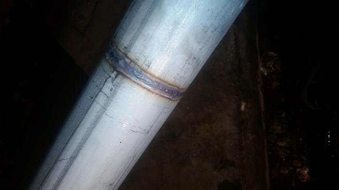

This isn't the cap of course but it looks the exact same . I think its a gas issue. Im running 30 to 45 cfh and can barley feel the gas coming out the lens .
- 20160122_140047.jpg (18.55 KiB) Viewed 5086 times
Location:Orlando FL
30 to 45 cfh is too much, should be 15 to 20, check for a leak at all connections, or a pin hole in the torch hose.duckhunter27 wrote:This isn't the cap of course but it looks the exact same . I think its a gas issue. Im running 30 to 45 cfh and can barley feel the gas coming out the lens .

To Me it looks like you didn't prep the pipe properly before you started. When I do a pressure weld I take all the mill scale off inside and out so I don't drag the scale into the weld. Are you purging the inside??

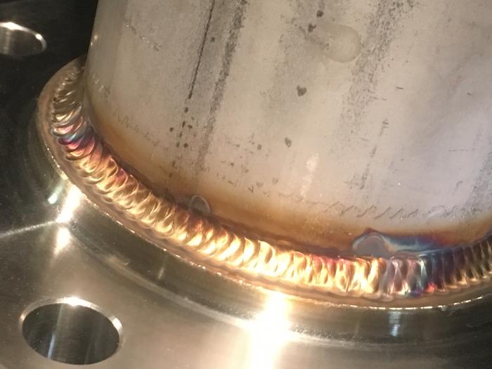

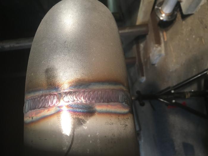

Yes I'm purging with a purge balloon,also having this problem when doing the tie in , it doesn't seem to want to flow , it just balls up .
- image.jpeg (57.75 KiB) Viewed 4875 times
- image.jpeg (40.52 KiB) Viewed 4875 times
- image.jpeg (36.21 KiB) Viewed 4875 times
Location:Orlando FL
It looks like when you stopped you didn't get good gas shielding, so when you resumed the weld the filler didn't want to flow. Perhaps your post flow is too short or you're removing the torch before the weld has cooled.duckhunter27 wrote:Yes I'm purging with a purge balloon,also having this problem when doing the tie in , it doesn't seem to want to flow , it just balls up .

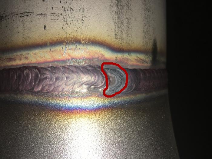

Before starting you'll need to clean this
- image.jpeg (76.18 KiB) Viewed 4858 times
There may be a couple of things that are going on. The contour of the bead seems a bit erratic which could indicate you are struggling with consistent travel speed and controlling the puddle.
I would concentrate more on the shape/appearance of that weld more than the "color".
Get in a position is which you can move the torch around the pipe comfortable and consistently, even if its just for a 30-60 degree section.
Just an opinion to add to some of the other good ones provided.

Now that I see some other pictures, removing the oxide layer from around your weld area can also help with the bead wetting out. Clean em up some if you are looking to improve the appearance.

after I stop I leave the torch on the weld till the area isn't glowing red any longer , I'm using a 26 style flex neck with a valve so it pouring gas at a rate of about 45 to 50 Cfh due to I'm in an extremely drafty basement , thanks again for all the adviceLtBadd wrote:It looks like when you stopped you didn't get good gas shielding, so when you resumed the weld the filler didn't want to flow. Perhaps your post flow is too short or you're removing the torch before the weld has cooled.duckhunter27 wrote:Yes I'm purging with a purge balloon,also having this problem when doing the tie in , it doesn't seem to want to flow , it just balls up .
That is a little weird, I can see a pretty consistent walking pattern, then it goes into the weirdness. What's the purge pressure?
Looks like the torch angle is off in that area. Is it always the same position on the piping?

Rick H it's generally where there is a a stop and start at , i wish I could video it for you guys to show you . It literally looks like it balls up and doesn't want to flow in just ball up . The purge pressure is around 10 to 15 . Yes always same position, I'm sure it's the operator and not material just wanna figure it out before it drives me insane lol .
Once you have the joint almost welded you could probably back down on the purge. I've had a few times I've had someone actually shut the purge off just before I close the last of the gap.
Poland308 wrote:Once you have the joint almost welded you could probably back down on the purge. I've had a few times I've had someone actually shut the purge off just before I close the last of the gap.
Kinda my thoughts too but depending on the length of the pipe and vent hole those flow #s don't seem to far off. Ive had to back my purge down on some sanitary stuff for the same reason, but its no filler. Since this is pipe with a root, fill and cap I'm skeptical the purge is the issue but figured Id touch all bases..lol
Since it is where a start and stop is maybe its contamination but the weld doesn't look horrible. If you are brushing well try running past your start/stop another 1/2" or so and see if it follows.
