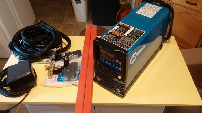

This came in today.....cant wait to finish cleaning up my cooler. I picked up-Bernard 3500ss almost new for $200. CK 20 torch...pedal... loads of filler rod....anticipation ...trip to sLowes for a plug head. The adventure begins

Looks good, where did you buy this from? Keep posting the picsjumpinjackflash wrote:This came in today.....cant wait to finish cleaning up my cooler. I picked up-Bernard 3500ss almost new for $200. CK 20 torch...pedal... loads of filler rod....anticipation ...trip to sLowes for a plug head. The adventure begins![]()

I ordered it from cyberweld...had 2 units in stock. No one else had them on hand at the good price and free shipping. Hours of study and notes kept taking me back to this machine. Pix later as I get things up and running Saturday...supposed to be a little cold...19 and windy. The wife is not impressed with it in the kitchen...

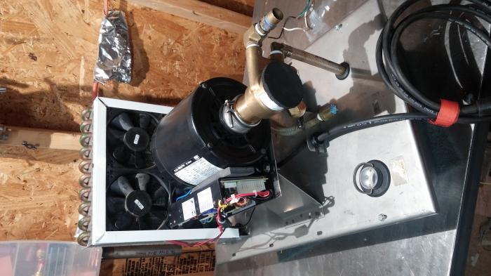

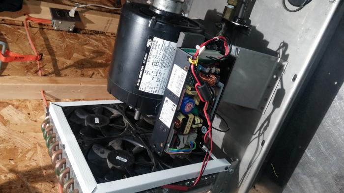

This is what happened to the cooler today. Too loud for me to stand...4 muffin fans...14 vdc power supply...some foam between tank and motor to keep the tank from drumming. You can hear the fans run and a low hum of the pump motor. I glued a piece of foam over the end of the pump to snuff out that noise...helped a lot. Welder getting plugged in later...All mods to cooler can be undone and returned to factory state within an hour. The power supply is adjustable from 12.8 up to 18 volts....so I have plenty of cooling if needed .. it is set now to lowest level. Will check temps when I think it may be getting hot.

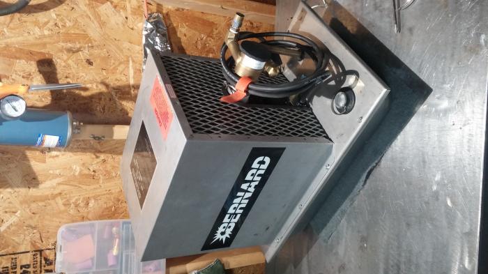

All done and no one the wiser...until it is powered up...how nice and quiet

Curious, why did you mod the recirculator?jumpinjackflash wrote:This is what happened to the cooler today. Too loud for me to stand...4 muffin fans...14 vdc power supply...some foam between tank and motor to keep the tank from drumming. You can hear the fans run and a low hum of the pump motor. I glued a piece of foam over the end of the pump to snuff out that noise...helped a lot. Welder getting plugged in later...All mods to cooler can be undone and returned to factory state within an hour. The power supply is adjustable from 12.8 up to 18 volts....so I have plenty of cooling if needed .. it is set now to lowest level. Will check temps when I think it may be getting hot.

Is that Bernard TIG Cooler new or used?jumpinjackflash wrote:All done and no one the wiser...until it is powered up...how nice and quiet
