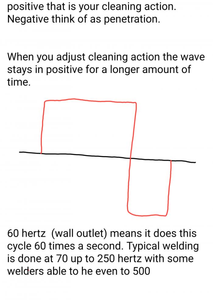

dirtmidget33 wrote:I should add I thought you where modding a welder that never had a.c. or high frequency. I have no experience with airco welders as for what they came with originally.
Here is a quick overview of sqarewave though to help you understand it. modern AC and I believe yours too use it. MinnesotaDave would know. Changing this wave form is what gives us some fine adjustments making welding aluminum easier. There is newer wave forms coming out like trangular and such on inverters like the dynasty. Knowing how this works makes it easier to adjust balance and frequancy settings.
- 1.jpg (48.13 KiB) Viewed 1932 times
- 2.jpg (64.01 KiB) Viewed 1932 times

For the record Wallace, Square wave is not a sine wave, and is created by giving a "mechanical push" to get the switch from positive and negative as short as possible. It's not truly a square wave either as it isn't instantaneous, but it's close enough by most people's standards!!! It's like using a hall effect sensor on your crank versus a reluctor wheel and a mag pulse generator to generate a signal. Both accomplish the same thing, one has just been around way longer than the other.
On newer machines, they accomplish it using semi conductors (transistorized circuits, either MOSFET or IGBT, although everyone is switching to Internally Gated Bridge Transistors if they haven't already done so. They last quite a bit longer than their counterpart) to provide "instantaneous" switching from positive to negative. Because a microprocessor controls it, they have features like amplitude control and all of the other stuff because they are using pulse width to control the amplitude of the waveform as well as the frequency in a cycle that it stays at one end or the other.
