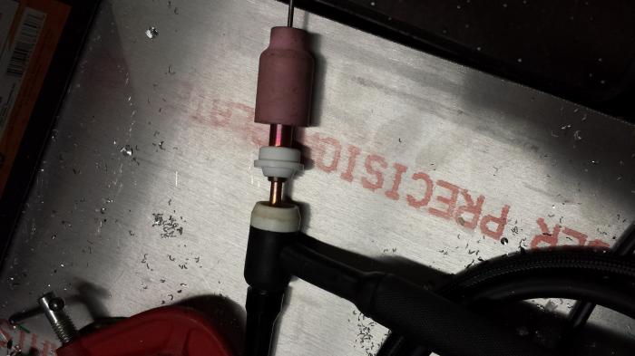

When welding 1/4 inch (6.4mm) Aluminium with AC TIG using a gas lens and 3/32 ( 2.4mm) Tungsten the Front often breaks off my Ceramic Cup. I'm using a no. 7 Cup with a 3/32 Electrode 2% lanthenated with about 1/4 inch stick out, A nice little bit of balling at the tip and about 15cfh of Argon flow at about 150 amps AC. I've bought what I think are good quality cups but about the first 3/16'' or 4mm of the cup just drops off in a perfect ring, no impact, no dropping of torch. What are the possible causes and solutions for this? All replies greatly appreciated.

Do you have this style torch ?
Are you using both Teflon insulators ?
- 20160315_202531.jpg (34.93 KiB) Viewed 5671 times
I bet Kevin Holbrook is correct - you are likely missing the extra little insulator.
I was missing it when I got my first gas lens/cup and the front popped off like you describe because it tightened against the front of the gas lens.

Hi Guys thanks very much for your replies. I was only using one of the white insulators. I found initially when I put both on I had trouble clamping the electrode. But obviously I will now use both insulators. I really appreciate the feedback, it's great to have really good information from experienced professionals, I hope I can add to this great forum. Cheers
Sometimes the tungsten doesn't clamp down because the collet body is not screwed in all the way.MotoEngineering wrote:Hi Guys thanks very much for your replies. I was only using one of the white insulators. I found initially when I put both on I had trouble clamping the electrode. But obviously I will now use both insulators. I really appreciate the feedback, it's great to have really good information from experienced professionals, I hope I can add to this great forum. Cheers
Always loosen the back cap a little before screwing in the collet body - it has to tighten all the way and bottom out.
If you are only using a gas lens, you can also get a longer single insulator, from CK at least.
I was chasing a leaky torch and replaced the insulator stack with a single as part of my attempt at tracking the leak (which turned out to be just a junk knock off torch body...)
For a 26 style torch, the combined insulator is a 3GHS.

While that is true, when not using the correct insulator they can break within the first hour - that's a little too fastexnailpounder wrote:News Flash....Cups break!

If you read the OPs post, he is welding 1/4" aluminum which means hes probably at around 200 amps or more and using a #7 cup with 1/4" stickout. He doesn't say how long of a bead he is running but with 1/4" stickout he has the cup right ontop of the puddle. Of course it's going to overheat and crack off. Longer stickout and a bigger cup and maybe bump up the flow a little might help. Just my opinion.

he was missing an insulator adapter for the gas lens.exnailpounder wrote:If you read the OPs post, he is welding 1/4" aluminum which means hes probably at around 200 amps or more and using a #7 cup with 1/4" stickout. He doesn't say how long of a bead he is running but with 1/4" stickout he has the cup right ontop of the puddle. Of course it's going to overheat and crack off. Longer stickout and a bigger cup and maybe bump up the flow a little might help. Just my opinion.
if you don't use the second insulator adapter or use a one piece insulator for a gas lens setup
when you screw the cup on ,it will bottom out on the gas lens.
Yep, that's exactly what happened to me - screwed it on without the proper second insulator (or correct thicker one piece) and the cup bottomed out on the gas lens - broke real fast - just a few 9"-12" beads.Kevin_Holbrook wrote:he was missing an insulator adapter for the gas lens.exnailpounder wrote:If you read the OPs post, he is welding 1/4" aluminum which means hes probably at around 200 amps or more and using a #7 cup with 1/4" stickout. He doesn't say how long of a bead he is running but with 1/4" stickout he has the cup right ontop of the puddle. Of course it's going to overheat and crack off. Longer stickout and a bigger cup and maybe bump up the flow a little might help. Just my opinion.
Put on the right stuff - 230 amps AC and no problems
