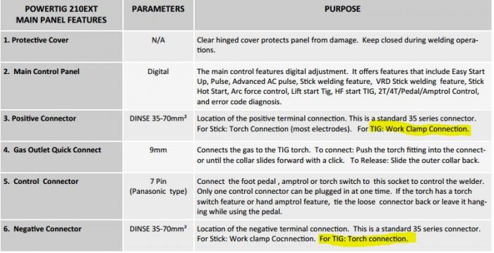

I just purchased a brand new Everlast Power TIG 210EXT.with IBGT Inverter...it came with two torches in the box; W9, and W20 Air cooled...also got a gas lens kit from the Weld Monger Store.
I couldnt wait to start playing with the pulse, high freq. square wave etc. functions...I started out modest; just some stringer beads in DCEN mode (No pulse yet) on 11ga cold rolled steel, I thought to myself "man this is going to be fun"......to my surprise its been a frustrating struggle to say the least...
Now, by no means do I consider myself a pro TIG weldor...but I'm no "rook" either....I've had a TIG torch in my hand quite abit, and have cracked out some really decent joints. Also, my back ground was started in Tech school with an acetylene torch for an entire semester just learning how to make a puddle and add filler, they drilled that into us really well before even touching a welding machine. Then advancing up to overhead SMAW.
So, back to the drama... I started off with the W9 and a 3/32 tip (2% Lanth) with a shapr tip, standard collet, and 3/32 70s2 rod.
Settings were: 2T, main amps 70, preflow 2 sec, up slope 0, down slope 0, post flow 4 sec... @ 20 CFH pure Argon.
Struck up an arc and watched my brand new tungsten disappear before my eyes!!!
Checked all connections, and ran some purge for about 1 minute, made a few adjustments, put a new tip on the tungsten, tried er again...wide cone arc which was dancing around and singing like Fred Astaire !!! brown smokey crap and spatter everywhere....looked like (as Jody would say) "Fido's butt"
Made some adjustments to the machine, this time added the foot pedal, ran a wire wheel on the steel and cleaned with acetone, new tip on the tungsten (with 80 grit belt sander, parallel to the rod length) adjusted the gas up to 30 CFH, struck it up...ran kinda good for about 2" of travel then the end of my tungsten turned into a monkey fist!!!
OK, lets try some pulse... Time on 33, Pulse Amps 33, Hz 120.....balled er up again!!!
Changed to the W20, new gas lens, new tungsten (2% lanth), new everything...purged gas, cleaned the steel, made a few inches then spit, spat, sputter, brown smoke, and balled the end of the tungsten.....what the @#$%&%$#
I have tried just about everything I know to try...like I said before, I have done a bit a TIG welding but never with an IGBT Inverter based machine, I'm not sure if this is the difference or not but come on!!!! this is embarrassing!!!!
So, please any and all suggestions would be greatly appreciated.

Welcome, Bud! Sorry to hear you're having trouble. Just to check, what polarity are you using? Carbon steel requires DC EN, electrode negative, so your torch lead needs to be in the Negative jack.
Sorry if you knew that already.
Edit: just read the "some stringer beads in DCEN mode " part. Now I'm thinking "contaminated gas" too. Maybe you got some mis-labeled c25...?

as for the second reply....the welding machine is configured only to have the torch in the "torch +" plug, and the ground clamp plugged into the "work -" plug... when you "tell" the machine that you want to weld in DC it automatically changes polarity.

Confession time: I made that same mistake on that same machine. The torch is supposed to jack into the negative port.
Is this your machine? If you hover the mouse over the picture it enlarges. On this photo, at least (identical to my machine) it is marked just "pos" and "neg".

Check out page 32 of the manual, available for download on the Everlast site. (The manuals that come in the box are notorious for being poorly written.)

HOLY CRAP!!!!! YOU ARE CORRECT SIR!!!
I just downloaded a "real" copy of the owner manual from the web site...as I stated the cheap version that came in the box had nothing like this!
thank you for setting me straight, I guess that forum has served it purpose......I guess I shouldnt assume....you know what happens when we assume!

Since the change in polarity the machine is working flawlessly, expect for a random lack of continuity when trying to strike a high freq. arc....and the display shows trouble code 805 "TORCH SWITCH IS STUCK CLOSED/ Turn off welder immediately and check switch"
Not real sure about that but dosent seem to be a huge problem....
