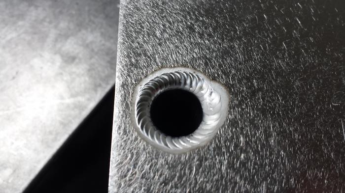

If you can, turning the frequency down helps too. Here's a pic of when I was goofing around with frequency. The narrow bead is 200 or 400 I forget now, the wide is like 40.

Wide bead width with little backside fusion can be a result of AC frequency and/or EP/EN percentage.
  • AC Frequency
    • Lower = Wider bead with less penetration
    • Higher = Narrower bead with increased penetration
  • AC Balance (with respect to bead width)
    • Higher EN% = increased penetration with a slight side-effect of narrower bead
    • Lower EN% = less penetration with a slight side-effect of wider bead.

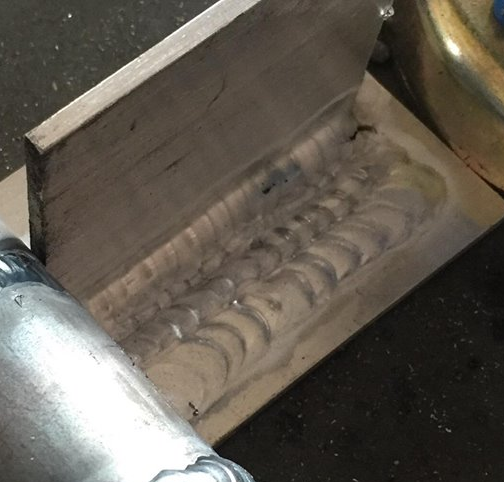

You can accomplish that appearance if you pulse foot pedal as you dip and back off quickly after or use pulse function on the machine but I prefer to manually do it, I get better timing being in control vs a machine telling you when to dip.
