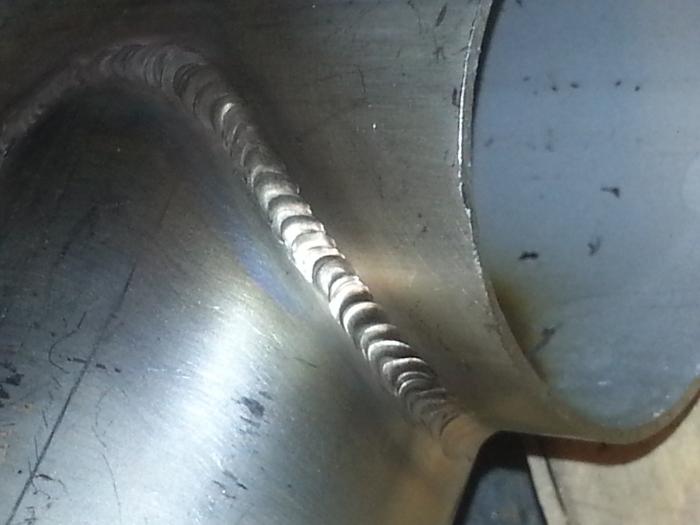

I was screwin around with some 18ga. 304 tube in preparation for a possible upcoming job.I don't tig very often.

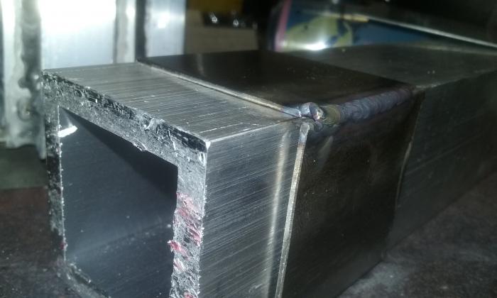

- stainless weld 2.jpg (32.42 KiB) Viewed 3655 times

That's some damn good looking welding for someone who doesn't tig often.

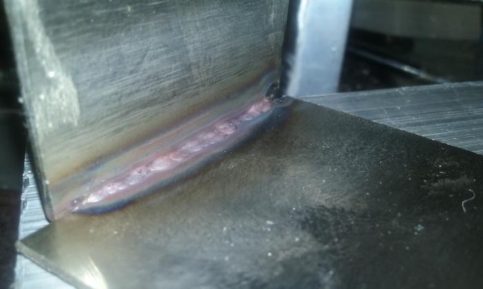

Dreaded Chinese self criticism drill:
This is my only crappy weld tonight. I had to cut with a die grinder because I can't see outside to use the chop saw.
.062 outside corner, 20 cfh, 7 seconds post flow, 3/32 - 2%lanthanated, #7 cup with gas lense, 1/16 - 308 wire. I couldn't even tack it at 40 amps due to the quench of the .250 aluminum backing tube. That's why it's peeled back on the left corner. I cranked it up to 60 amps and the wire wanted to stick in the puddle as it added additional quench. Very crappy looking weld but it did penetrate most of the back side and I believe that happened due to the filler sticking in the puddle and pulling the pieces slightly away from the backing tube. Pushing wire into the puddle would push the work pieces back up against the tubing. Rinse and repeat. I'll try using .125 tubing tomorrow because it was cool enough to pick up with my bare hands after five seconds. Never had anything cool so quickly without dunking it in a bucket of water. No sugaring is about the only good thing that I can say.
That's roughly a 2" run and it took about 15 seconds which seemed ridiculously slow to me. I was shooting for about two dabs per second but the wire sticking slowed it down to about 1.5 per second. I just couldn't move as fast as I wanted to.
I really should have twisted the backing tube so as to be able to weld flat. As it were, I had to weld in more of a horizontal position with the torch pointed down.....hence the sagging weld and undercut on the top. Didn't even realize this until I saw my bastard child out from under the hood. Cold, sticky puddle caused uneven dipping. I was too focused on fighting with the stickiness to notice much else. I thought it would eventually stop sticking but I realized after it was all over that it was never going to get any better because this stuff isn't very thermally conductive. That was one of those "Ah Ha!" moments but I will probably have to repeat it several more times before it sinks in.
It seems like there is a very fine line between hot enough to weld and overheated with this stuff.
Hopefully you guys will have lots of suggestions for what else I can expect, how to go about getting it done properly and pitfalls to avoid. I really think the biggest problem on this run was lack of heat.
Fire away and don't hold back.

Outside corner welds are a bitch on thin material, especially SS because the metal doesn't conduct heat away from the weld, Even though you used a chill bar, the heat can't get out of the way fast enough. Thats when you need to ease up on the pedal. Thicker material is easier because you kinda of use the gap as a trough to hold your filler but with thin stuff, its harder to control. I do see a couple of really pretty filets you did there.RamboBaby wrote:The largest cup I own is #8. I never use them because they make it harder to see. Everything looks fine normally.

So a pulsing technique would probably work better? I'll give it a few more amps and try that. I probably should have wiped it down with acetone since the die grinder spit oil (transmission fluid) all over it. I only wiped it with a dry paper towel.exnailpounder wrote:Outside corner welds are a bitch on thin material, especially SS because the metal doesn't conduct heat away from the weld, Even though you used a chill bar, the heat can't get out of the way fast enough. Thats when you need to ease up on the pedal. Thicker material is easier because you kinda of use the gap as a trough to hold your filler but with thin stuff, its harder to control. I do see a couple of really pretty filets you did there.RamboBaby wrote:The largest cup I own is #8. I never use them because they make it harder to see. Everything looks fine normally.

Pulse would help but I never use it. I pulse with the pedal instead. I am also a firm believer in short welds on SS because of its poor conductivity. I don't know how to explain it but I will try. Stainless sucks for conductivity. Aluminum excels at it. So you are expecting the chill bar to draw out all of the heat from the SS. It draws out some but the SS doesn't give up its heat fast enough so it builds up and the metal overheats and your puddle gets unstable and other goodies happen, A similar scenario would be when your welding on aluminum and your getting closer to the end of the piece and you see the puddle flatten out because the heat has no where to go so it builds up. If you don't back off the gas, you will blow it out. Normally you can do long runs on AL without too much trouble but getting to the end of a piece is where you can get into trouble. Thin stainless is a pain because the heat builds so fast. One second you are welding fine and the next you have a unstable puddle that turns gray and basically riuns the integrity of the metal. I don't know if that explains it but I tried
Get in and get out on SS. If you want long, pretty runs with no starts and stops, use MS. You can cook MS too. The key is using the proper amperage, travel speed etc...
