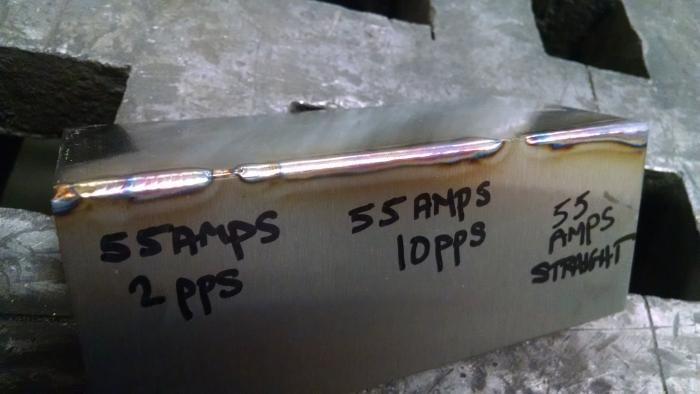

Now that I'm almost done with this project, I thought I'd post a couple pictures to share what I'm doing and how I'm doing it, and also to ask for suggestions to do it better. I can always do it better, right? When I clean it up, it suddenly looks inconsistent.
The job is welding 11ga stainless with an open corner. We are adding filler, rather than just fusing the corners. The job calls for TIG welding, so MIG isn't an option.
So far I have had the most success using pulse--my settings were 95A, .9pps, 50% on, 30% background (using miller 350). I'm holding the torch like I would if I were fusing, pointing across the corner, rather than directly into the corner. And of course I'm adding filler as I go. I've been using .045 filler.
Every guy at the shop has his own way of doing this, and now that I've been using pulse, I'm just one more guy with his own way of doing things. One guy does a "texas lace" weave--that seems enormously tedious for 100' of weld (yes that is feet!). A couple other guys just hold a 1/4" arc and jab it with filler...they've gotten good at it over the years, but it gets hot and generally looks scorched when they're done.
I'm trying to be relatively fast, consistent, and get good color in my welds. So far pulse is the ticket. But what else can I do? Would I get better results with different pulse settings? What do you think?

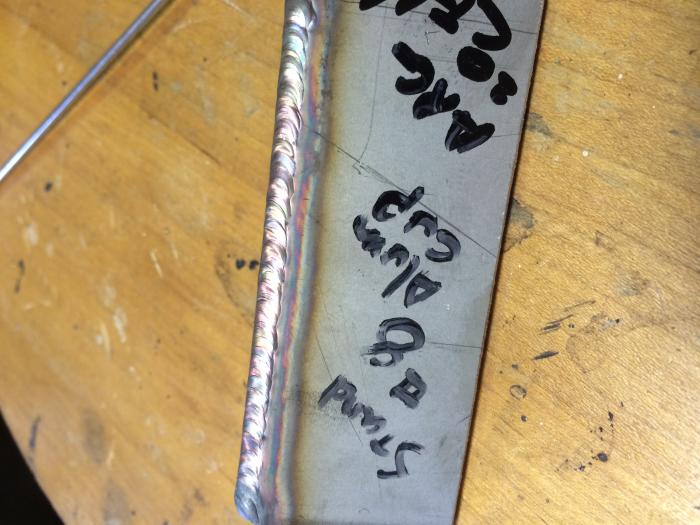

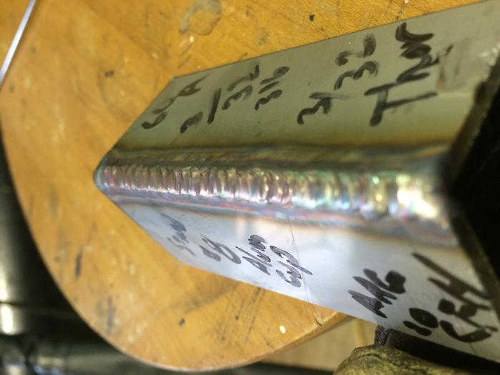

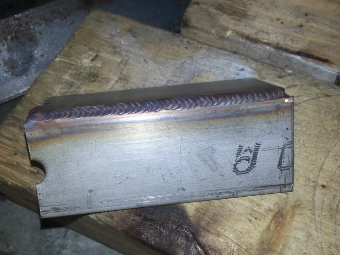

Here is my corner weld. 11ga 304 SS. I don't know how many amps I used but the machine was set at 145. 3/32" lanthanated , gas lens, 15cfh, 1/16" 308l filler....no pulse just puddled and dabbed. I just touched the tips of the corners and used filler like Rick H does. No sugaring on the backside.

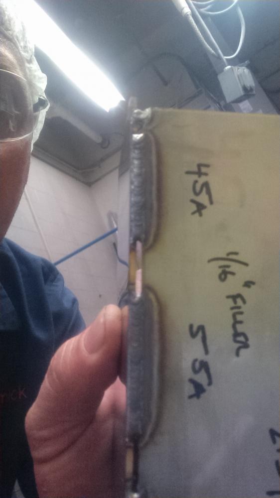

Only 11g we have is in a 8ft sheet so I grabbed some 13g scrap. I wasn't sure how much gap you had but I set my Maxstar up at 2.5pps, 50% on 50% off, 3/32" open root and with 1/16" filler, 3/32" tung gas lens #8 cup. The 3/32" filler cooled it down and I didn't want any more heat, and with a gap it sugars.
Had best success at 45-50amps. Only my front camera wants to work on my phone, guess it didn't survive falling 100ft out of my pocket..lol
If the material touches but it more of just an outside corner you can lay the wire and get a nice round beautiful edge, no sugar either

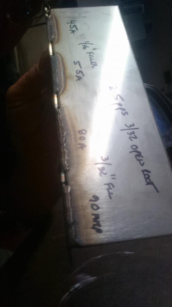

Here's another very small gap .035" filler, 50amps, 2.5pps, 1/16" tung...
Swapped to my CK Flex-loc, my reg Miller 17 was welding awful gray, new bottle too...hmm something going on.

Rick_H wrote:Here's another very small gap .035" filler, 50amps, 2.5pps, 1/16" tung...
There was no gap. There was just enough overlap to be able to easily tack the two pieces together.
I like the color on the last one...I've never had a weld look blue like that, except at the very end when I keep it shielded for a few seconds. It must be the big cup--is that a gas lens as well? I want one, but I know better than to ask my boss to buy me one.
From your previous post, I had some welds like your 80A example, must be extra filler beading up on the toes? I guess part of it is that I need to get better at recognizing if I need more or less filler. As I have been doing these I am starting to see how the filler washes across the puddle, kind of like a wave. But I'm feeding quite a bit of filler per pulse, which explains the lower frequency. I'm adding filler almost like I'm welding aluminum.
Without pulse I was using most of 55A.
Yes that was with a gas lens and my CK gas saver setup (1-1/8" cup) the color is all gas cover and heat input. The thicker filler required more amps to allow it to flow I didn't like the amount of heat I was putting in. It brushed out shiny but I know it was to much.
If you do a lot of stainless work IMO a gas lens is a great investment, I bought my first stubby kit from HTP under $70 for 4 sizes. It sounds like that joint is setup like I would want, I'd lay the filler in the ledge, pulse at 55-60 amps and run smooth all the way across resting my hand on the round side, point the torch right at the joint and rock it out.... you'll get a nice round edge.

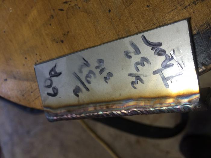

I did find some scraps in the garage. Ran at 60 amps no pulse.
1/8 in 316 SS
1/8 in 316 SS
3/32 thoriated 3/32 316 filler

Josh looks good, you weld that in the orientation it was sitting for those pics? If so, rotate 45° so the top plate is parallel to the ground and try it again...see if you notice a difference.

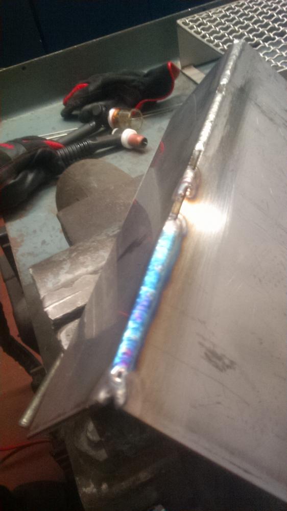

Thanks again. I had one more piece to do on Monday, so I tried laying a 3/32 filler in the joint and pulsing over it.
It went okay, but I never really figure it out. I took a picture, but it isn't a thing of beauty. The center of the photo is what I ended up feeling most comfortable with, 1.5pps, and higher amps. I'll have to work on it.
And I've been using a #8 cup, the biggest available to me.
I asked my supervisor about a gas lens, and he dug an old one out of his tool box...but he doesn't have a cup for it. It hasn't been used in many years. But he seemed to think it would be a good idea to order one from our supply company, so with any luck...
I'll make sure I get one, even if I have to buy it myself. Atleast that way I eliminate the possibility of poor gas coverage.
Are you doing a little weave with the torch? And did you weld it in the position you photographed it in?
The weave was very small. No more than I needed to to get an even tie in. It was welded with one side vertical and one side horizontal.
I tried the same thing but with 1/8 filler. Same setup but I had to up the amps. I tried it at 65- 70- and 80 amps. It came out ok but I had to brush it to get it shiny. The 3/32 one was a pic as is after the weld with no cleanup. On the 1/8 I had to run fast. Im a bit rusty on my flat work so it didn't come out as nice. most everything I do is pipe.
