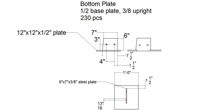

I’ve got a pretty big project coming up, consists of welding 5 inch c channel to a 3/8 mounting plate, 12” x 12”, which will be bolted to concrete wall. 250 pieces. Plus, another 250 pieces on the other end, but that one is a T joint, 1/2” base plate, 12x22, with a 3/8, 7 inch tall plate welded perpendicular. So a lot of pretty heavy stuff.
My question is, would you guys recommend using dual shield flux core or solid wire? I’m no professional welder by any standards just a lot of practice making stuff on the farm. I’ve never ever used anything except 0.35 solid wire. But flux core is apparently faster and penetrates better? Since it it structural stuff, and a lot of it that sounds like what I want. And that’s only half the project there’s also some angle to c channel welding etc
I could attach some drawings to clarify later, I don’t have them on my phone.

so its basically a stud wall inside the shed, since potatoes cannot be stored against an outside wall, due to condensation, cold etc. there's an airway between the outside wall and the inside wall that feeds air into the the ducts that run under the floor, pushing air up through the potatoes.
basically, a 8 inch c channel stud wall, 5 inch c channel horizontal piece, and 5 feet of 2 inch angle, overlapped 12 inches onto the stud, running up to the top. 3/4 inch bolts at the bottom, and 2 more joining the 2 channels.
i did try to cover my butt a bit, and make it easier, im getting all the plates laser cut, and the top plate which gets bolted to the outside wall, i had them cut out the profile of the 5 inch c channel that runs horizontal, so the weld will not carry the brunt of the weight, the channel will be inset in the plate.
and the bottom T plate i had a tongue added to the upright, and a grove cut into the baseplate. so no marking and squaring, simply put together and weld.
Also the bottom plate will be wet set into a 2 foot high concrete pony wall, so each plate will need 4 3/4 inch studs on the bottom. which comes to 920 studs. Im renting a stud welder for that, kinda excited about that![Very Happy :D](./images/smilies/icon_e_biggrin.gif)

The engineer at first spec’d 8 inch c channel from top to bottom and the horizontal piece. 5,430 linear feet :/:/ talk about overkill.

Have you ever been up close & personal with a stud gun?
My Nelson book shows a maximum of 5/8 although someone may sell 3/4.
Have you run a cost comparison between stud welding -v- piercing the bedplates and welding in rebar pieces?

No, never. OrIginal plan was to get holes cut in the plate, run a rebar piece through it, sticking out just enough to weld around it on both sides of the plate. But the foreman ran across a Nelson stud welder vid on YouTube and started phone around, found they’re relatively cheap to rent (couple hundred bucks) and it’s a lot faster. The studs are $2 apiece for a 3/4 by 6 inch. And with over 900, I can do it in a day with the stud welder I’d assume.Franz© wrote:Have you ever been up close & personal with a stud gun?

$250 will get you a Nelson gun and power unit for 2 or 3 days from the rental places and you can figure on about 2-3 minutes a stud with the arc type which you'll need to use. CD studs don't come in 3/4 diameter. Fact isI'm not real sure Nelson makes bigger than 5/8 x 4. That size, I'd figure getting 20 an hour would be good production, and the gun will get damn hot.
Honestly, a pierced rebar would have more hold, and you'd only need to weld 1 side if you pierced with a Whitney Punch or an ironworker if tyou have 1 with the capacity.
From what I see on your print, a 6" piece of weldable grade rebar welded to the bottom of the plate without piercing would give you the same strength a Nelson concrete anchor will. Seems like it would be a lot cheaper too.
Regarding the amps, wait till you hear that sumbeach fire off. I strongly suggest good ear protection. Also hope you have real good power to the machine, unless you're renting a generator machine. You'll probably be standing on the bench running it so form up some foot protection from aluminum flashing and a couple boards to stand on.
