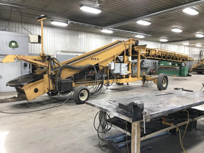

Big machine is a dirt eliminator, has a bed of spinning rubber rollers that separate the loose dirt and small clods, the spacing between the rollers is hydraulic lay adjustable. After the rollers there would be 8 ppl picking out whatever clods and vines the machine didn’t get.Franz© wrote:You got pictures of them tater harvesting & cleanup toys? Post em up. We have major onion growing about 50 miles SW of me, black muck ground that can and will swallow a road trailer, but everything there leaves in bulk boxes to be seen next in grocery stores. Never got to see much tater or onion processing.
Nelson has taken over building their own power supply and claims it's better because it's of course DIGITAL metered and contains PC firestarters, and all kinds of dials. In my world that translates to We'll RENT it and let you own the problems. It don't run, we don't pay. We also don't pay if somebody has to spend half the day on the phone listening to "try adjusting".
The other yellow conveyor is used to pile in the sheds, and to fill trucks when emptying the shed. Has a telescopic boom, swings right and left, and is remote controlled.

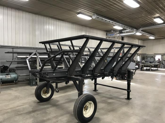

The unpainted little wagon is my latest project. Kinda proud of it actually designed, drew, and made it all myself. Simple really, the sheds are emptied with a skid steer and big snow bucket. Dump into the wagon with the skid steer, wagon feeds the piler mentioned above, straight into the truck.

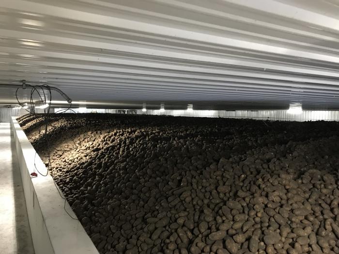

Other pics are one of the shed we just started emptying. Holds 80,000 bags of spuds; 8 million pounds. Kinda gives you a tiny idea of the insane amount of fries McDonald’s puts through. Tho not all go to McD, only the best of the best potatoes actually. Anything less than the best goes to Costco and such.

Looks like the old ground driven tater picker upper grew and somebody figured out rollers do a batter job than that bar grate chain.
Stacker looks like it got hauled in from a coal mine and put to work..
Your little wagon looks like you borrowed some ideas from a boll buggy on a cotton farm. At least taters ain't likely to catch fire.
