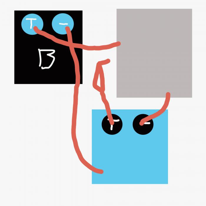

So, I finally got it to come on. But, it didn't work that well. It kind of spattered. I read someone telling someone else, to change the connection and hook the ground to the positive. I mean, the electrode part. I am so worn out today. I wrote those down and drew this picture. No clue if it is correct. haha But, my tired self wrote it down.
Power to negative, then power through positive, given power from the negative from which the second negative is connected. Then, since the gun wire was coming from the second positive, once the second positive connected to something that was powered by the first positive, it would be active. The Suitcase would be negative. The electricity would come through the Bobcat, into the metal and through the gun wire.
- Mig-setup.jpg (26.33 KiB) Viewed 4014 times
From reading that description you should just buy a hot glue gun.Glowzinski wrote:So, I finally got it to come on. But, it didn't work that well. It kind of spattered. I read someone telling someone else, to change the connection and hook the ground to the positive. I mean, the electrode part. I am so worn out today. I wrote those down and drew this picture. No clue if it is correct. haha But, my tired self wrote it down.
Seriously - your bobcat has wire+ and wire- selectable at the machine.
"it kind of spattered" just means you're doing it wrong.
Poleframer
- Poleframer
K, you have some information mixed up. On older machines, like mine, you swap leads at the machine terminals to change polarity. On your bobcat you dont do that.
Always connect the work lead to the piece of metal you are welding. The post labeled electrode goes to your stinger if you are stick welding, or to the lead on the suitcase.
Now to change polarity you set the switch on the bobcat to + for DCEP, or - for DCEN.
Tho you didnt say, I gather you were trying to weld with flux core (gassless), not hard wire, or dual shield and you were reversing the DCEN (if you were - on the bobcat switch) to DCEP by switching the leads.
The small clamp from the front of the suitcase also always goes on the workpiece, regardless of the other cables.
