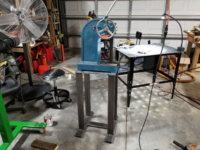

I'm building an arbor press stand. I got myself a Klutch fixturing table and a couple of Fireball Tool squares, and I've been using them while welding the parts together. The new tools are very helpful for locating things and holding them in place, but it looks like welding things while they're clamped does not prevent warpage. Maybe it reduces warpage, but I find that things still bend. For example, I welded two 31" legs on my stand, and where they join the top, they're 9-5/8" apart. When I was finished welding them to the top, the other ends were 1/4" closer. I had to make a piece of wood 9-5/8" long, drive it between the legs to spread them, and leave it there while I welded other parts to the legs.
The stand I'm working on is sort of a steel box. The top is a piece of plate, there are four legs coming down from it, and there will be a base made from rectangular tubing. I've been clamping one part in place at a time, welding it, and then moving on to the next part.
Would warpage be reduced if, instead of doing one part at a time, I tacked the whole thing together and then finished the welds? I'm thinking that a box which is tacked together so it's square will tend to hold itself square as the tacks are enlarged.

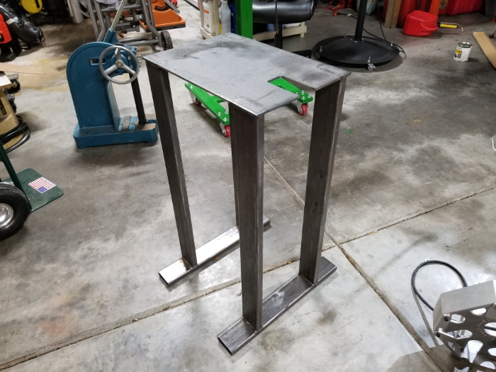

I had a very interesting time trying to bend the arbor press stand back into shape.
I found several problems with it. First, the front legs were warped toward each other, and so were the back. Second, the front set of legs was warped toward the rear set. Third, the front and rear sets were not parallel from side to side. They were opening like scissors.
I cut a piece of wood to the appropriate size to force the front set and rear set apart so they didn't point inward. I jammed another piece of wood between the front pair and rear pair. Then I had to clamp a couple of the legs together, because forcing them apart to the right distance at one point made them too far apart at another point.
I tacked the lower crossmember in place, joining it to one set of legs, and then I used a wood clamp to pull the other set of legs up to where it would also be centered on the crossmember. I had to move things about 3/8". Then I tacked it in, took all the clamps off, and finished the joints before the tacks could explode.
The stand appears to be less than an eighth of an inch out of flat now, so I don't think it would have come out much better had I done it CORRECTLY. I'm not positive about everything yet, but it looks good, and surprisingly, the top is flat.
There is a considerable amount of stress welded into the stand. Anyone who tries to cut it apart is going to get a surprise.
The remaining parts that have to be attached shouldn't cause any issues.
Next time I do something like this, I'll try to put as much of it together as possible before tacking it.

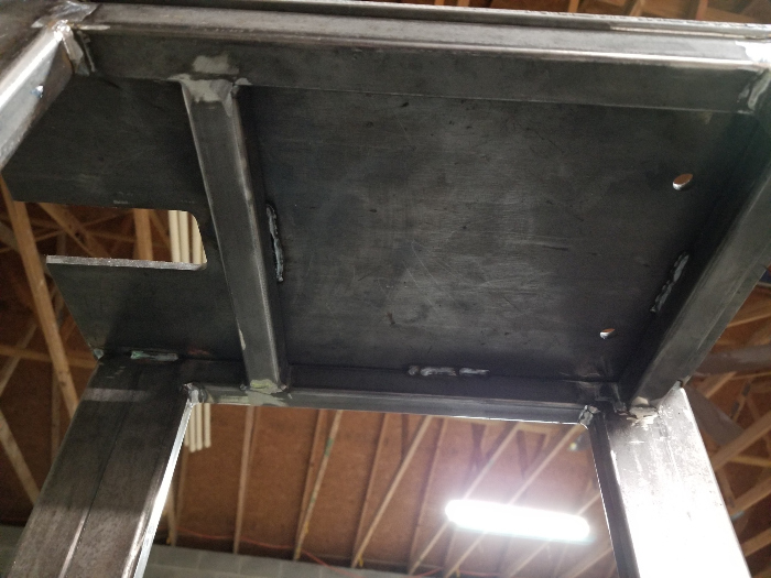

I ended up cutting the top off this thing, leveling the uprights very precisely, welding some supports under the top, and putting the top back on using SHORT welds. I wrote about it in another thread.
I ran beads across the bottom tubes to pull them straight, and then I ground the beads off. Three of the four tubes are now straight. The fourth one didn't quite straighten, but I can always shoot another bead onto it.
- 01 16 20 arbor press stand after disassembly and new welding underside small.jpg (207.71 KiB) Viewed 4042 times
