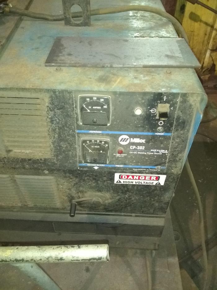

That is a good welder for work.
You can rebuild that welder for ever even rewind the transformer.

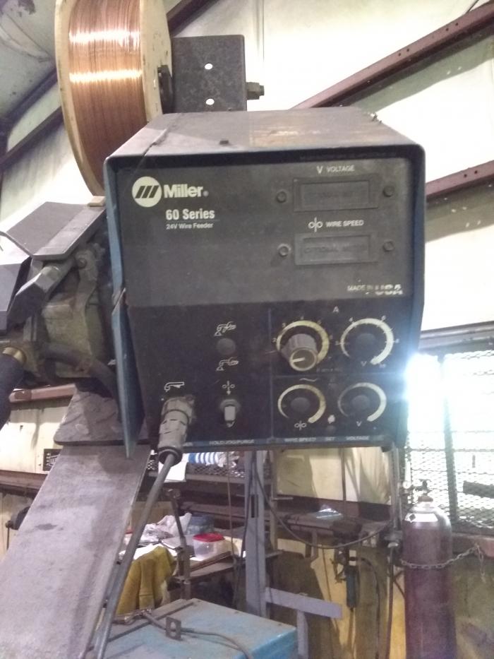

Gun positioning is the main factor. Got to keep the tip close. 10 degrees off the work. I have an hour worth of breaks a day to practice. In our fab shop we have about 10 hoists/cranes we can manipulate the work into the flat/horizontal position if the vertical weld is critical enough. If not I'm used to multi passing vertical down. No more I will conquer vertical up ! Lol have a good day.
Havoc0122
    Sat Jun 27, 2020 7:17 am

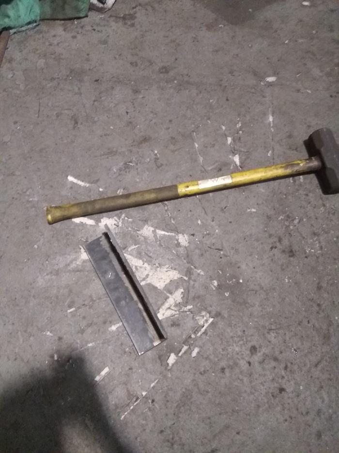

Attempt number 1: my best vertical up bead yet. Passed sledge hammer test. 19 volts 200 IPM. I'm close. Those are 3 seperate beads starting from the bottom. First one is 17 volts 180 ipm. Second 18 volts 190 ipm. Next break I'll adjust. What do you recommend?
    Thu Dec 26, 2013 12:41 am
    Laredo, Tx
Havoc0122 wrote: There's a wheel missing from the wire feeder. Could that be the issue there?
If there was anything missing from my wire feeder I'd be worried.

160IPM on 0.045" solid wire is roughly 160A of welding current. Seems like very little for 0.387" thick plate. Let me load up my machine with 035 wire and use that same amperage (but obviously higher WFS) to see if that's what I like. I have a feeling it will be more than that.
Havoc0122 wrote: Gun positioning is the main factor. Got to keep the tip close.
Take your nozzle, and a grinder with a thin 045 cutting wheel, and slice off whatever you need to get the tip either flush or protruding 1/8" max if it helps. Flush might be a better idea though. Also, it helps to use a narrow conical nozzle.
Those pictures look like two different attempts. Sometimes it helps to take your soapstone and write down on the plate next to each bead what settings you used.

So I attempted a few times earlier. Still getting the droop. Tried 20v 200 IPM give and take a few. Here are some pics, looks the same. I'm going to be practicing every day now. I have a few practice pieces made up for tomorrow.my internet sucks the shops not close to cell towers. Sorry for the delay. I'm not sure I might be going too fast. I'm manipulating the pool and trying to build shelves from left to right. I end up doing more of a V than triangle. I could see how that might make the sag and lack of fill along the edges. Just gonna keep practicing. Oscar if you recreated my scenario to help it wouldn't be a waste of time it's hard to ask for help but here I am. Anyway thanks.
    Laredo, Tx
Yup, I'm on it, I'm just making some space in the garage since my 3" flat bar is buried at the bottom of my steel rack.
Things have gotten a lot more cluttered since I took that pic. :D
At first glance, I dunno if it is just the perspective from looking at it from a picture on my screen, but the bead looks very narrow, so it might account for some droop with all the heat concentrated right in the corner. I'll see in a little bit.
