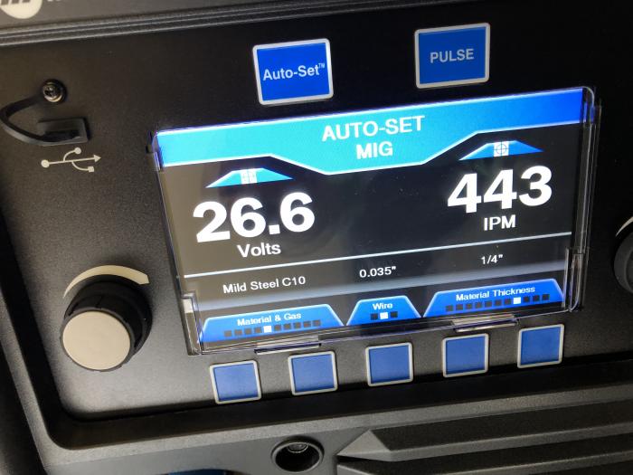

Millermatic 255 settings

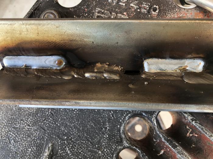

This one ran in kind of weird. It was almost silent, with a cone shaped arc focusing back to the wire. And what's with all the soot? Is that a byproduct of running 90-10?
Millermatic 255 1-4.jpg (71.27 KiB) Viewed 5249 times
FootSoldier
    Sat Feb 13, 2021 5:11 pm
    Scottsdale, AZ
https://www.google.com/search?q=spray+a ... TO6afgBw25
This is very close to what I was seeing and hearing on the two beads above. I know the machine is not capable of spray arc transfer, but that's sure close to what I was seeing.

FootSoldier wrote:https://www.google.com/search?q=spray+a ... TO6afgBw25
The machine IS capable of spray transfer. "Pulse MIG" is really short-hand for "pulsed spray arc MIG". If it couldn't do spray-arc, it would not be able to do "pulse", if that makes sense. :)
Welds looking good. The soot is because you likely have a very small diameter nozzle and couple with the fact that pulse MIG needs about 3/4" stickout and the arc cone is much wider than short-circuit transfer, you likely don't have enough shielding gas coverage. Post up a pic of the nozzle you are using, and how much CFH were you using on those beads?
FootSoldier
    Scottsdale, AZ
That's what I don't understand, the machine was not set to run pulse spray when I ran those smooth looking welds, but they sure sounded and looked like spray.
I am running the Miller 250MDX gun, 5/8" bore on the nozzle, with the contact tip recessed 1/8", and 25CFH 90-10.

Oh ok, my bad, I had thought that was also in the pulse program. Yea the voltage is high enough that the transfer method crosses the globular threshold, together with the amperage. It's not quite true axial spray transfer because the droplet size isn't small enough, but none the less it does happen to me as well where it "seems" to go into spray because it turns rather silent and you don't have the typical short-circuit buzzing. Try a 3/4" nozzle with 40-45 CFH and you might see the soot start to decrease a bit. I've gotten that as well.
    Wed Jan 22, 2014 12:00 am
    Connecticut
You don't need to be in a pulse program to go into spray arc transfer. You only need a suitable gas mix (which you have) and enough voltage (26.6 should be more than enough for 0.035 wire). So I believe you were just in spray mode (not pulsed spray arc)

Louie1961 wrote:You don't need to be in a pulse program to go into spray arc transfer. You only need a suitable gas mix (which you have) and enough voltage (26.6 should be more than enough for 0.035 wire). So I believe you were just in spray mode (not pulsed spray arc)
This is exactly what I did not understand. I hooked up a bottle of C25 to the machine and ran the same weld settings (other than gas selection) and it was in short-circuit arc mode with full bacon frying sound of operation. Go back to C10 gas, then I was in spray arc mode. I've never seen anything like this, other than in videos before.
Spray arc is more like welding with a ray gun! LOL! Now I have to cut and etch a sample to see what the penetration looks like? While running the weld, my impression is that I can't be getting penetration. It flows in so well with the edges so wetted in.
I think what I am learning about the machine is that, if I want to get enough heat to weld 1/4" and above, out of position, then I need to run C25 or C100 gas...or just run the machine in pulse mode program? Would I be wrong in believing that on heavier stuff, out of position welds would have better penetration on pulse mode operation anyway?
BugHunter
    Sun Apr 19, 2020 12:54 pm
FootSoldier wrote:This is exactly what I did not understand. I hooked up a bottle of C25 to the machine and ran the same weld settings (other than gas selection) and it was in short-circuit arc mode with full bacon frying sound of operation. Go back to C10 gas, then I was in spray arc mode. I've never seen anything like this, other than in videos before.
The gas is what determines if the arc can be sustained without shorting out the wire. Wrong gas, it won't arc, it'll be short circuit. Well, not at any proper settings anyway.
I think you'll find it's more, not less penetration.
When you run in spray mode, the puddle becomes so fluid that out of positions stuff won't work. The puddle just runs or drips. That's why they do it in pulse, is to create spray mode, but give the puddle time to cool so it's more viscous. In most situations you get more penetration in spray. And yes, to do anything but flat / horizontal, you need to run in pulse mode.
I think you have multiple options with that machine. With my 252, I could run C25 or C100 and make enough heat to weld up to 1/2 inch according to the door chart. I tried it and it works, but I really don't trust short arc much for thick stuff. I would always default to gas shielded flux core. Its a lot like spray arc welding (but not exactly), runs REALLY hot with awesome penetration, and it runs out of position very well because of the slag. With your machine, you could do short art, pulsed spray arc, gas shielded flux core, or even pulsed metal core wire out of position. You could also do gassless flux core, depending on how much ductility you want in the weld. Gasless is good, but just not quite as good as the gas shielded stuff, in my opinion. The gas shielded stuff is charpy v-notch rated (like a 7018 rod) while the gasless flux core is generally not charpy v-notch rated.

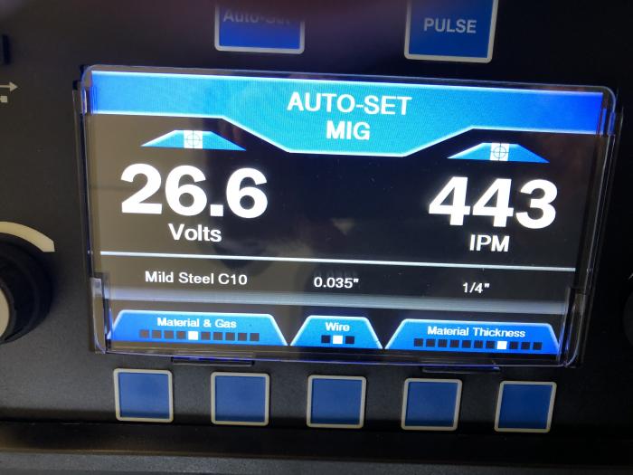

I am one happy camper with the new Millermatic 255. It's easily the most capable machine I have ever run. Spray arc is a hotter than heck, zero splatter, blazing hoot to run!
Millermatic 255 1-4 Flat Setting.jpg (47.5 KiB) Viewed 5200 times
Two passes flat on 1/4" mild steel with 30CFH C10. I know it's old hat for most of you, but this is like Disneyland for me! :D
