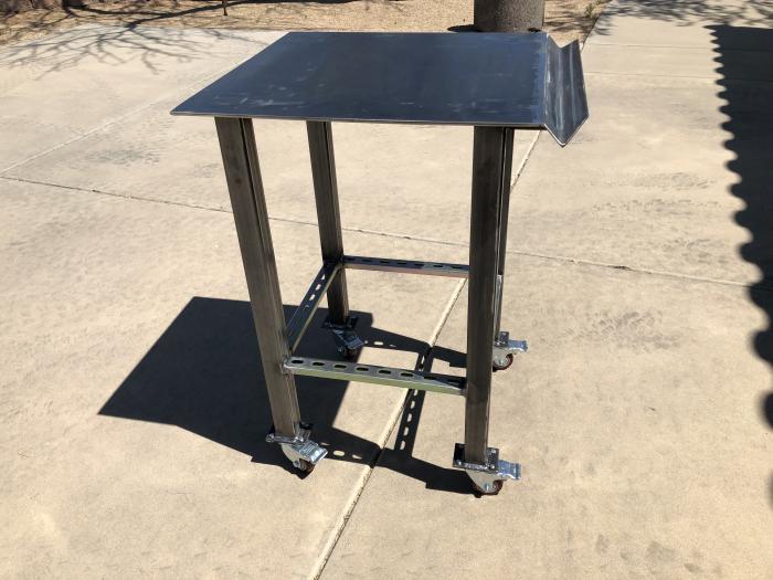

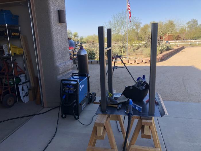

Ok, it's fair to say I love my new Millermatic 255. Yes, there was some drama getting to this point, but that's all water under the bridge now. This thing runs great and I couldn't be happier that I stepped up to get spray capability. Clean, with zero splatter and easy clean up. There will be a learning curve, but it will be a hoot. Thanks to everyone here who tried to help or teach me, I really do appreciate it.
Built my first project with it today. A 24x24x.250 semi-portable welding table. It may not be as pretty, or as portable as the blue one, but it didn't cost $400 either.
