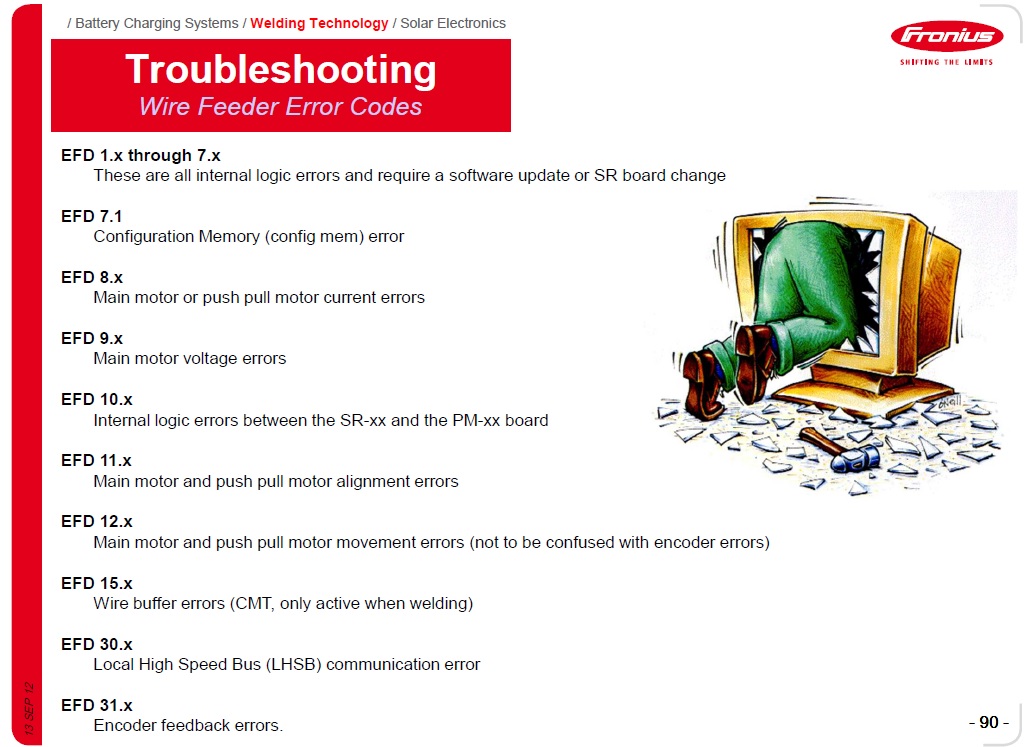

Evidently, there should be an error number.
- Error Codes.jpg (187.53 KiB) Viewed 11070 times

Those I posted are from the "Operations Manual". There are other error codes as well, these are just the EFD (wire feed) error codes.
