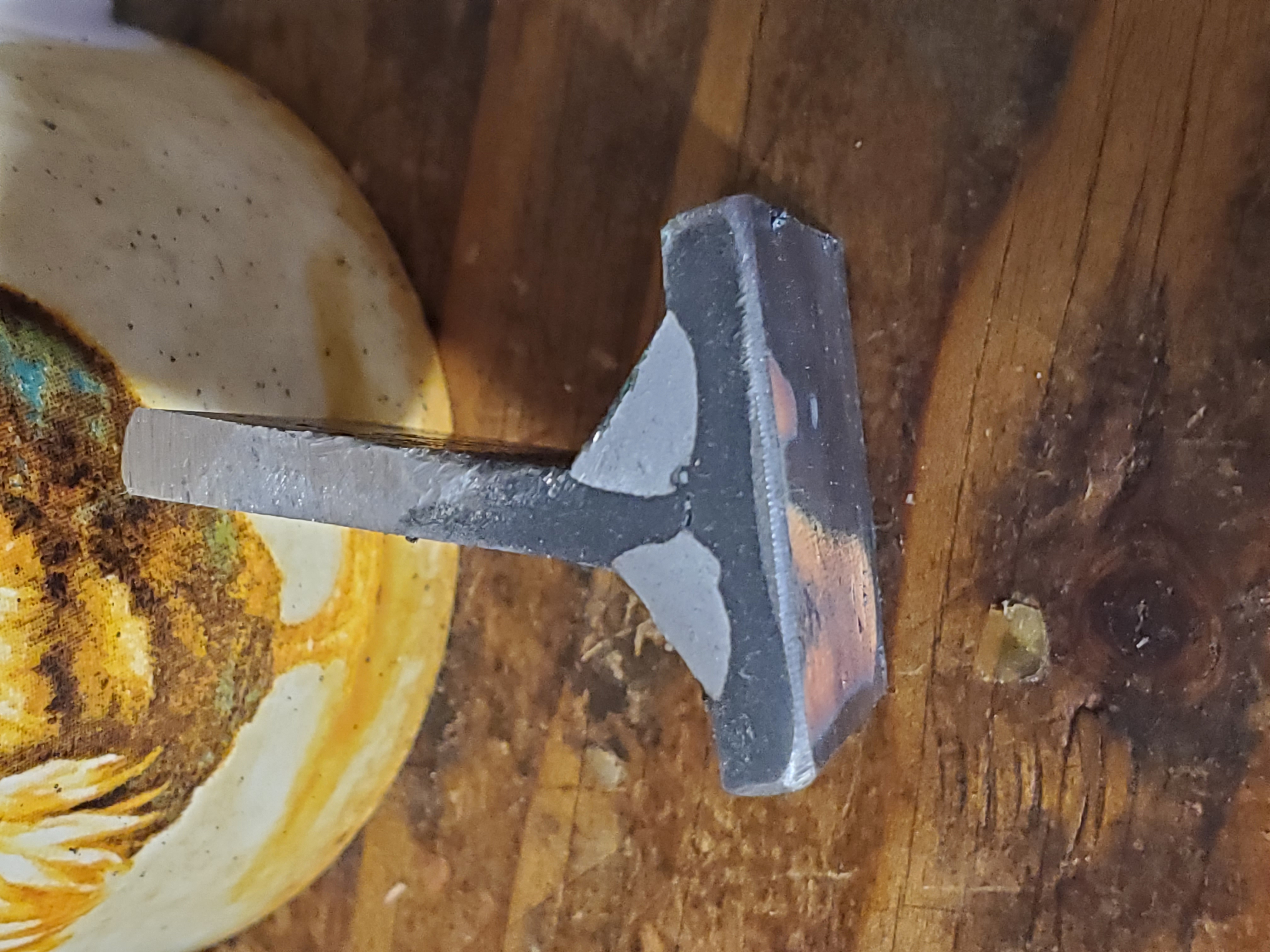

I see that Nital is used by many people to check welding penetration--In my area Nital is hard to get or find--I found that phosphoric acid works very well and is available at amazon cheap
