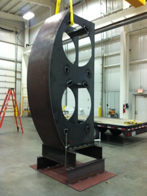

These are test stands for a machine we have been prototyping for the past 5 years. 30" pipe will go through the holes on rollers. These are just elaborate roller stands similar and smaller to ones to be used in the final application. Each weighs 3300lbs, stands 12'-3" tall and is a royal pain in the rear to flip for welding!
- test roller 2.JPG (85.55 KiB) Viewed 17846 times
- test roller.JPG (81.76 KiB) Viewed 17846 times

Superiorwelding, Are your edges radiused where the strap goes through it? A somewhat sharp edge could slice right into that strap. Straps give no warning before they fail. Had a splice place on a tub girder bridge come crashing down a few months back because the strap rubbed the plate on the upper flange and cut it. Thankfully no injuries to my guys that were installing it but it can happen. I've only been back on the floor for 2 weeks this year and on restrictions still due to a piece of c-channel breaking several bones in my foot. With 3300 pounds on tap it has the potential to be a widowmaker and the insurance guys and OSHA dicks wouldn't be nice to your boss for that.
Just something to look at. I would rather read future posts from you than an obituary and we all know in this industry the only things that can't kill you can still maim the hell out of you. Perhaps some old carpet remnants to cushion where the strap contacts the edges might be in order. Cheap to have, easy to use. We lift completed bridge sections that weight 190,000 pounds with straps and have carpet chunks around for edge protectors on every lift. Works great. Never been an incident.
Nice job on the fab work. I really need to get a camera. Just finishing a big job for Green Bay and this summer have an arch bridge for Kentucky. Some rather boring plate girders to fill in the time for Ohio DOT but for those of you that have never seen SAW done I'd like to get some video. Imagine never seeing the arc and welding without a welding hood on. Its a weird thing.
nickwarner,
First I will say that I appreciate your concern on my, as well as others safety! Yes all corners are radiused and put in a position where they would have the least amount of strain. These straps were also brand new. Also know that when a cover on our straps is cut or burned/melted in any way, it goes in the trash. We take safety very seriously! I want to be around for many more years as well.
Get some pictures up if you are allowed, would like to see some of your work. Thanks again.
Very cool, brings back memories of big lifts when I was on the rail. I always liked to put something between the straps and its contact points also. Only takes an extra second and provides some extra piece of mind.

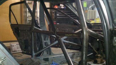

Edited to add: any close ups on the cage?
Wes917 wrote: Edited to add: any close ups on the cage?
This is all I have on this computer. I have to find the flash drive with everything else on it.

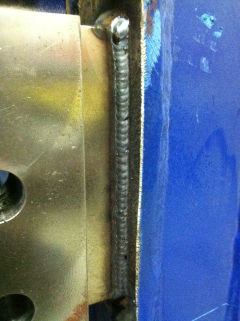

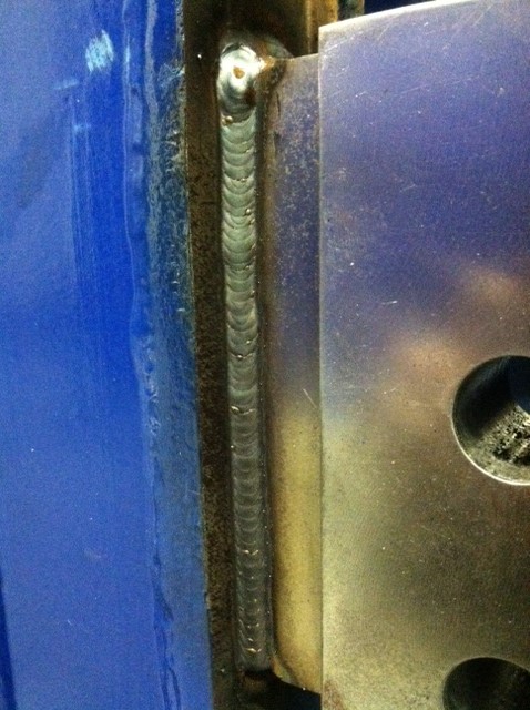

I did some vertical up roots for a bracket the other day. It came out good except for the top where I didn't grind down the tacks before welding. Anyway thought I would share this with everyone. These were done on a 350MP using .045 wire and I think 160ipm and .94 trim.

Hey nothing wrong with those welds. Look pretty dam good to me. I hope that I can pop things out looking that good once I get my mig up and running.

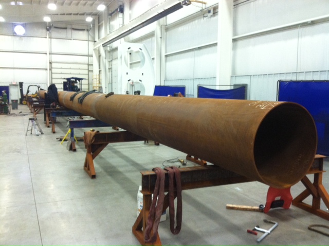

We have been working on this 30" pipe for testing purposes. There is 211'-6" sitting here with more to come. Once testing is done, this pipe will either be sent back or scrapped.

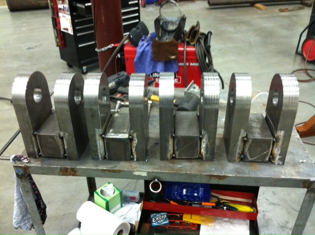

Well I didn't get to finish these, I tacked them together and someone else came and took them to weld, but thought I would throw them up anyway. The center block on each is 6"x3.5"x4". These are all 1018 CR.
- tie bar ends 2.JPG (135.6 KiB) Viewed 14113 times
- tie bar ends.JPG (132.53 KiB) Viewed 14113 times
Cricket,Cricket wrote:Do you preheat massive pieces like those or rely on "softness" of 1018? I am just qurious as I might have a similar project to weld soon.
Sorry for the delay in response. Yes we did pre-heat and post-heat these to 200*F. We only did this so there would be no chance of cracking and to allow a even cool down, eliminating stress points. 1018 does not normally need heated before weld, but we have found it best to take the chill out of very thick parts like this. Also the 1018 was chosen for the machining and strength.
As for the "softness" 1018 it actually has a higher tensile and yield strength than A36 and is less ductile.

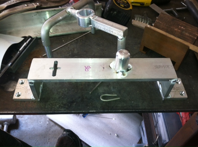

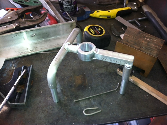

Well I TIG welded these and didn't get a picture of the final product, but thought I would share a example of a proof of concept that I did for a local company. Can't tell you what it is (don't think you would guess it in a million years) but it is here for your looking.
- proof of concept 2.JPG (118.71 KiB) Viewed 14033 times
- proof of concept.JPG (131.12 KiB) Viewed 14033 times
