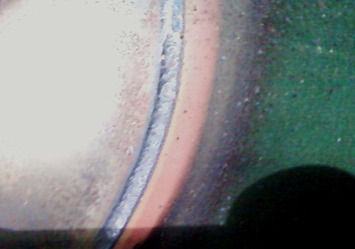

RMD root, pulse fill and cap
- 8sch80inside.jpg (28.06 KiB) Viewed 2109 times
- 8sch80cap.jpg (122.86 KiB) Viewed 2109 times
- 8sch80fill.jpg (39.87 KiB) Viewed 2109 times
- 8sch80root.jpg (10.03 KiB) Viewed 2109 times
That's interesting, our Miller rep told me we should use 75/25 or straight CO2 for RMD. I have not had a lot of time to mess with the Pipeworx but I did run a 2g 60 deg included angle with a feather edge and a 3/32" root opening. I finished the entire joint with RMD and it bent just fine. Root passes with RMD and CO2 are really easy, I had a student watch me and who had never run bevel, he tried it and his root was pretty good, never blew it out once. If i'm not mistaken we were running about 17V, don't recall the wfs.hardhatdiver wrote:C10
Looks great, what setting and joint prep were you using?

C10 for rmd root and pulse. One gas is all you need. You can run rmd with c25 but then you can't run pulse. Gave myself a 1/6 land and 5/32 gap. After tacks its a 1/8 opening. Once you start using c10 for your pipe welding you'll stay away from c25. Much cleaner.
Thanks for the tip I'll give it a try.hardhatdiver wrote:C10 for rmd root and pulse. One gas is all you need. You can run rmd with c25 but then you can't run pulse. Gave myself a 1/6 land and 5/32 gap. After tacks its a 1/8 opening. Once you start using c10 for your pipe welding you'll stay away from c25. Much cleaner.

Straight from Miller, did you read this somewhere? Not trying to be argumentative I appreciate the information, just curious. Since you can change the gas type on the front panel https://www.millerwelds.com/pdf/spec_sheets/PWS2-0.pdf and they list different gases for RMD I would assume there are different internal settings for the different gases. Maybe Miller feels 90/10 gives the best results?hardhatdiver wrote:Straight from Miller when they set-up the perimeters for the pipeworx machine they used c10.
Check out this etch, kinda scary when you look at the penetration on the right side at the top of the weld.
hardhatdiver
- hardhatdiver
Joined:Thu Oct 30, 2014 7:56 pm
