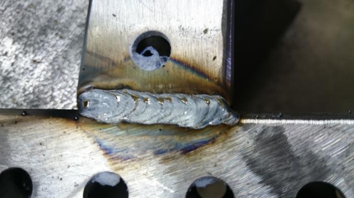

I'm new to welding and have only played with a little cheapinese flux machine, but now I'm a proud new owner of a Hobart 210 MVP and hoping to hear some advice on these first welds.
- 3.JPG (34.21 KiB) Viewed 3646 times
- 2.JPG (37.34 KiB) Viewed 3646 times
- 1.JPG (39.63 KiB) Viewed 3646 times

My only constructive comment is to either double tap the trigger or back into the crater to fill it when you stop to make the crater the same size as the rest of your weld.
- 2.JPG (70.32 KiB) Viewed 3636 times
John Wright
I would say "only comment" because there is nothing wrong with those, aside from the crater that has been mentioned.

Am I stopping too early? (hence the crater)
Thanks for the advice.
"We can't solve problems by using the same kind of thinking we used when we created them."
No. It's in the nature of MIG welds.Onekeyskunk wrote:Am I stopping too early? (hence the crater)
When you stop, pause for half a second, then squeeze the trigger for half a second.
The pause is that brief because you want the metal to still be hot. The extra squeeze is to fill the shrinkage than always happens when you stop MIG welding.
It's called "buttoning off" a weld.
I saw NOTHING else wrong with those welds. Well done!

Those are good welds. If you want an extra critique, I believe you are in fact stopping the actual weld short. Everyone is correct with the assessment of filling in your crater but I can see the gap at the end that you should have filled in by continuing a little further. Keep up the great work!

I assume this is not melting the tack?jwright650 wrote:One more vote for tacking on the flats vs corners.
My thought for saying that is this:
If by chance that you don't melt the tack on the corner when you weld the joint out, you have a place where lack of fusion or possibly a crater crack could result in a weld failure.
- uploadfromtaptalk1424885980708.JPG (36.46 KiB) Viewed 4755 times

You wont melt through a tack like that, it's quite thick. But that's quite acceptable for ordinary work, even some code stuff. As you can see, the weld has melted right into the ends of the tack with no holes. Because it's almost impossible to "burn through " a tack most people grind out, or at least grind down tacks as they are going, as the joint is welded enough to support itself.

I agree with Mike...however after placing one weld you can stop short of the tack, grind the tack thin, and also the crater where you stopped, start welding in the crater, and go backwards briefly, just as the puddle forms, and then progress in the regular travel direction, run right over the tack to complete the weld around to the next face of the tubing and rinse & repeat. You have to have your machine set very well so that it is predictable and you know exactly what you are going to get when you squeeze the trigger for this to work. "Feathering" tacks and stops/starts are good fabrication practices to get in the habit of. A few people here in the forum are pretty good and you have to really study the weld to find the stop and starts
Feathering helps one weld tie in to the next and can even blend the welds to look like it was one continuous weld.
