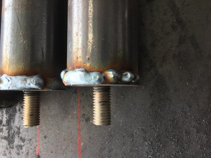

I have been trying to weld an end cap on some 2 1/2" pipe. I tried to do this going uphill. I get these big globs. I've tried turning down my settings and it didn't seem to help. It's 1/4" thick pipe with .030 wire.
- IMG_1804.JPG (52.39 KiB) Viewed 1367 times
- IMG_1801.JPG (70.34 KiB) Viewed 1367 times
The wiring melting will "sag" due to gravity. About the only way to overcome that is to whip across the middle and sweep up, letting the puddle fill in behind you. It still won't be as clean as downhill, but if you must go vertical up, it will help reduce the bulging.
