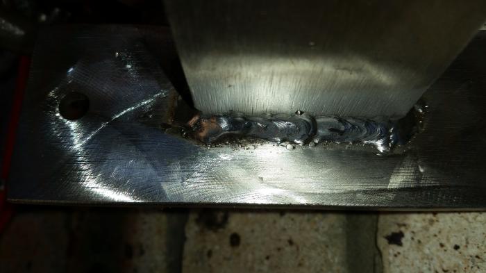

Just wanted to post my experience with using the Ar/CO2/O2 mix with stainless:
1: had to use higher voltage than expected
2: wire is very stiff, so keep your gun lead straight
3: with mild steel can clamp to the bench, but with stainless worked much better with clamp on material!
4: could achieve spray transfer but didn't penetrate well
5: welds were sooty on the outside but clean after brushing
6: ok penetration, steel bent in vice with no weld failure
7: small amounts of spatter after welding: was the stainless coated in something organic or was it the CO2 ???
8: not as pretty as TIG but much faster and easy for repetitive/tricky positions

- 20170327_121117.jpg (32.64 KiB) Viewed 5082 times
My adventures with solid wire ss it that its very finicky with the settings. Sometimes its great, but then sometimes it was horrible. I've seen a guy do the most fantastic looking welds, and then another guy lay pus on the same machine. Mine was one an old pulse machine with auto wire setting so it was a biatch to set.
Mick
Mick
Yeah that about sums it up! The tip about the clamp should be followed though, weld was much smoother when clamped to the work as opposed to my usual clamping on the table; stainless seems to much more finicky about a good clean circuit than steel or ally!weldin mike 27 wrote:My adventures with solid wire ss it that its very finicky with the settings. Sometimes its great, but then sometimes it was horrible. I've seen a guy do the most fantastic looking welds, and then another guy lay pus on the same machine. Mine was one an old pulse machine with auto wire setting so it was a biatch to set.
